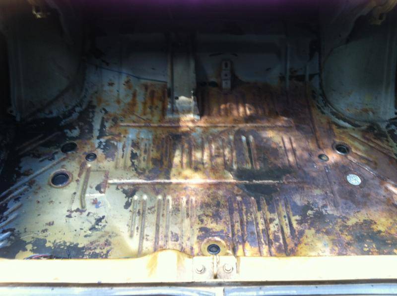

Here is the trunk after I have removed the mat and vacuumed up the dirt and debris

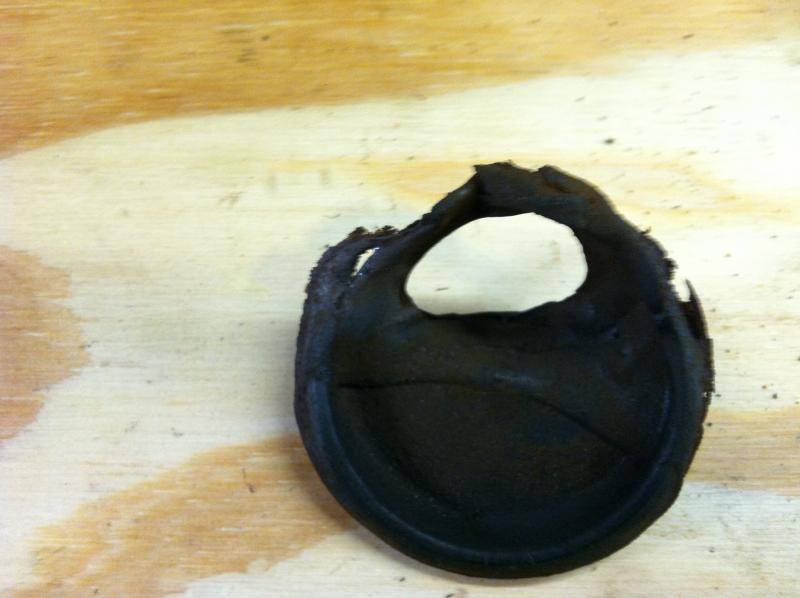

And surprizingly the mat came out in one piece

Jimmy, you should probably ask the seller to be clear you and he are on the same page.
That trunk pan isnt bad at all....... You are in good shape
I was so relieved to see just a bit of surface rust underneath the mat. I had feared the worst. :happy7::happy7:When I first contacted the seller regarding price and availability he originally quoted between $9.95 to $14.95 depending on the sizes and number of plugs required. In my follow up response I had included the reqested information. I figure he will be in contact me within the next 24-48 hours.
