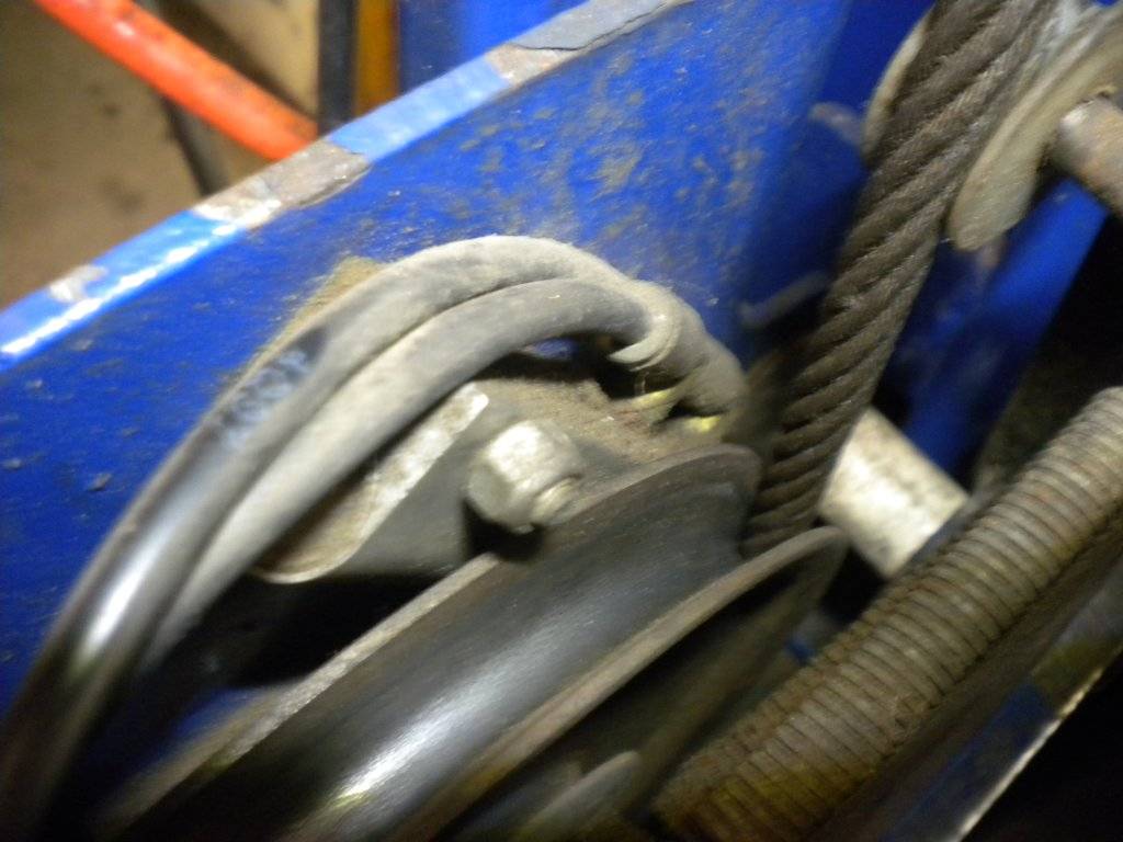

safeties on the rotary are retracted with pneumatic cylinders. some pictures of your lift and what you modified?

if you post a picture it, there's a very high probability that someone here could identify it for you. @Big_John 's lift is mechanical release i believe and a good choice on his part. here's a picture one of the pneumatic cylinders in mine. not much to see: bender 002.JPG
