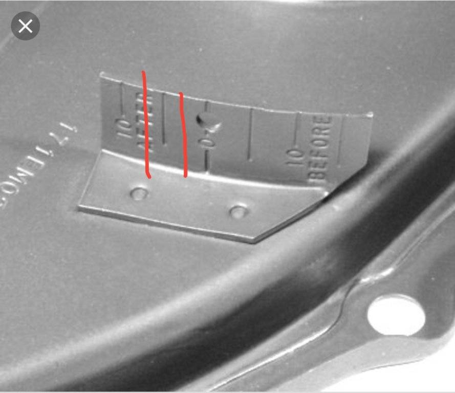

Just so I don't make a big mistake here is a generic pic I found of timing lines similar to mine. The right side red line is about where it was. The left line is about where I am now. I wanna go past that 10 mark further to the left?
Based on your picture, you are saying that the timing is currently set AFTER top dead center (TDC) and if it is now further to the left, your timing change was in the wrong direction.
Top dead center (TDC) is where the ZERO mark is with the hole through it. You want the timing to be set 10 to 12 degrees BEFORE TDC. See the line marked "10 before"? It should be over near that mark.

Just seems weird I would be so out of whack on timing that far. The picture I grabbed above was just an internet pic. If anyone is familiar with the timing lines I went further left. If that's the wrong way I'll check tonight and follow the advice above and report back, along with the voltage testing the company gave me
Well the angle of that picture was taken as if you were standing beside the passenger tire, bending over to look at the front of the engine from behind it. If you are standing in front of the car, the 10 BEFORE mark will be on your left, and the 10 AFTER mark will be on your right. So if you were looking at the timing marks from in front of the car, going more to the left would have been in the correct direction.
