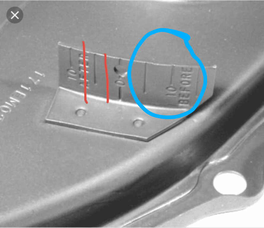

Just so I don't make a big mistake here is a generic pic I found of timing lines similar to mine. The right side red line is about where it was. The left line is about where I am now. I wanna go past that 10 mark further to the left?
That's correct. You could take it out to the end of the timing tab and it would put you at 12, maybe more? If you have pinging when it's that far, bring it back a degree or 2 and check for pinging again. If none, then your done!

For your timing marks, as others have said, you're going the wrong way, turn the distributor Clockwise, and advance the timing to the other side of the marker. Circled in blue.

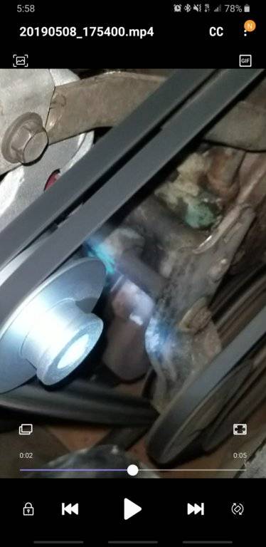

Its raining and about to snow so not gonna take it out yet but did move it to 12 or 13. Pic attached. Can feel the idle go up a touch but think I'll have to check the carb too

I’m darn impressed with the pics of the timing marks. I see how you done it, cool, and helpful for those trying to help you sort this out. I think we’re getting somewhere now!
i may have missed it , but you did remove the vacuum line from the advance and plug it before setting the timing, right?
adjusting the timing will change the idle speed. you will have to adjust it as you go.
