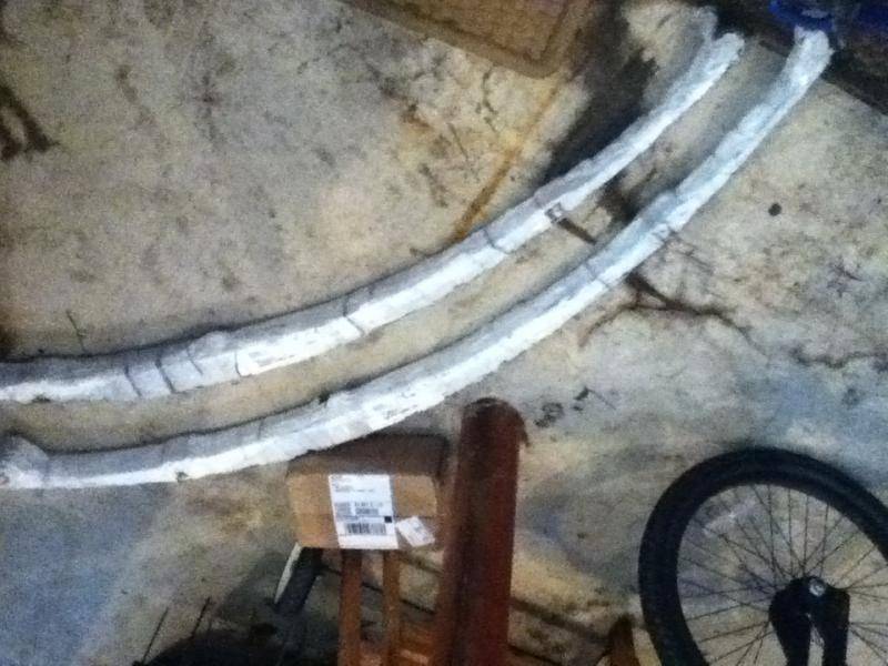

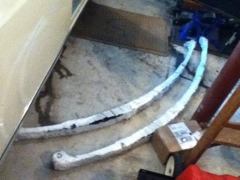

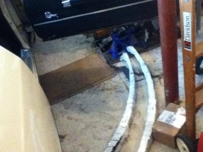

Yeh, I get it. My springs and stuff should be here today or tomorrow. Guess I'll figure it out after that's all done.
