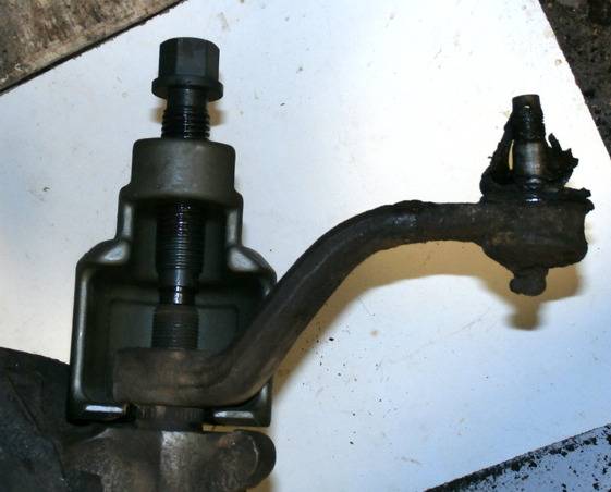

Mar 23, 2024 #1 MoPar~Man Well-Known Member FCBO Gold Member Joined Aug 21, 2022 Messages 903 Reaction score 498 Location Ontario, Canada Unstoppable force: Meets immovable object: Which one will prevail?
Mar 24, 2024 #2 halifaxhops Retired USAF MSGT (SW) yes navy also. FCBO Gold Member Joined Mar 10, 2017 Messages 3,277 Reaction score 1,971 Location HALIFAX PA Hit the base of the arm fast with a BFH! Works!
Mar 24, 2024 #3 Justin Plant Well-Known Member Joined Nov 11, 2021 Messages 638 Reaction score 663 Location Moneta, VA put tension on it with the remover. whack pit man arm with a good size hammer. more tension, more hammer. lather, rinse, repeat. Minutes later (generally) its off
