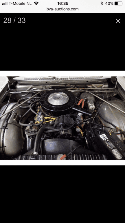

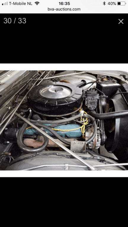

2: the heater hose is re-routed, see photo. Can it be that the heater still works with only 2 out of four connected?

Those two nipples are a valve for the heater, your car is an A/C car. There might have been a leak in the valve and they bypassed it.
Or the heater core is shot.
The coolant flows to the valve, then to the core, which is still hooked up. That's my logic on it. I know there's a thread hiding here somewhere that explains it better.
I don’t think any of those hoses are attached to the engine though.
No, I guess I was saying I think the heater core is fine, as the bypassed the valves inlet and outlet without saying it. Coolant goes from the engine to the nipple on the right, then from the nipple on the left to the heater core, then out and back to the water pump.
If memory serves me correctly, there is a branch fitting inside of the heater box that has two short sections of heater hose hooking things together. Often, the two short hoses are what is leaking. In any case the heater box will have to come out either to fix the hoses or to replace the core, a major pain in the butt job. Before doing that I would suggest pressure testing the unit to see if it will hold without leaking.
