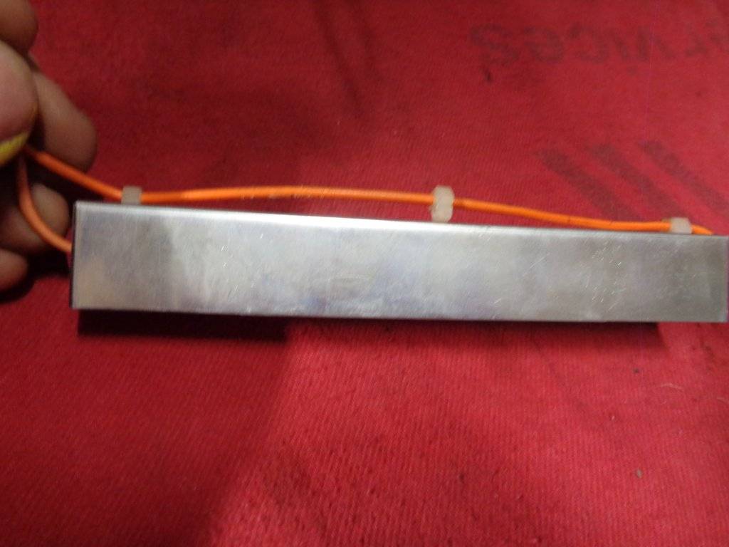

@Trace 300 Hurst for your viewing pleasure one very bloated muffler.
Yep, that's what I saw that evening. Gotta love that fold back at the rearward 25%. Must have been a little "pop" that did that.

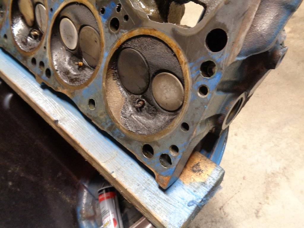

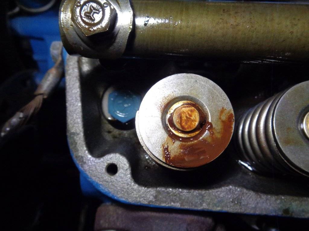

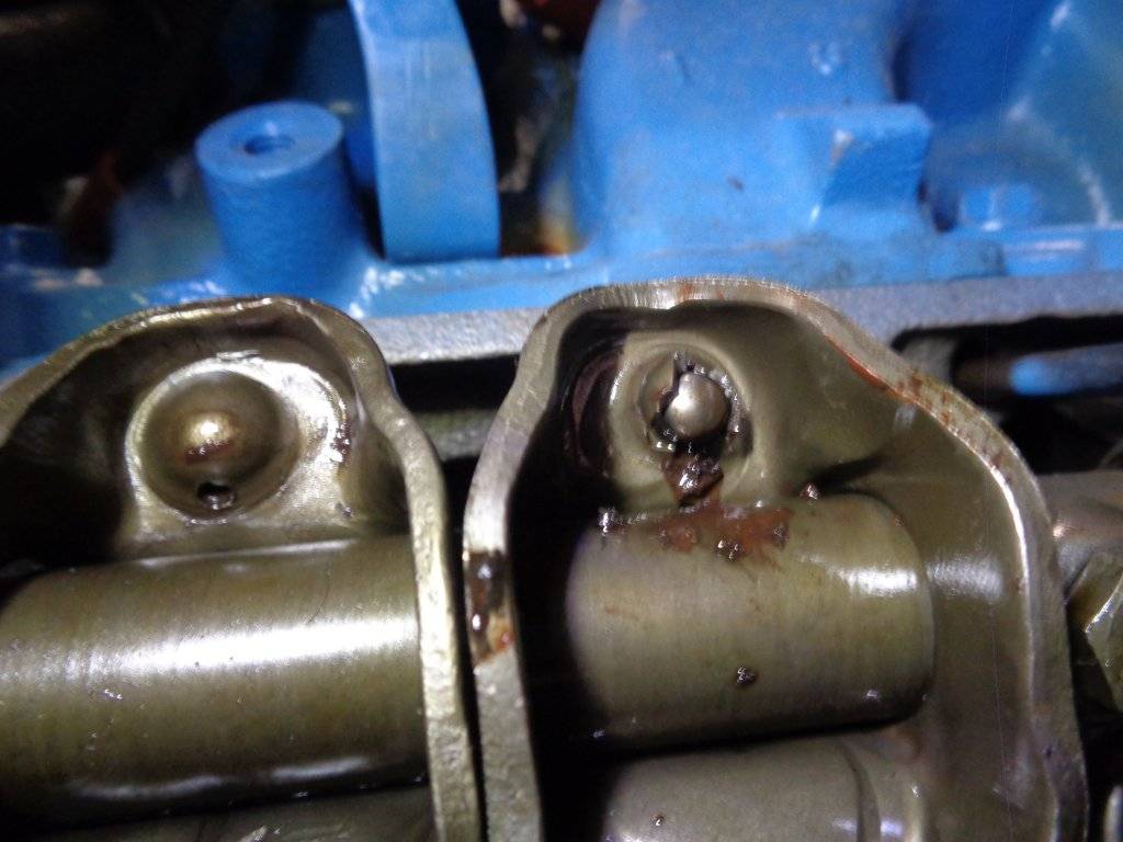

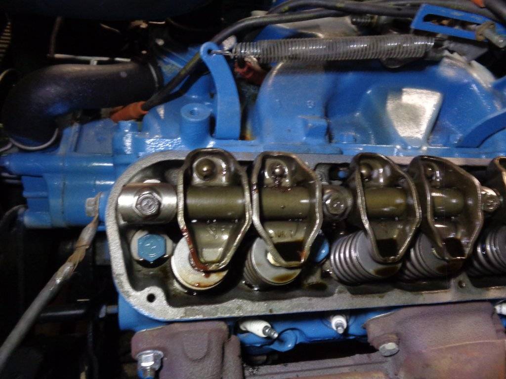

As you can see in the photos below w/ the valve cover removed the push rod for cyl 1 intake valve has pushed through the rocker arm. Closer inspection revealed that there was wear on the push rod tip. What I didn't expect was the push rod was still straight. The heat-treated tip of the push rod worn away rendering it unusable. There were no indications of poor lubrication or plugged oil feed holes. Also note the odd wear pattern on the exhaust on cyl. 1 and on the corresponding rocker arm for that cyl. Clearly misaligned rocker arm to valve present. That will necessitate cyl. head removal. Note the metal pasty sludge in the intake runner for cyl. 1. Defiantly this sludge paste is the result and caused by the failing rocker arm. Will be removing both heads for inspection and to any contaminated oil in the lifter valley. This pair of cyl. heads should have held up better considering the low miles on them. More updates to follow.

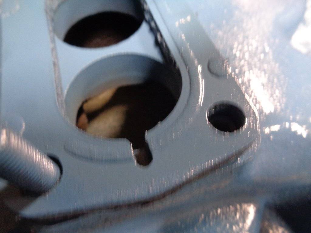

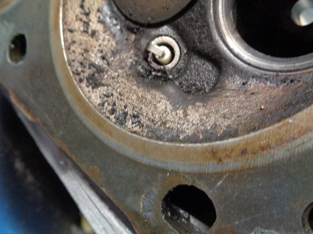

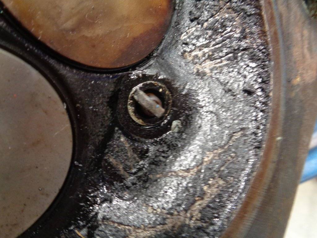

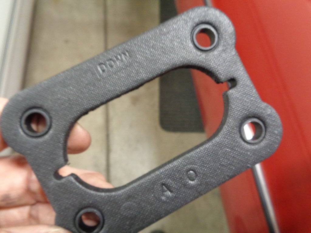

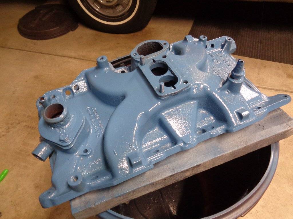

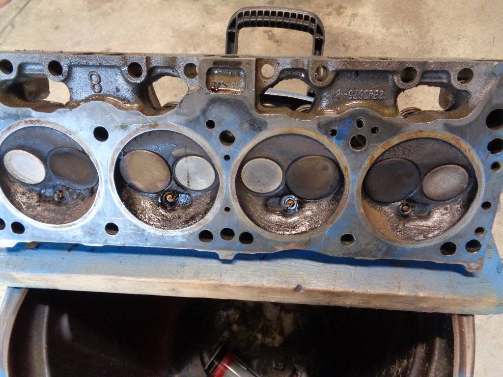

Parts delays postponed reassembly. One of the more notable finds here was the total lack of proper reassembly procedures. Almost all fasteners were under torqued. effected items were intake manifold, Cyl. heads, and exhaust manifolds. Not to be left out the carb base gasket was reused and the limit sleeves removed. A new gasket will be used on reassembly. All valve guides were checked for proper clearance and the valve seats for correct valve fitment. Rockers and rocker shafts were thoroughly cleaned and examined for unusual wear. If you look at the photos closely, supperfical wear marks on the rocker shafts is visible. Not the heavy carbon build up in the combustion chambers.
I still owe this group the muffler dimensions from my 1971 Chrysler 440 standard (single exhaust with resonator) and HP engines (dual exhaust without resonators) still with their original exhaust systems - I should have them all by the end of this week. I will also look to see if there are any differences between the Imperials and the 300s/New Yorkers with the T code engines ( I only own one 1971 Newport and it has a replacement dual exhaust system, so it will hot be helpful).
All threaded holes were chased and all assembly bolts were cleaned. Prior to install each bolt was dipped in ATF, then properly torqued. Another unexpected finding was the amount of wear where the push rods rode in the rocker arms. The wear was significant enough to warrant all the remaining rockers and push rods to be replaced. The upper rad. hose was a bit bloated so off to file 13 it went. New contact points and condenser are overdue as well. Startup went well w/ good oil circulation to both rocker shafts. The transmission mount found sagging a bit and was replaced w/ a polyurethane mount. Heater controls are next on the list of repairs as the temp and mode movement is pretty stiff.

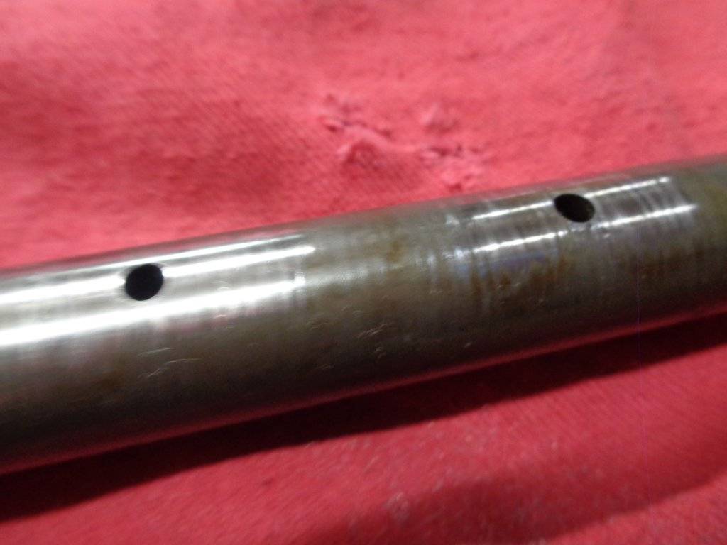

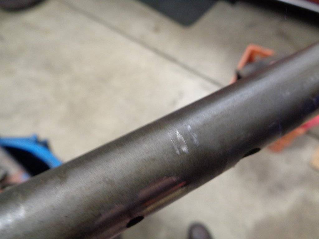

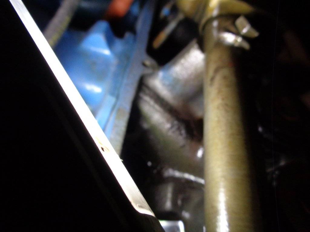

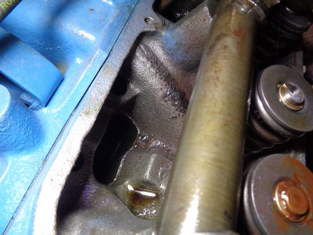

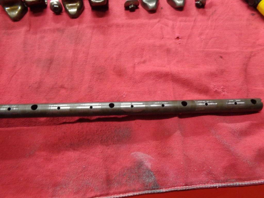

did you replace the rocker shafts as well? it's the right thing to do with all new rockers. wear area to the left looks decent. one to the right looks black and scored. maybe it's just the light.
did you replace the rocker shafts as well? it's the right thing to do with all new rockers. wear area to the left looks decent. one to the right looks black and scored. maybe it's just the light.View attachment 580833
The cause of the discoloration is from the available light when the photo was taken. The rocker shafts were mic'd and spot on factory specs.

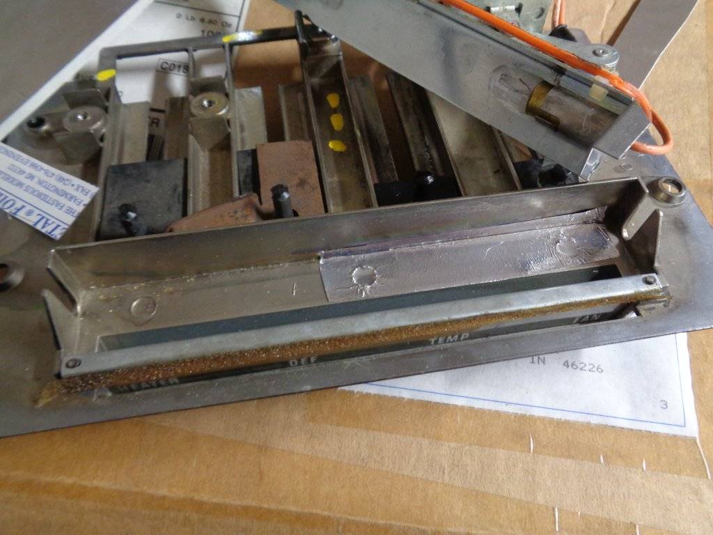

Another of Michel's requests was to improve the operation of the dash heater controls. The temp blend door was very stiff. Glove box removal allowed access to the temp blend door cable. With it disconnected the blend door and the dash controls moved freely. Moving the cable to its furthest travel in both directions and lubing w/ air tool oil, (the lightest grade lube I could find), many many times w/ the cable pointed upward and extending its travel back and forth proper operation was restored. The lighting illumination of the heater controls was pretty poor. I disassembled the assemb. and polished the reflective surfaces. Part of the control base was plated that was quite dull. Using Bare Metal Foil, I cover those surfaces to aid in illumination. The results were quite amazing. See pics below.

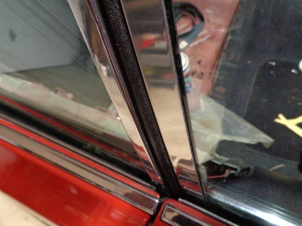

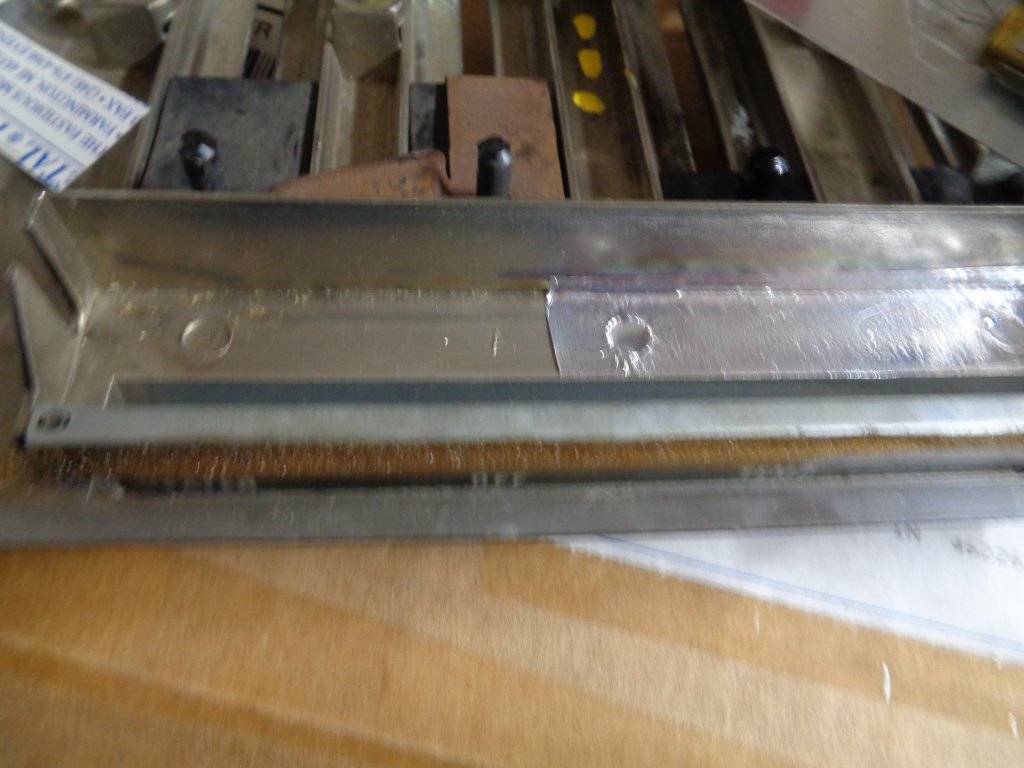

The next of Michel's requests was to check and improve rear quarter window operation. they were very stiff and in need of lubrication in the worst way, almost bone dry. The next two photos show just how poorly adjusted both were.
