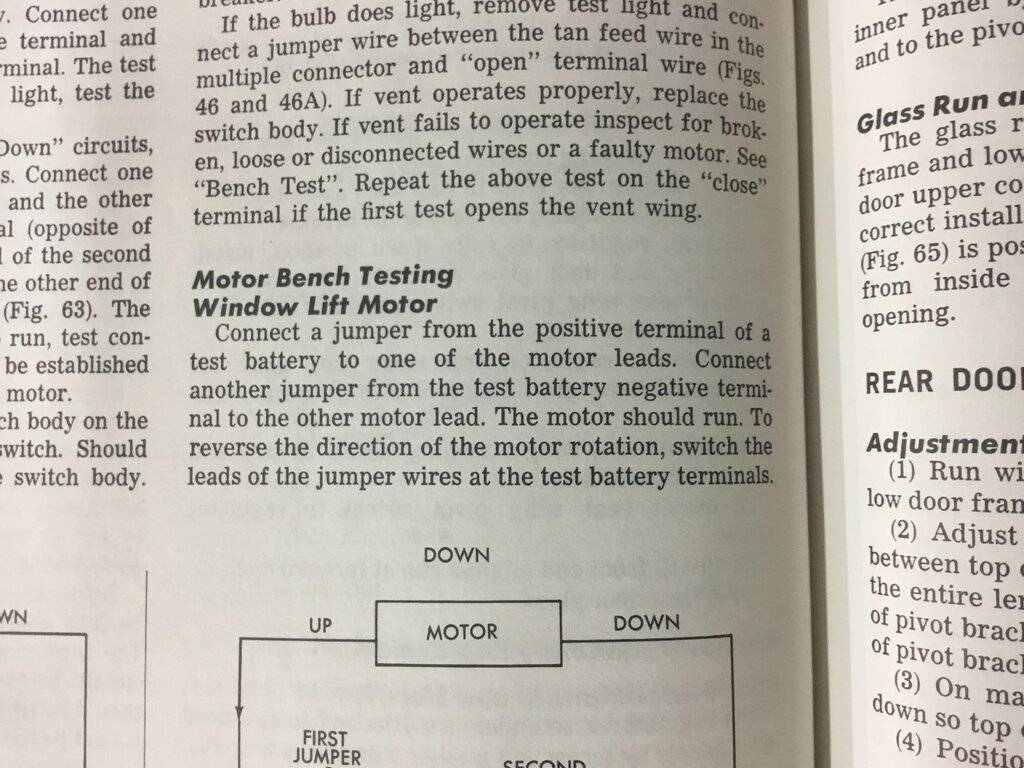

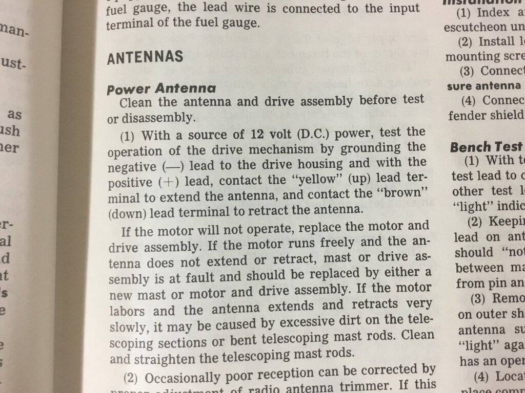

Detmatt- I'm sure it doesn't work. I tested it exactly how Ross suggested. I tested my window motors the same way. Negative terminal to body of window motor, positive terminal to connector, one wire at a time to check and see if it turns both ways.
I test my window motors the way the fsm says to do it. No questioning wether you’re making a good ground somewhere.
The antenna motor is tested differently as per the fsm in the second picture. Just posting these up in black and white.
I’ll pass on the antenna if it doesn’t work.
