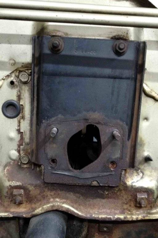

The original manual master was a 4 bolt with the bottom 4 holes in the being used. The bottom most two bolts in the mounting plat were pressed from the master and bolted under the dash. The two above that are pressed from under the dash outward and nutted on the master. The pedal rod goes through the hole between those 4 holes. There is also another set of studs about 4.5" from the center set that are pressed from under the dash and have nuts under the hood.
You may need to change the mounting plate also. Seem to remember that the power booster has 4 bolts with nuts under the dash. In any case you will need the correct pedal also.

In the white firewall pic above, we can clearly see 6 bolts - I just looked at 2 boosters and a mtg plate in my basement, and the upper bolts would locate above the MC studs in the picture. The boosters I checked were the 66-69 dbl-diaphragm disc booster and a 71-newer large-dia single diaphragm booster (both with the same pattern). So I believe that the mtg plate would need changed, and I'd bet that the extra holes would already be in teh firewall. (the factory likely wasn't stamping firewalls specific for brake options, they were already doing that based on AC!)
