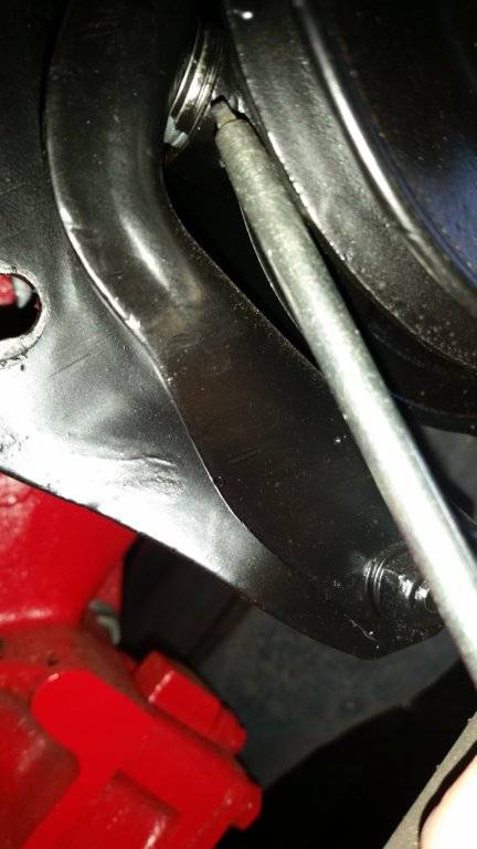

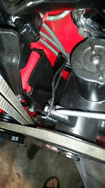

Even with the bushing in place the bracket sometimes twists. I simply stack washers up under the bracket and the two pump body bolts, effectively aligning up the pump. You may need to get slightly longer bolts to do it... see pic below with screwdriver pointing at the washers. I see that I could probably benefit from one more washer under each bolt.

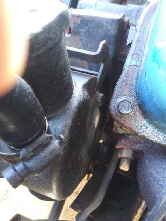

not my car but this:

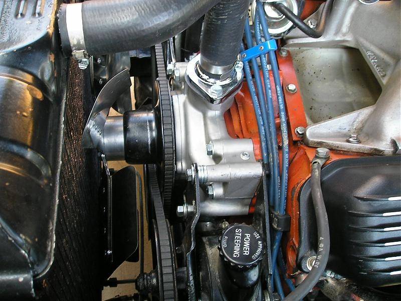

i saw it on 100 cars at the car show - long story but i came upon a motor that the P/S pump was not installed onto so i had carefully looked at a BUNCH of cars as reference to understand how to mount it on my own motor. in my case, the A/C compressor support arm fits exactly into that space and no washers are required.

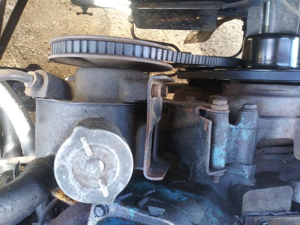

i removed the A/C compressor from the engine, and had to shim the space with washers much like this example picture.
