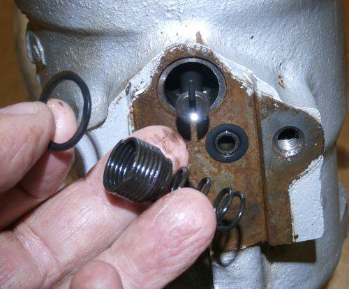

Are you talking about this o-ring?
Because the spool valve itself has no o-rings on it.
My gear got messed up without me even touching the spool valve housing. I only monkeyed with it later because that's what your supposed to do when it wants to turn by itself.
Later I also changed the o-rings mentioned here, even though I had no leaks from the valve body. I changed them because I took the valve body off the gear. I don't see how any of those o-rings touch the lever pin that moves the spool, so I can't believe they could possibly play a role here. They're strictly to seal the oil ports between the valve body and the gear unit.

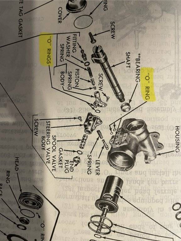

At rock auto I've looked through 67 - 73 Monaco and Polara, all the various engine options from slant-6 to 440. Looking at the "Power Steering Control Valve Seal Kit". They show either a single option (the Edelmann 8518) or 3 options (the Edelmann plus SUNSONG 8401175 plus FVP 8518). I can't figure out why, for some year/engine combinations you're only shown the Edelmann option, and not all 3 options.
The Edelmann kit is $7, the Sunsong is $2, the FVP is not available. From the pics, they look identical. 7 o-rings, 3 small red + 4 larger black.
The 4 I’ve highlighted in this picture. They have to be the exact, correct size/thickness.
