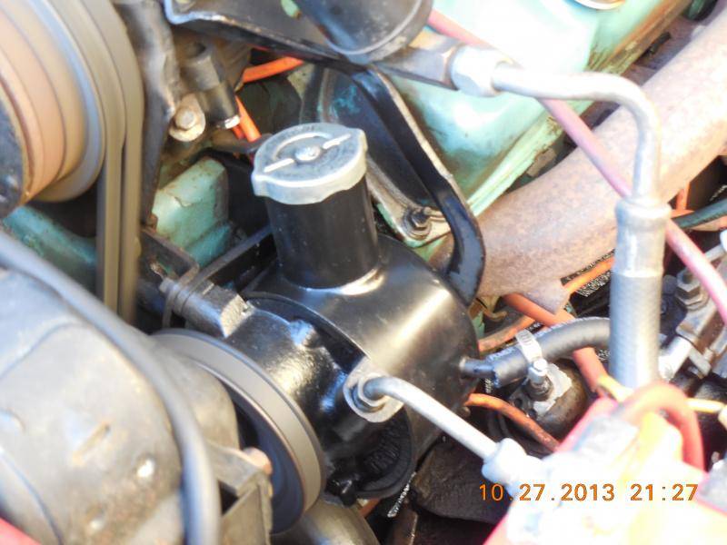

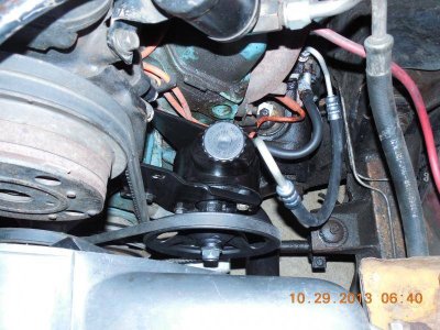

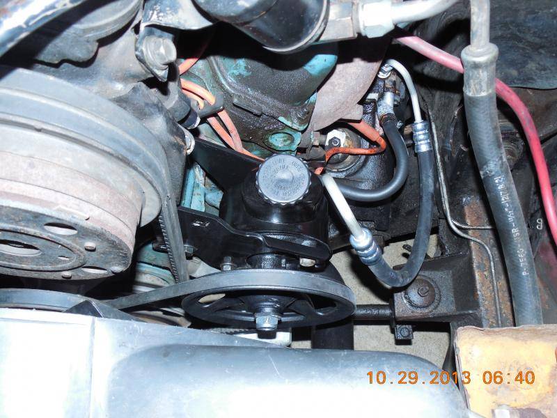

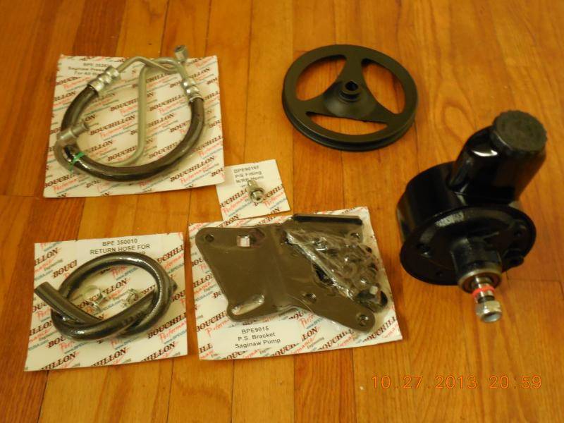

DSCN0446.jpgDSCN0448.jpgDSCN0455.jpgwell heres the update out with the old and on with the new. went pretty good except for some minor tweeking of one bracket for clearence. looks great and best of all no more leak. pics of the kit before install and 1st pic is old pump 2nd is the new.
