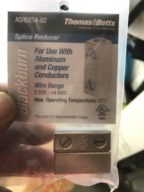

I examined the wiring and the battery conductor at the bulkhead connector has been spliced previously. The splice hasn’t held up. So, today’s project is to reroute new 10 gauge wiring through an existing firewall grommet. I will be using a mechanical butt splice as I don’t trust a standard butt splice to carry the load of the entire electrical system. I am using some 10 gauge THHN I have several spools of. It is rated 90 degrees centigrade and is oil/gasoline resistant.

I am not a fan of those type of connectors in automotive. Vibration and what not may allow the screws to back out over time. Nor am I a fan of THHN wiring which I believe is recommended to run through conduit. The insulation is usually more brittle as well.
If you do use that connector be sure to insulate it well. Just wrapping in electrical tape will not cut it. A couple layers of electrical shrink tubing may help keep it from wearing through on something and grounding.

THHN is pretty sturdy. I have no qualms about using it. Insulation becomes brittle due to heat.
I have used mechanical butt splices on factory equipment, service drops, etc. I trust way more than a crimp butt splice.

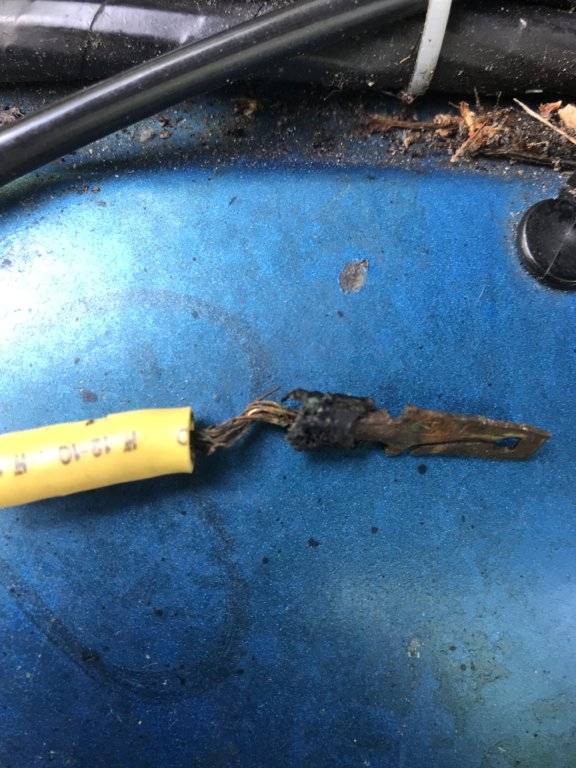

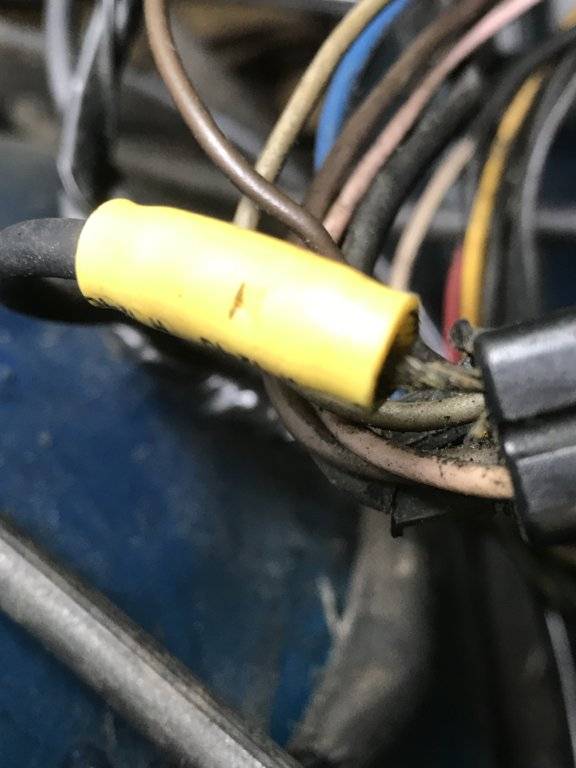

Photo of existing splice.

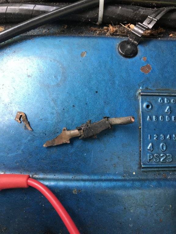

Wire on alternator side had a broken connector. Wire on battery side shows signs of overheating.
Done. Idling with ammeter in center now instead of below. Wipers aren’t slow in idle. Only headlights really put it down.
No voltage drop between alternator and battery, which is what is important to me.
The original style male terminals are on eBay. I may buy them and put everything back as built. I prefer original.
Your melted/burnt butt splices are the reason I don't like using them. I prefer to solder wires and heat shrink. I have heard people complain about soldering too though.

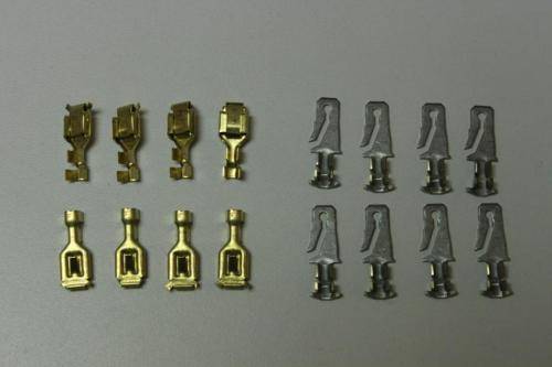

Yes. I also see some of the bulkhead plugs (not sure official name) that the connectors go in. I wondered if they were available as I have never seen the male ones before. They have an odd design. I’m guessing they are made that way to lock them in the plastic connector.

My question is are the male spades of the correct material as I seem to remember that they were of a brass composition (same as the females).

The old ones do look brassy.

The dissimilar metals thing. I believe the silver terminals are zinc plated. Brass is made of zinc and copper. Not an issue.
