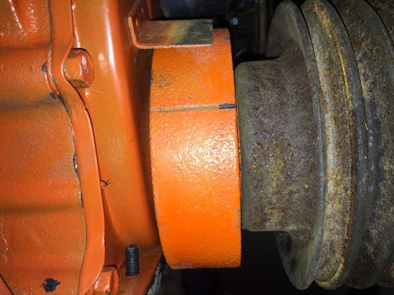

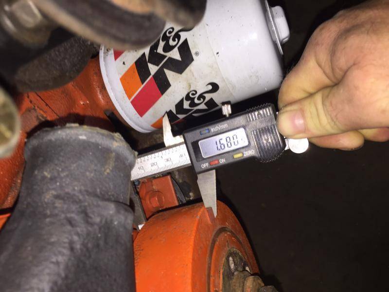

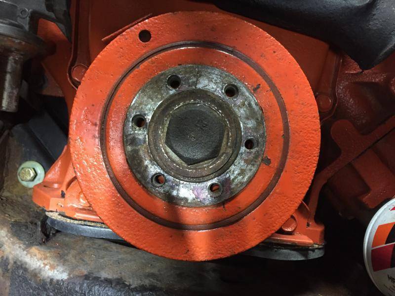

Well after a couple days of researching on line I cannot figure out which harmonic balancer I have. I believe if I had a thinner balancer then I could use the 2 groove crank and water pump pulleys that I have. Can anyone identify this balancer or maybe help me figure out if I need a different one? It measures out to about 6 3/8 in diameter.

Any standard 383/440 steel crank harmonic balancer will work. they don't have any counterweights and measure in at just less than an inch thick.
Ah! The balancer on there now is around 1 5/8. They should call it mopars law, not murphys! So close......yet so far away!
I'll get the one off of my buddies 383 forged crank then. Hopefully I'll be able to run my dual groove pulley then. Thanks again.

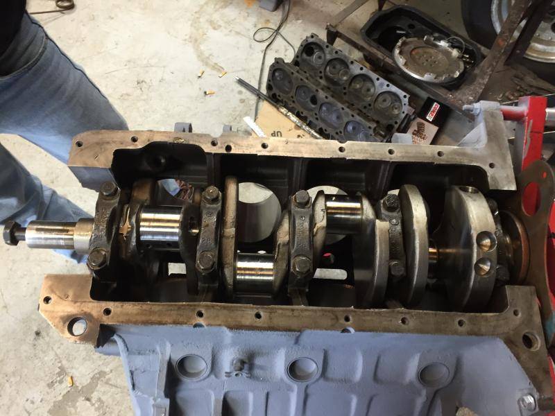

Here's my crank. It's cast. Now if cast = externally balanced, why do the counterweights look like they've been drill for balancing?
Don't know about the drilled counter weights. Cast does = Externally Balanced and Steel = Internally Balanced.
That's been my concern. So I'll have to have counter weight added to torque converter and get a different balancer. Yay! One step forward seems to be 2 steps back with this thing! Shoulda done my homework a little better!
thanks for the help!!
That's a forged crank has soft edges and a blended parting line. Cast crank has sharper edges on the counter weights and the parting line, where the two sand molds come together is sharp and thin. Use a thin dampener then the two groove that can be stolen from a 318 also.
Wait what? The crank in my pic is forged? That makes things easier but I thought forged looked more machined! I'm far from an expert and feel a bit dumb for not knowing what I have. I'm at the mercy of those more experienced...at least for a minute. Thanks
