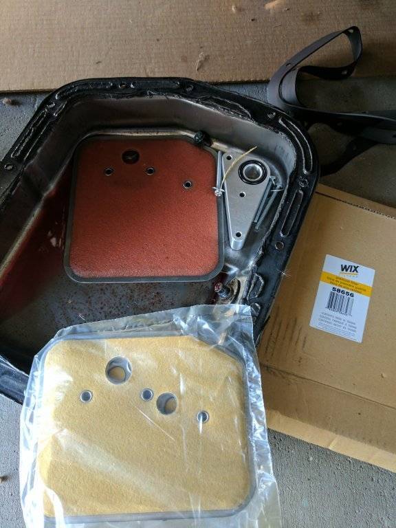

Just finished doing that. When disconnected the wheels spin no problem, forward and back. Question, what would happen if the starter is not disenging
I don't know if the starter will turn in either direction. But, to test your theory would be fairly simple again. The starter is held on by two bolts. Remove them and back it away; you won't need to remove the cables to do so. Once it's clear of the torque converter, see if you can spin your wheels. If you can - in both directions - you've discovered the problem.
I think I found the issue, have not had time to put the right filter in, but I have a feeling I burnt up the pump.
