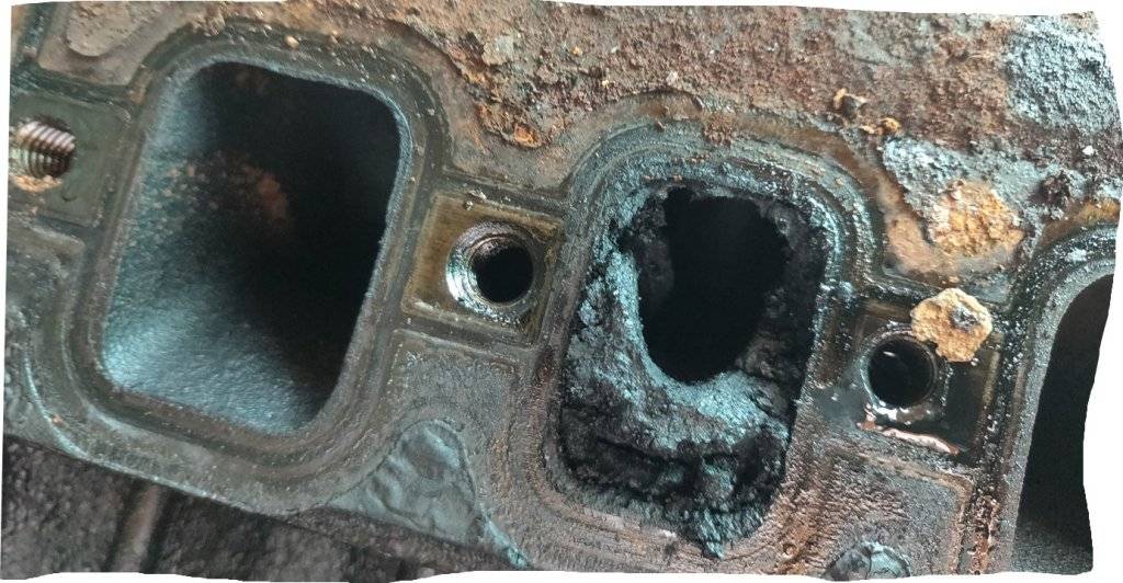

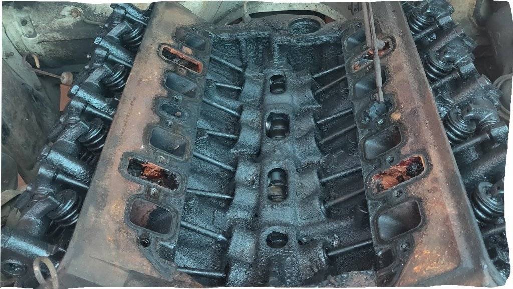

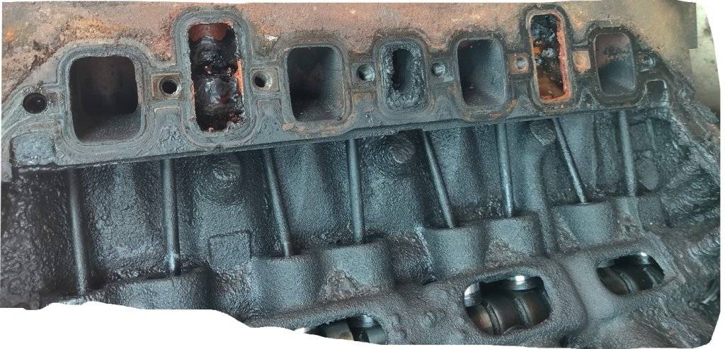

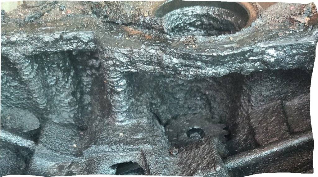

Was able to pull the intake, distributor etc today. Tomorrow will pull the heads. Looks pretty gummy in the engine...especially the exhaust cross over. Definitely best I'm pulling the engine.
