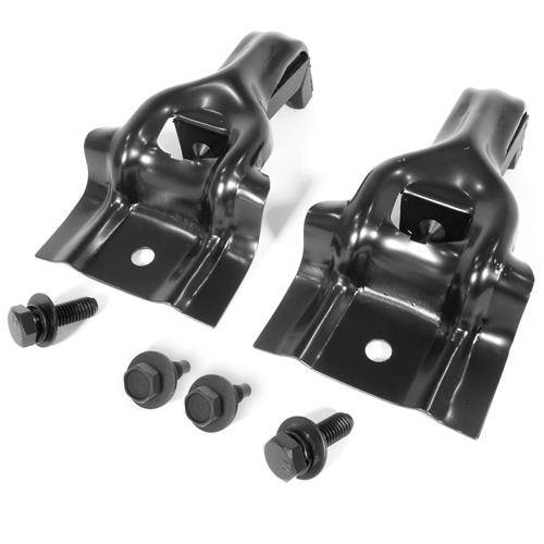

Are you going to use the mounting tabs? I used Ford mustang radiator upper/lower mounts for my Griffin Radiator in my 65 B body. I just 'felt' better with something else supporting the aluminum radiator while cruising around Chicago with its notorious potholes

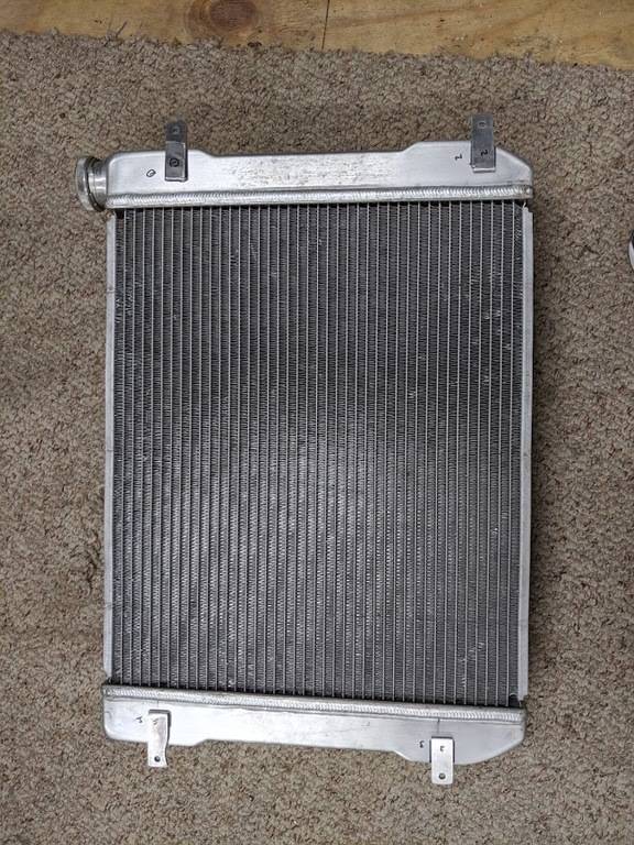

I am going to weld the tabs in the pic to the radiator and then bolt to the radiator support. I am able to use 2 of the existing holes but will have to drill the other 2.

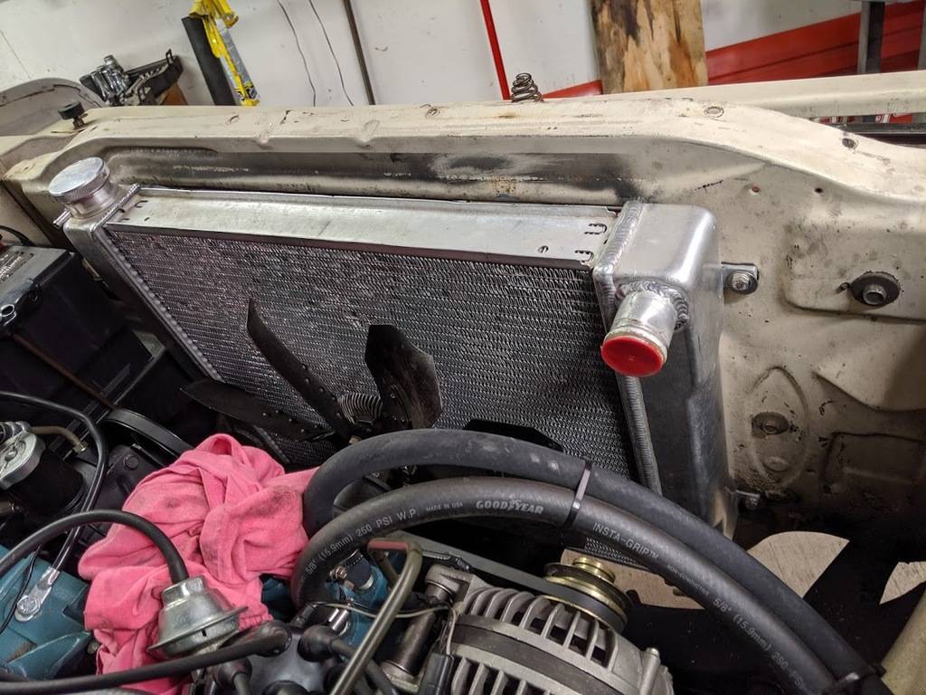

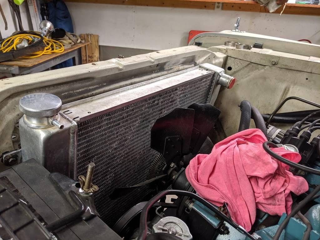

Well, I finally got around to welding the tabs on the radiator. Hopefully have it back in the car this weekend.
