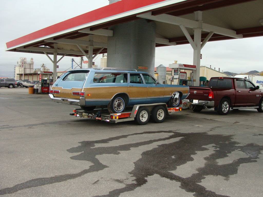

This was towed with a regular cab, short bed 2WD Ram 1500. It pulled it just fine, aside from the driver acting like he wasn't towing a 4500lb car.

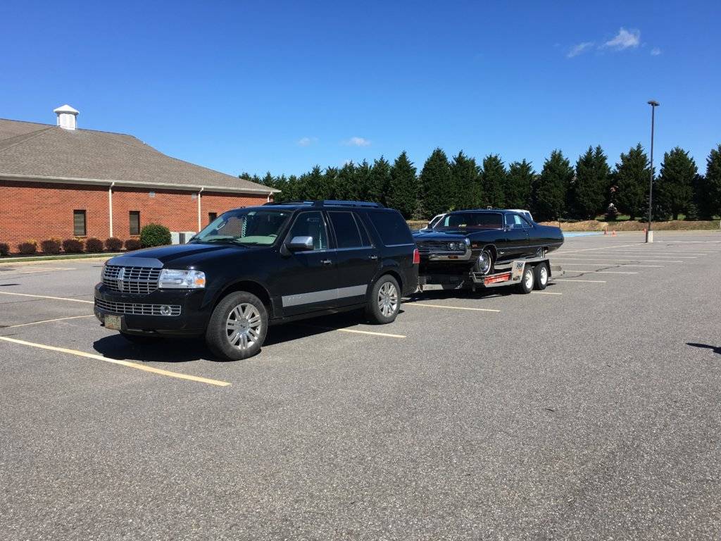

You don’t mention where you’re towing from or how far. I towed my C body on a u-haul with a Lincoln Navigator. It weighs around 6300 lbs and is rated at 9000 lbs, according to the tag in the door sash. The problem was that I towed it from Virginia to Indiana and went through the Apalachians. That was intense to say the least. Going uphill wasn’t a problem. The Nav pulled at a steady 50 mph without a breaking a sweat. Going downhill however was different and that’s putting it mildly. The first couple of downhills I thought I was being conservative at 55mph. That was until I looked in the mirror. The Nav has the tow package with anti sway, but I found I had to keep it around 45-50, otherwise the trailer would start to swerve. The u-haul had a 2 piece sliding tongue with a brake and there were a couple of times the trailer crept up on me and chirped the tires. As I said, intense. I also have a Ram 1500 4x4, standard cab and short bed that weighs around 5200 lbs. I towed boats, cars, and utility trailers. I didn’t use it for this trip because it needed tires and shocks. The trailer and the car probably totaled somewhere around 6000 lbs. Looking back I’d have to say that even if I had new tires and shocks on the Ram, the Nav was probably the better choice.

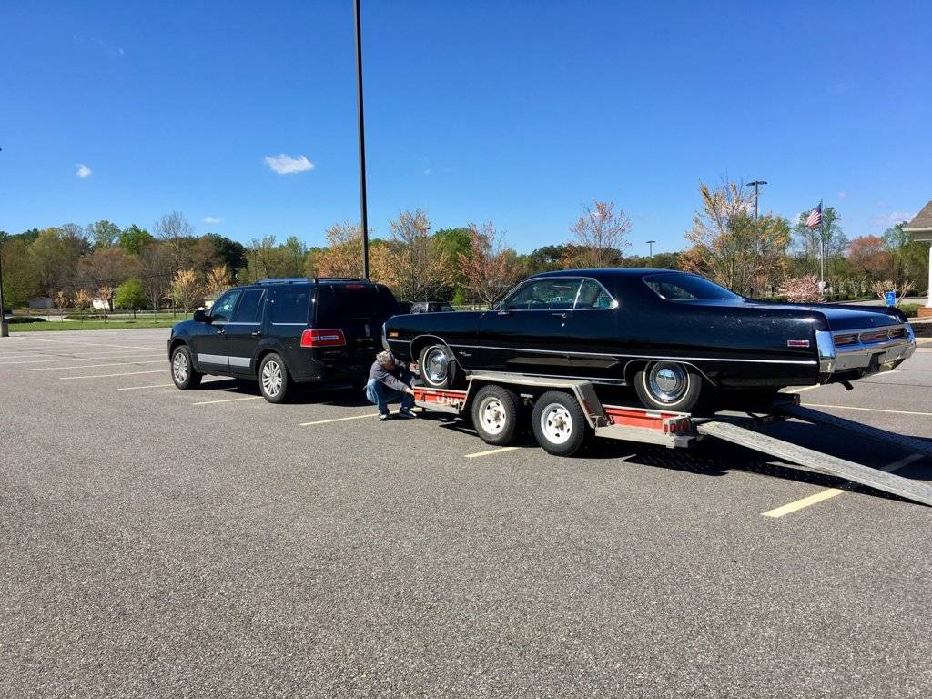

I had the same type u-haul GOLDMYN shows in the photo above. Told the guy at the u-haul what I was towing, but I guess it didn’t matter to him. The regular C fits with only inches to spare. An Imp might not since it has a longer wheelbase. Lots of overhang, you betcha!
