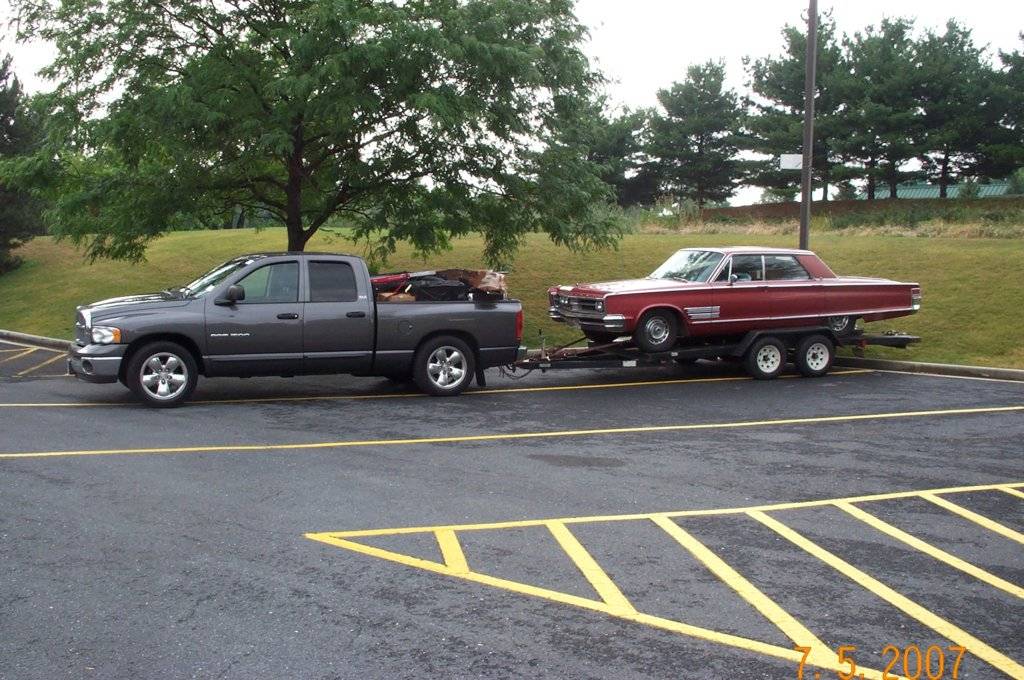

2002 Ram 4 x 2 with 5.9 magnum V8. No problem towing a C with the C and the truck bed loaded. 70 MPH or more uphill with the a/c on.
If you are careful and brave, you don't even need a full size truck.

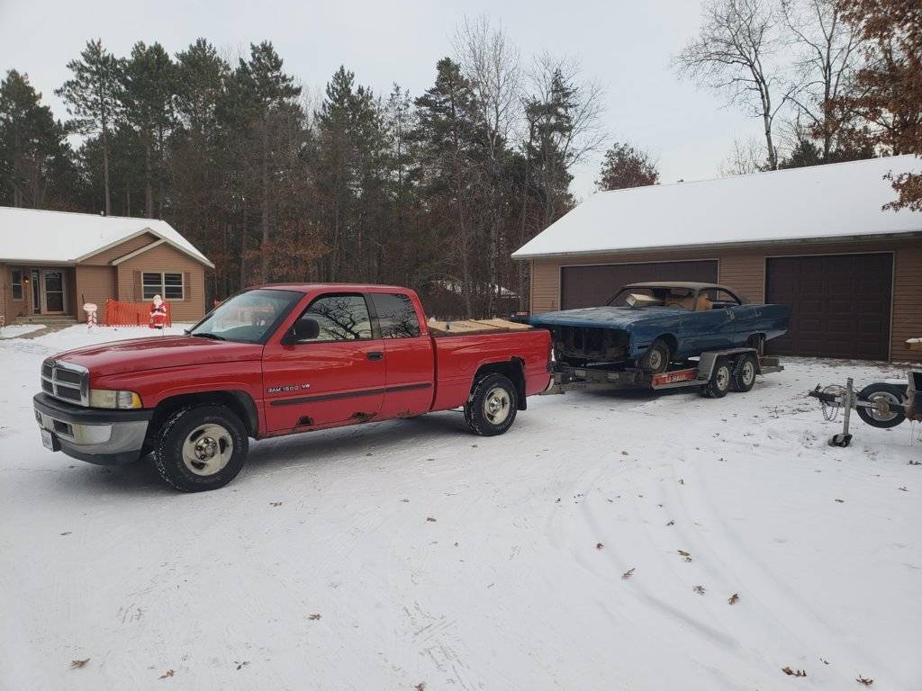

A short wheelbase half ton will tow ok as long as the car is loaded right. I towed a 74 Duster years ago when I had a half ton. Problem was I could only load it backwards on the trailer. All the weight being so far back made it sway badly at anything over 50 mph. After that experience I bought a longbed Ram 3500 Cummins diesel and a 20 foot trailer with the axles set back. No problems towing anything now.

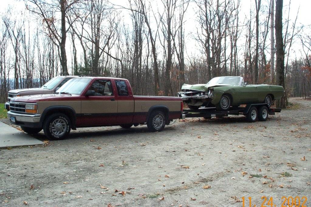

In November of 2002 I picked it up for a friend from someone who wrecked it badly. I think it was a low option 318 car. The car was somewhere in the hills of Western, MA. My friend built the Monlara as it is referred to, the red '70 Polara Convertible with a Monaco grille and tail lamps etc. currently owned by and For Sale by John M and wanted this car for parts. I really don't recall much else other than we spent hours getting the right front so that it would roll. Not sure if it is still in my friend's personal junk yard or if it went to the crusher. It had some rust issues. That's all that I recall.
So from two Polara convertibles, one beautiful Monlara ragtop. Thank you for sharing! If by any chance your friend still has the fender tag or so a pic thereof, I’d love to see it.

To clarify and confirm, as noted above the Monlara was already built when this car was bought for spare parts. Interesting fact is that the Monlara was a rebuilt wreck and took a very hard hit to the front necessitating replacing the front stub/sub frame and the front clip.

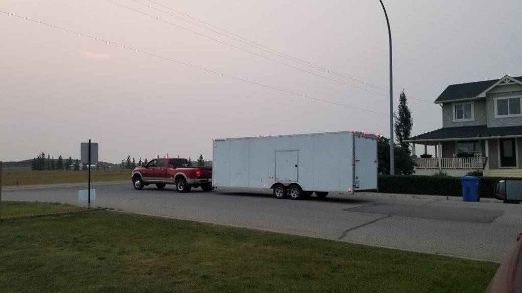

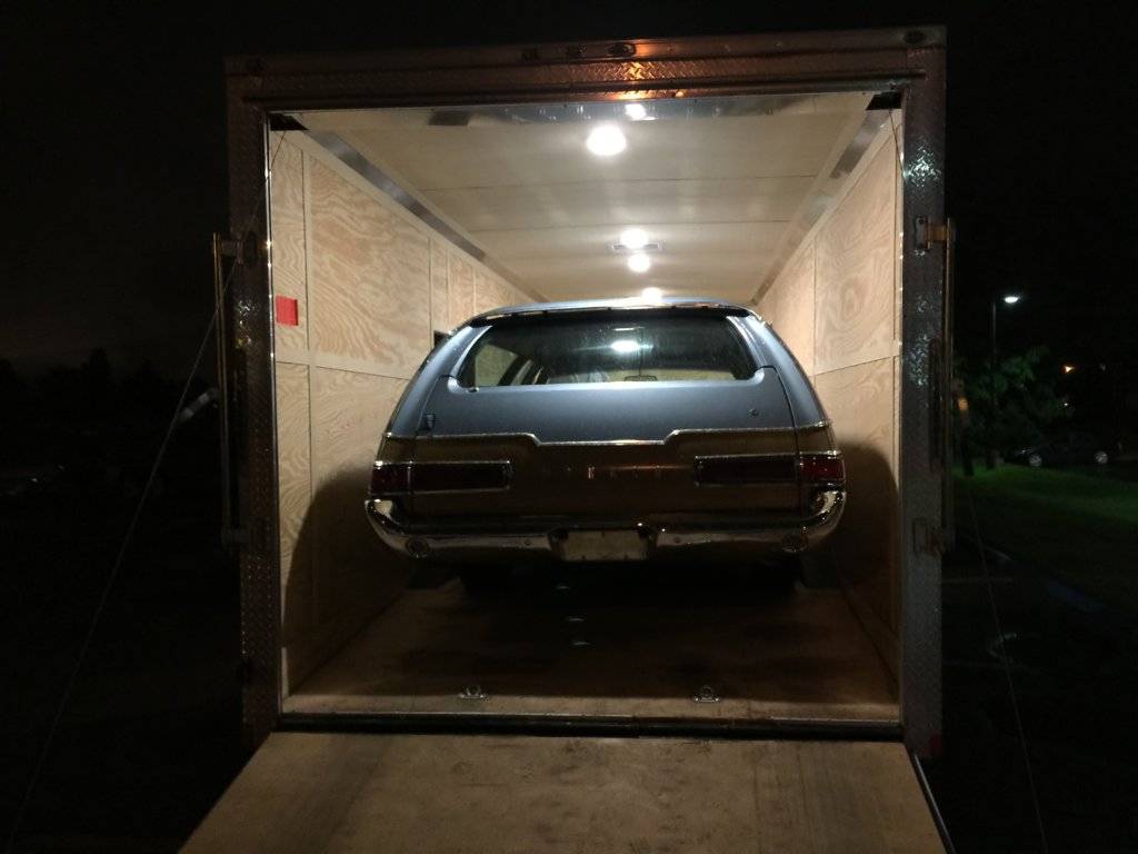

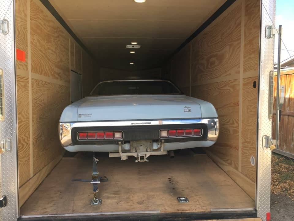

My tow truck is a 2010 Dually with around 600hp at the wheels and my trailer is an 26ft enclosed and I have to say I love it , my average travel speed is 75-80mph and no swaying at all, I tow around 40tmls annually with my truck all over Canada and USA.
I never would tow a C Body with a half ton truck is just my opinion.
View attachment 249299 View attachment 249300 View attachment 249302 View attachment 249303 My tow truck is a 2010 Dually with around 600hp at the wheels and my trailer is an 26ft enclosed and I have to say I love it , my average travel speed is 75-80mph and no swaying at all, I tow around 40tmls annually with my truck all over Canada and USA.
