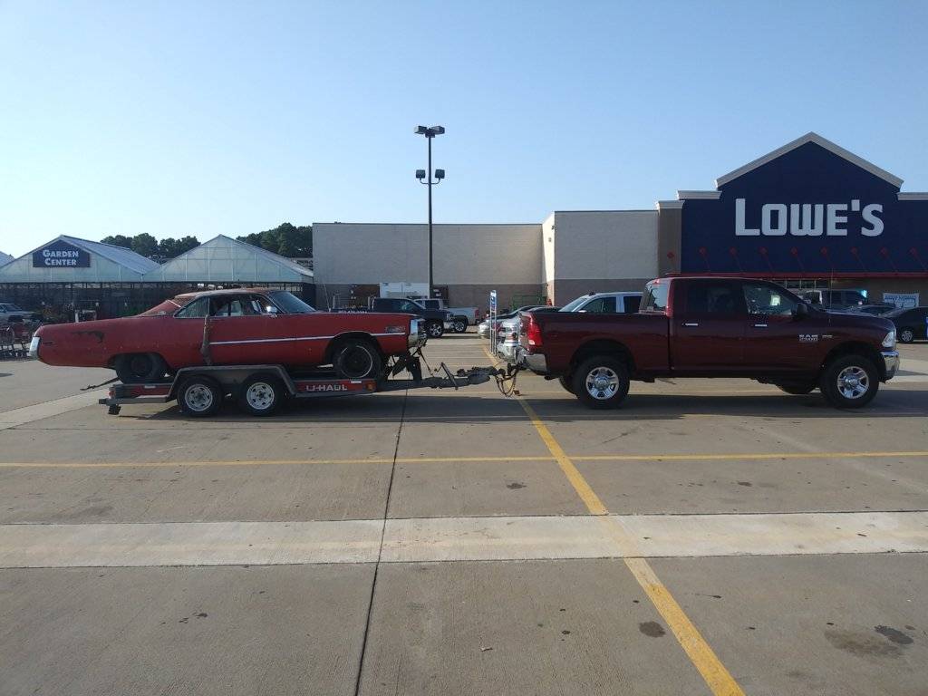

The weight distribution was way off. Look how high the front end was. No matter what I was going to have issues with the rear of the car being the heaviest part. I did take your advice and tried the drop hitch to get the trailer level, it did help a bit but still wanted to sway over 60mph. The sand is what got me moving 70-80 mph, I eventually switched back to my original hitch and took the drop back to Lowe's.

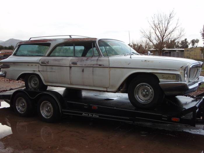

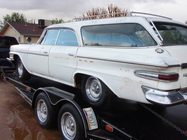

Looking at those U-haul trailers with C bodies on them they seem very scary. Wyatt, I'm wondering why with as many cars as you haul home how come you don't have your own trailer? One that doesn't look so overwhelmed with a big car on it?
View attachment 249371 View attachment 249372 Looking at those U-haul trailers with C bodies on them they seem very scary. Wyatt, I'm wondering why with as many cars as you haul home how come you don't have your own trailer? One that doesn't look so overwhelmed with a big car on it?

Since this thread got brought back up can you tell me a little about your trailer? I'm looking for one that can do double duty hauling my cars and also my tractor. Your's looks like it is longer than that wagon, which is what I want, plus my tractor with bush hog is about 20', so what length is your trailer? Also, how is it with lower riding cars? Any dragging issues when loading?

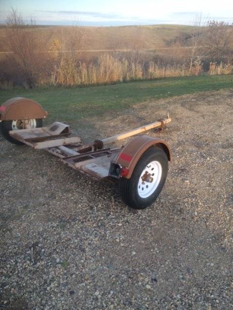

Last fall I went thru my trusty, but falling apart tow dolly for a rebuild. New chains and hardware, wiring, lights and paint, rebuilt the ramps as a certain 73 Newport bent one. I've hauled cars from as far as Alabama and Dallas to North Dakota with my 87 Ram and 2006 Ridgeline without any issue. New tires are next.

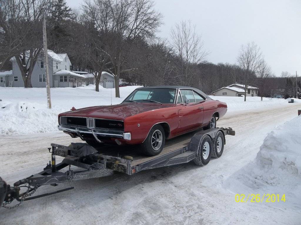

Which year is the Charger on that trailer? It has 68 side marker lights but a 69 split grille.
Don't have any pictures of the enclosed trailer at work but here is a pic my wife took when I got home with my 68 Charger.........Yeah, I know about the 69 grille. That's the way the Chebby guys do things in Mississippi.
FYI, read his post ...
