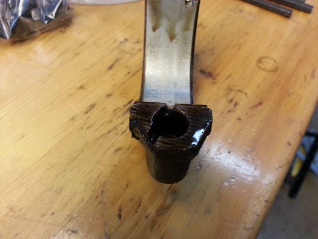

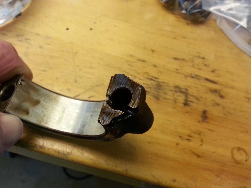

I have a 400 in my '76 T&C that I am rebuilding. I was checking the bearings and noticed something on the rod caps I am not familiar with. It looks like the caps have been drilled to relieve oil from the bearings. It has been a while since I have had 400 apart and I dont remember seeing this before. Is it correct?

The relief is not for the camshaft, but for the opposing cylinder wall. If you notice any aftermarket rods now, and many rod bearings do not include this passage anymore. That's because it was found to encourage oil burning by flooding the scraper rings and contaminating the combustion chamber. Oil splashing around is good in a lawnmower. Controlled oil delivery is good for an engine with a pressurized oil system. Windage trays only help oil from getting pulled up from the sump by the rotating assembly. They are beneficial in any engine that runs hard. That's why they were on all performance V8s, and police cars.
