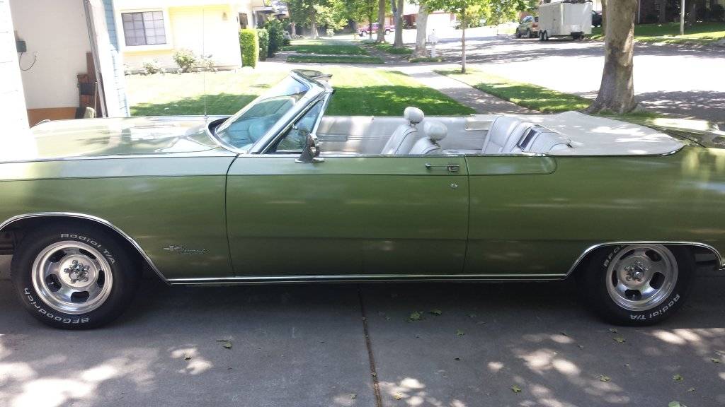

Thank you for saying "some." When I put these Shelby Cal 500s on my Newport, I had guys on C Body sites telling me my wheels were going to fall off. It was only a mater of time.
Had them on for 12 years and over 40,000 miles.
