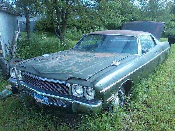

I have never really looked at these as a good rear since they have been in later cars but I guess I am wrong. I have a guy with a 73 fury that has a 400 in it and a sure grip 9.25 rear. It is rusty in the pans and trunk and that is what I wanted so I passed on the car. maybe I should pick it up if these are good for C body cars. Will they swap right into 69 or 70 models? He only wants $300 for the car so I would think the rearend with suregrip and the 400 should be worth that and scrap the rest.

BUT, are you SURE that 1973 has a 9-¼??
Most are 8-¾ as the 9 was only used on very late builds of the 73 MY.
Yeah it looks like a 73 and he said it was a 73. I have not laid eyes on it yet in person but he said the rearend drops out the back and has 10 bolts on the cover. Here is a pic of the car.
I also picked up a 73 polara last week that was a 400 2 barrel that has the same 9.25 rearend in it.
