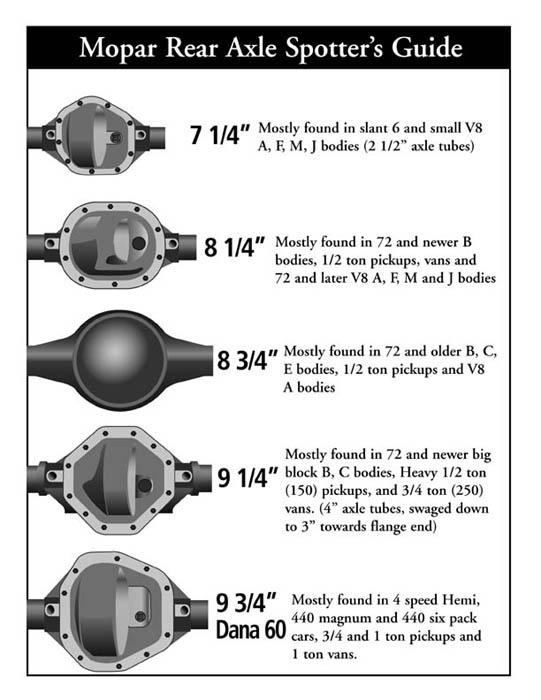

10 bolt cover is the 8 1/4. The 9 1/4 rear axle is a 12 bolt cover. I'd be interested in the 8 1/4 axle guts if the sure grip, and gears are good. I'd also be interested in the front disc brakes.

400-2bbl most likely has a 8.25. If it has a single bolt at the bottom and cover is oval/round its a 8.25. A 9.25 has two bolts at the bottom and the cover has a flat spot at the bottom. The disc brakes on both those cars are worth the 300

Is it just the rotors that everyone wants on those or is it the booster unit too? the polara I picked up had them too. I am pretty darn sure that one is a 9.25 as it had the flat spot on the bottom of the rear as I looked at that while I winched it up on the trailer.

Some ratios are notavailable in some rear axles. The 3.73s are one example - I think they are the 741 case only in terms of 8 3/4. They should be available in the Dana 60 ofr FAB9, possibly the 9 1/4. In terms of ratio choice - I think higher ratio is better for a cruiser with a big motor. Meaning the lower gear number: 3.55 or 3.23 would be fine.
so would a set of 3.55 work? or would I have to go 3.73?
I would go with a 3.73 minimum but preferably higher something like a 4.10 would be much better. Another alternative depending on how far you are into the build is going with a much smaller cam and running the Performer RPM intake instead of the Victor. A stock magnum cam with your setup should easily produce over 400 hp. and you could get away with running a 3.23 and have excellent throttle response. Horsepower numbers alone are not going to determine how fast you accelerate. A mild 400 hp build with a 3.23 gear may very well out perform a 600 hp build also running a 3.23 gear.
