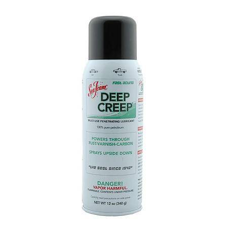

There is a product called Cold Shot I believe made by CRC & Deep Creep made by Seafoam. These are far superior to PB Blaster on stuck rusty bolts. If you are worried about breaking a U bolt or shackle. This is what I use on the bumper bolts. They are expensive so I only use them when I'm concerned about breaking a bolt off. PB Blaster on everything else. You need to wire brush the U bolt threads before you spray them. Only takes a few minutes & knocks off much of the rust & road grime. Then spray away. In 30 plus years of taking cars apart & swapping rears I've never broke a U bolt or shackle. Bumper bolts are a different story. I've snapped off dozens. They are in difficult to reach locations & too short to get to with the wire brush.
Anybody got a picture of the can.
