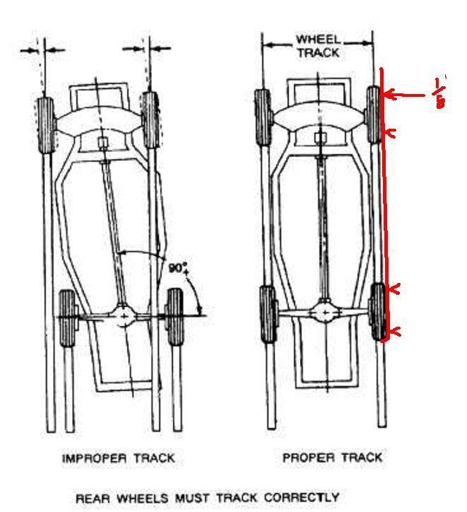

Had new wheels and tires put on the car recently and noticed that the wheels don't seem to be evenly located in the wheel wells on each side. On the drivers side there is barely enough room to get my fingers inbetween the tire and the front of the wheel well while on the passenger side there is plenty of room(I can take measurements tonight if necessary). I'm running 255R70's in the rear with 235R70's in the front if that matters. In retrospect I wish I ran the 235's all around but can afford to eat the price of the two tires, but that's a different story. There are no adjustments to the rear end that should be made, correct? I checked the FSM and didn't see anything. Could a bad leaf spring be causing this? The car does seem to sit higher on the passenger side when looking at it from the rear. Any experiences with this and input is greatly appreciated. Thank you.
First thing I would do is have someone follow you to see if the car is tracking straight down the road. This can also be accomplished if you have some wet pavement to drive through and are able to observe the tracks when you hit the dry area.

The best and easiest way to check tracking is to drive over a sandy path and check if your rear tire tracks are perfectly lined up with your front tire tracks.

I will take a good look at bushings and any other contact points that involves the rearend. I will also check on the tracking somehow and get back to everyone on findings.
