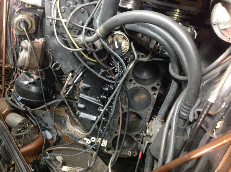

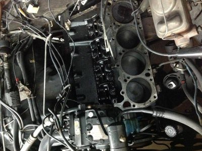

Took a good look at the block and it is good and clean for a 41 year old car. Looks like the past (and present owner) changed the oil often.
Ill post some some pictures tomorrow. Heads should be done by Friday next week....

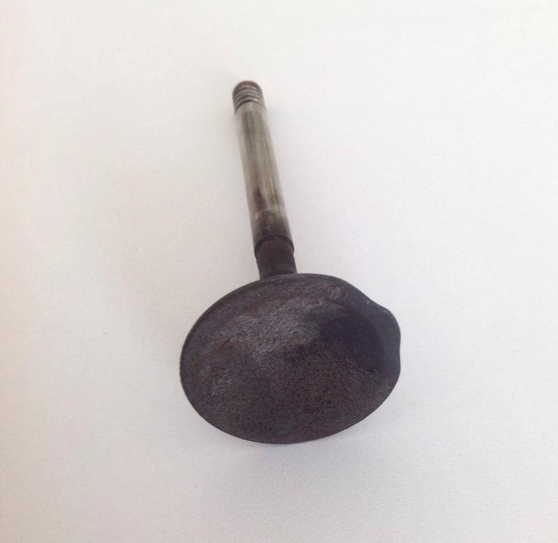

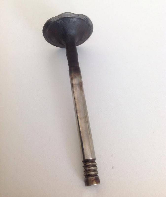

Here are some pictures of the valve.
Valve burned on top and bottom. Looks like someone took a blow torch to it.
No wonder I had a rough idle! Compression on #3 was pitiful. Block, rings and cylinders are all good to go.
The weird thing was that, as soon as I would crack the throttle, the rough idle would smooth right out. Drove me crazy! I guess the lean idle mix and low compression would cause the miss at the lower revs. Once the throttles opened, the richer mix and higher pressures, longer more complete burn helped "balance" the loss.
