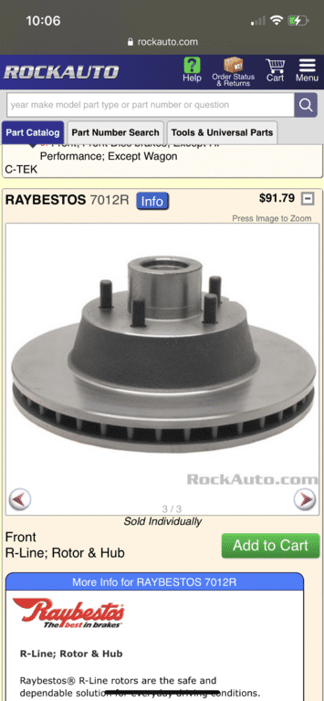

Is this rotor good a good replacement for the ones that are on there way out?
That will be fine as long as you are not going for a 100 point restoration. Factory rotors were a two piece design, the aftermarket ones are one piece.

Hopefully this is good!
As long as you are "comfortable " with Chineseum....
Raybestos, with the rest of the Chinese sell outs, are sadly, all Chineseum.....
I have a handful (only) remaining of N.O.S. U.S.A. made Hub & Rotor (1 piece --- aftermarket) Assemblies....
P.M. me, as per forum rules, if interested..... Craig....
