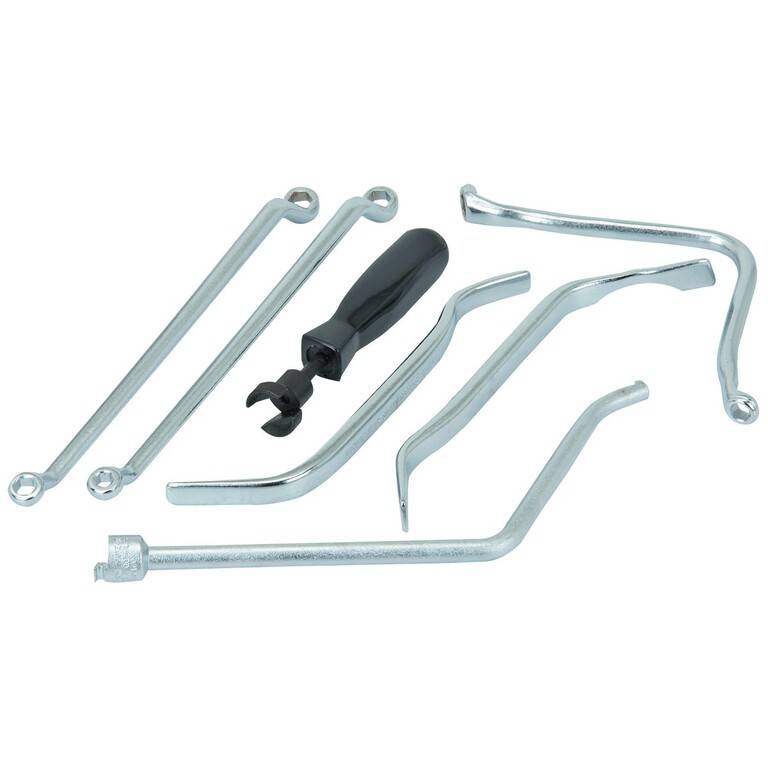

The tools that you need are pretty simple. You can do it without, but they make things easier.
These are from Harbor Freight, but you can get them anywhere... Amazon should have them.
All you'll really use are the spring remover/installer (foreground) , the retainer spring tool (screwdriver handle) and the adjuster tools.
