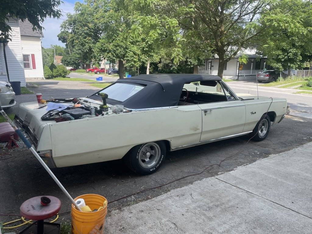

Replacing my convertible top - 1965 Chrysler

Got it finished, with many thanks to you. Your description and pictures helped immensely.
When I got this car 20 years ago, it needed a new top. (...) the pads have lost all of their padding. Fortunately, I ordered new ones.
