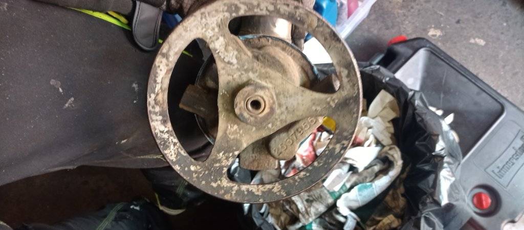

I bought a new one from BBB, but it didn't come with a pulley. There's something that looks like a nut on the end of the shaft. Does that have to be removed before the pulley comes off? I would think that it does, but it doesn't have a hex design, so I'm not sure how well a socket will work on it.

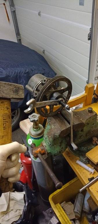

There are 2 types of pulleys. Some will be needed to just pulled of others are with a nut.
Here is mine, without nut. Just pulling it of with force and a special tool.
Like this
Excellent.
