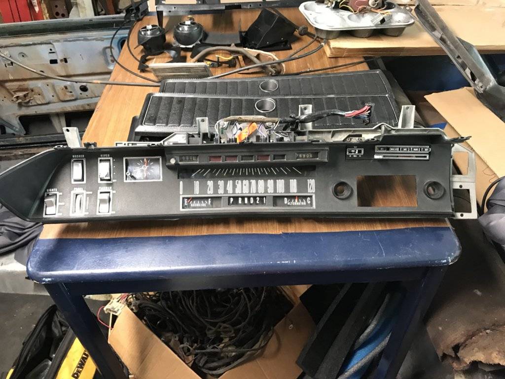

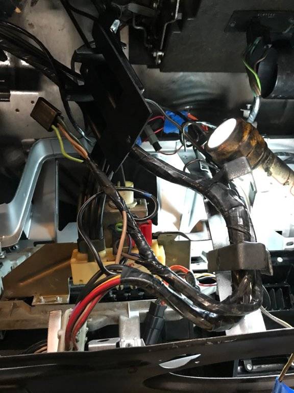

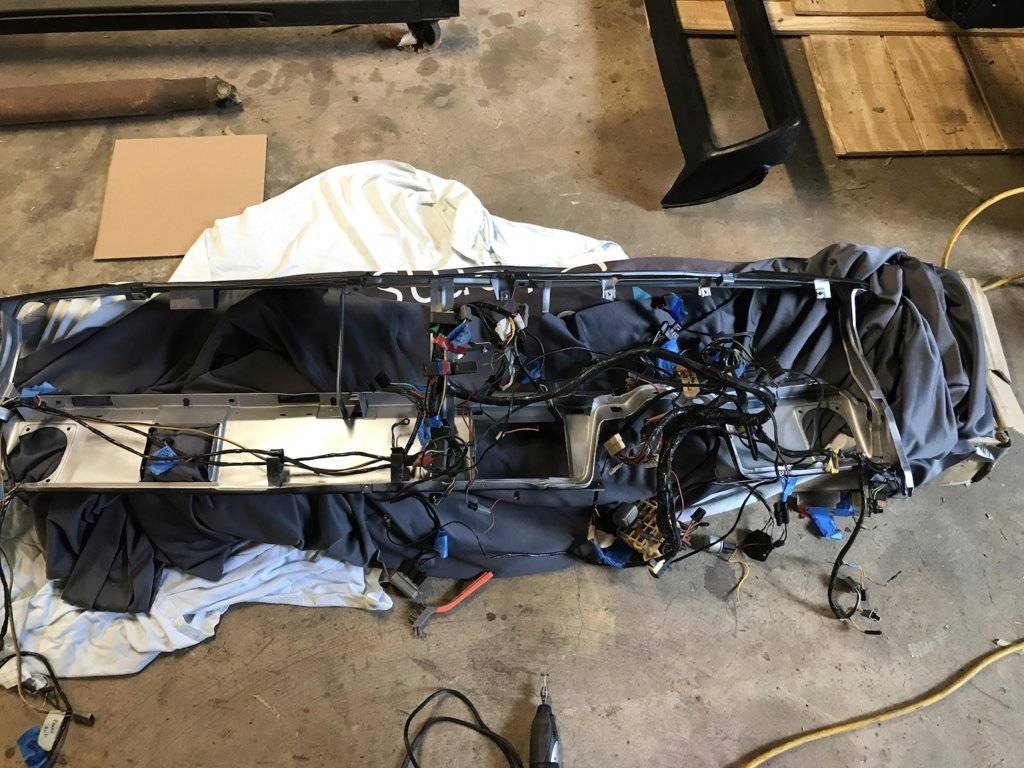

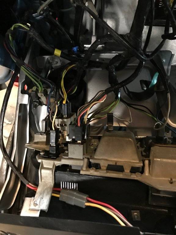

So I spent most of the past summer working the details of the wiring and the dashboard. I went through the wires best I could, replacing connectors, cleaning contacts and identifying what goes where. There are still a number of connections that I haven’t a clue about, but for the most part not so much a meaningless tangle of wires.
Refreshed cluster:

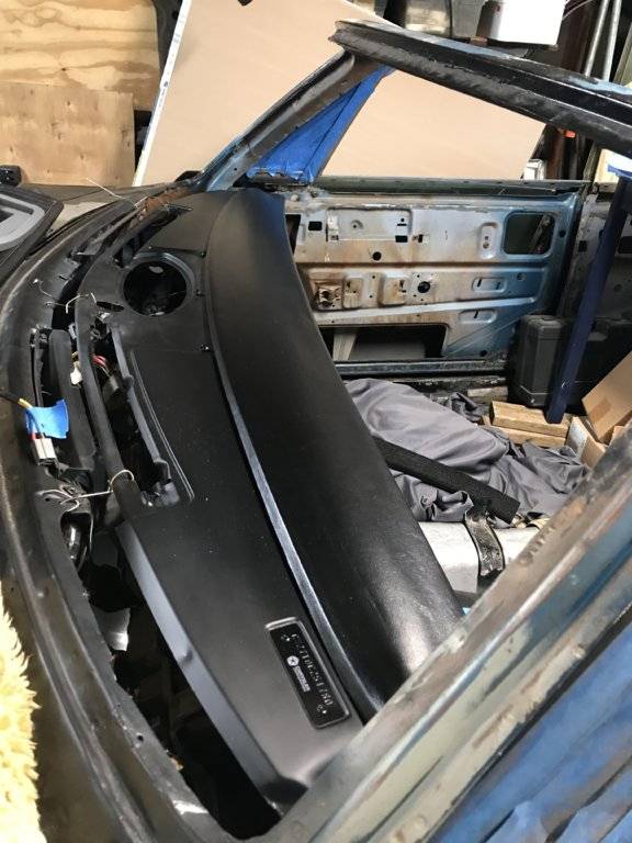

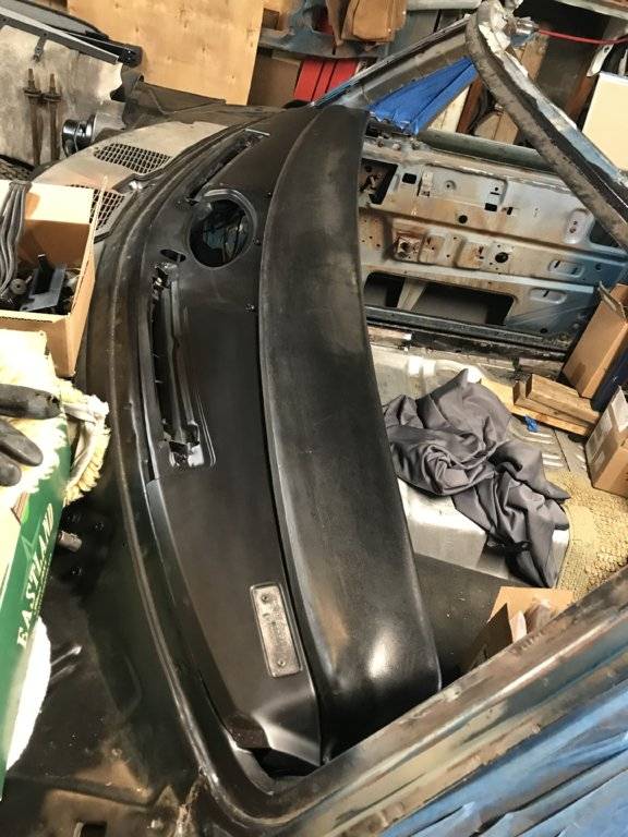

Of course after it was mounted back in place I was disappointed at how faded the dash pad ended up.

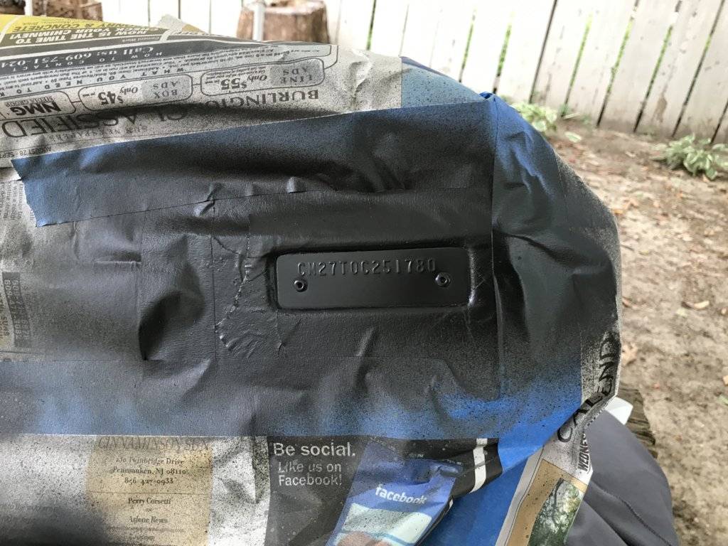

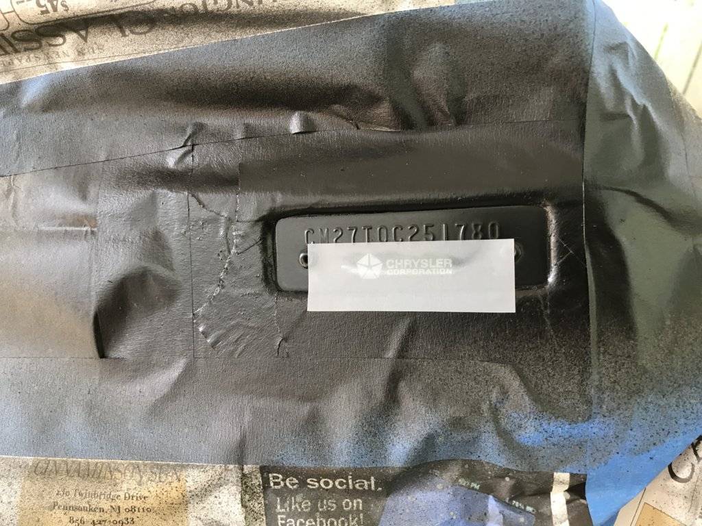

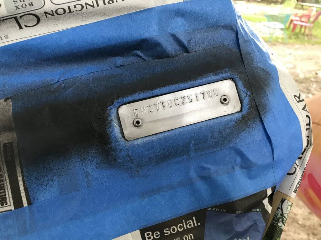

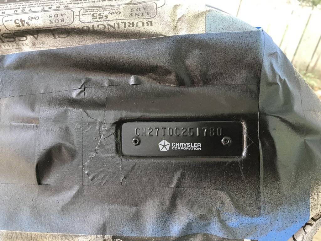

And the VIN tag was unacceptable.
So off it all came for a full SEM scrubbing and re-dye.
The tag was the easiest part. I carefully taped and then used acetone to strip the old paint. Semi-gloss from Krylon and the correct rub on decal from ECS finished it off nicely. No rivet removal required.

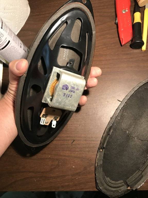

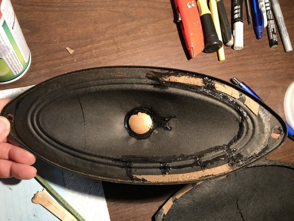

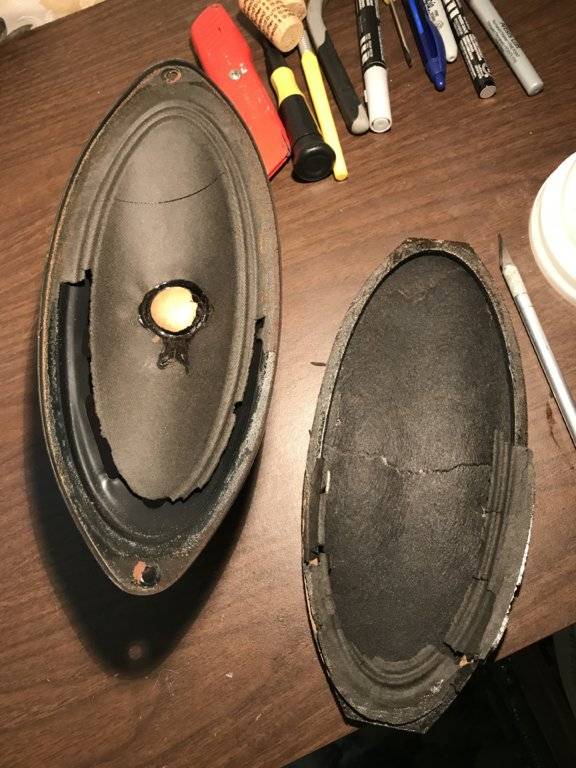

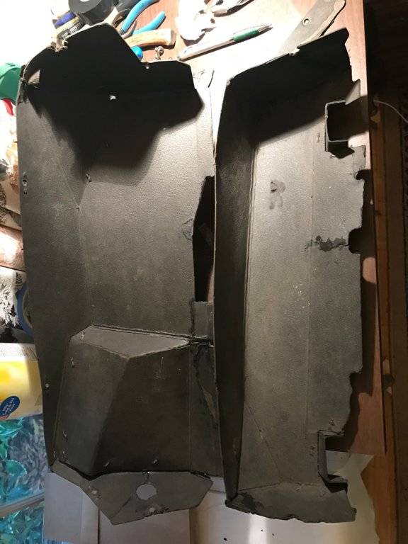

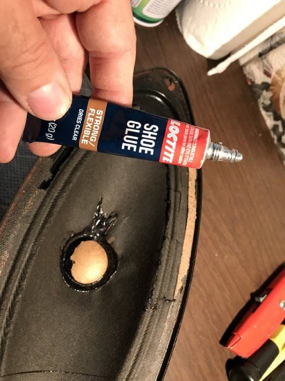

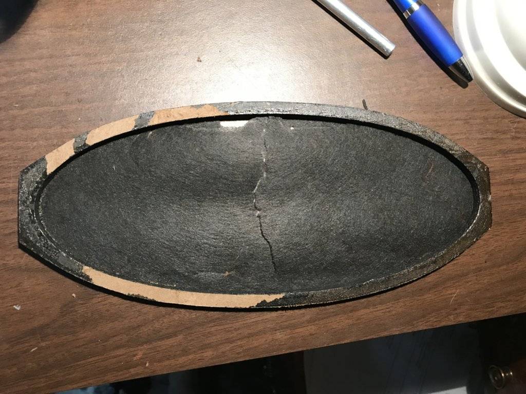

I then tried my hand at speaker and glovebox repair. The speaker is now usable, the glovebox liner not so much. Looks like I’ll go repro for that, the cardboard is just too brittle.
Nothing like the crappy sound of OEM.
Yes, that’s Shoe Glue, flexible and strong (or is that Strong and Flexible?)
Nothing like new sheer speaker fabric to finish it off.
Sorry, no after pic, but no one will see it anyway.
Not too shabby for four hours worth of work, LOL. Hey, it’s doing stuff like this that has kept the costs of this build reasonable (cost of my sanity, that is).
Unfortunately the glove box liner was just not worth the time and aggravation. Still doesn’t look too bad, just won’t bolt in anymore.
I’ll be getting one of these from Van’s.
Yes, that’s Shoe Glue, flexible and strong.View attachment 329354

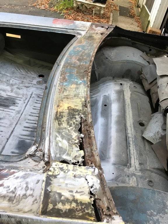

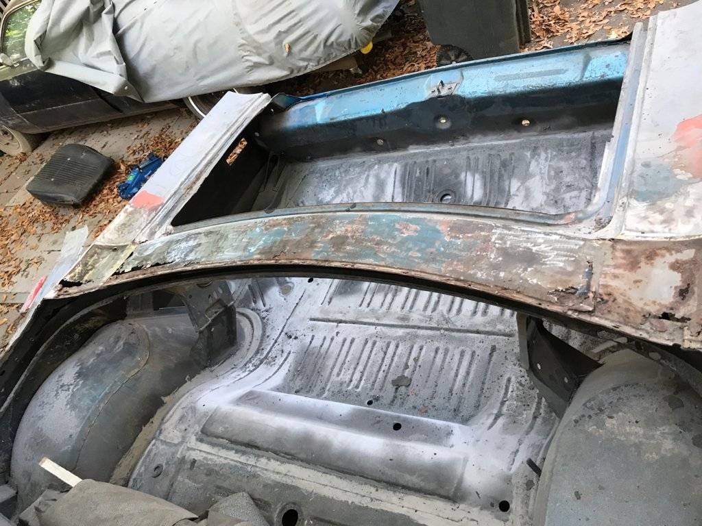

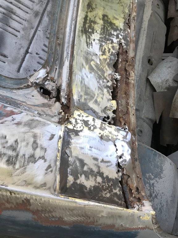

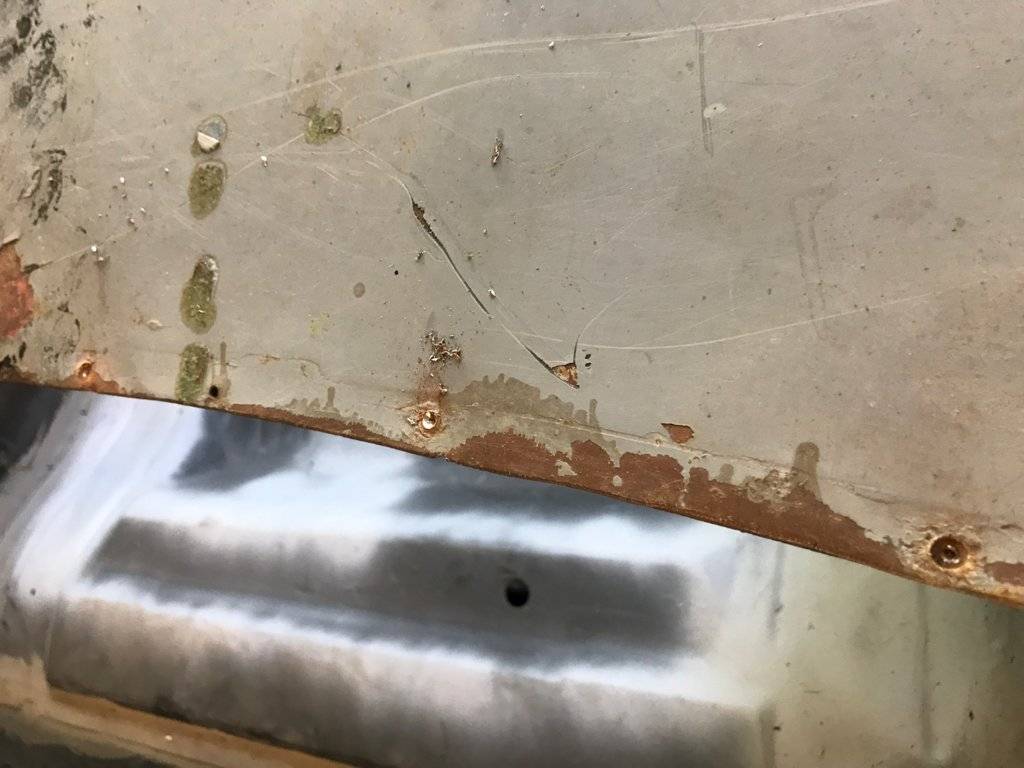

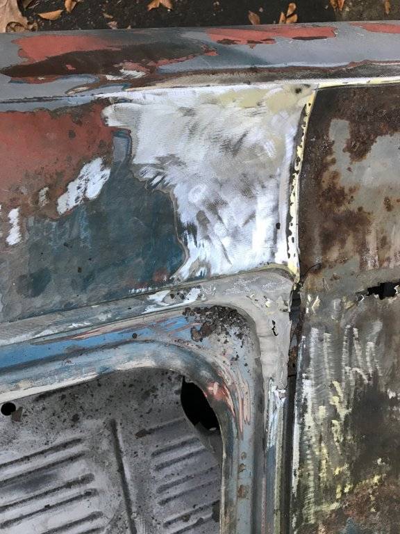

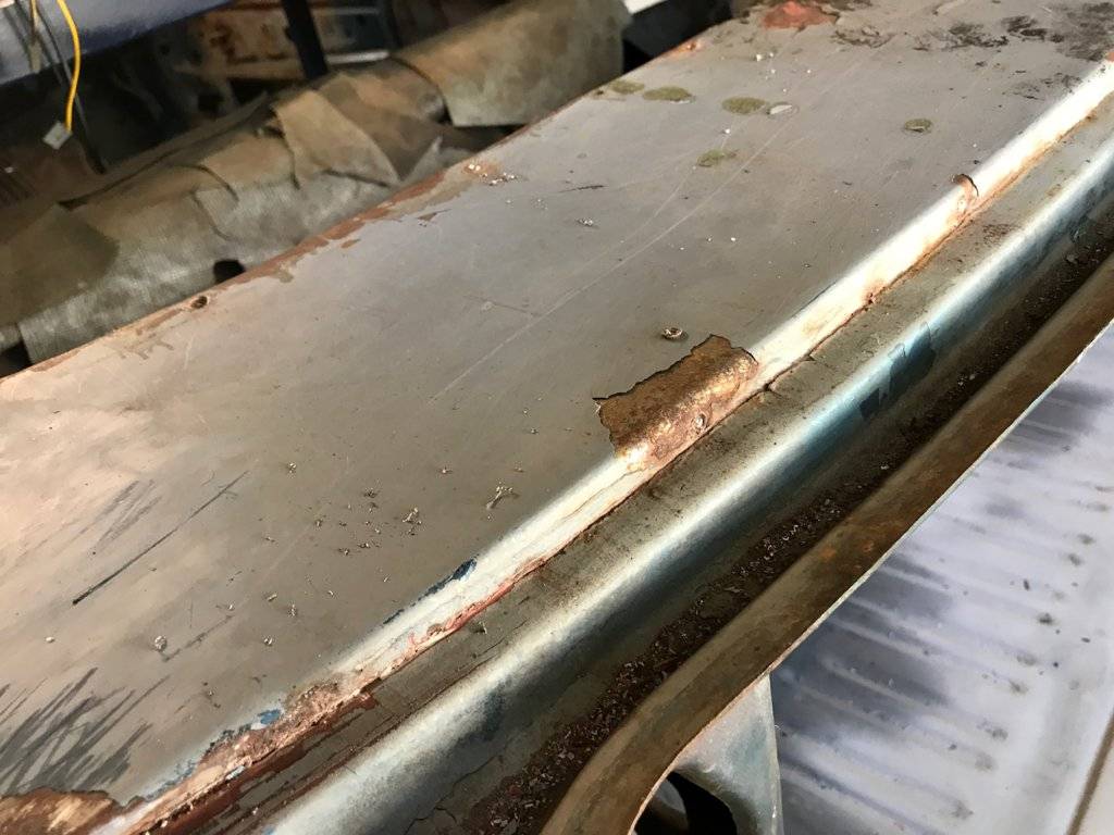

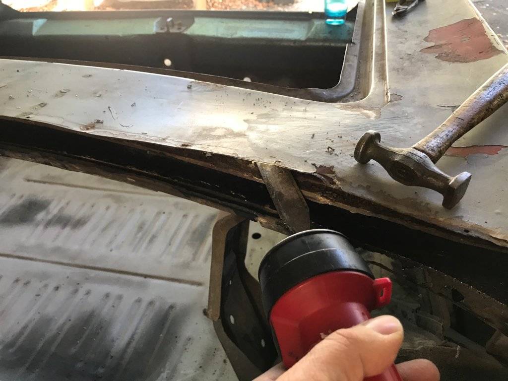

With all of this extra time on my hands I decided to take a look at the Dutchman’s panel. I knew from looking underneath in the trunk that there were some rust issues and sketchy repairs. A few years ago, the trunk hinge actually tore through the right corner gusset, so I knew that there was metal work in my future. Like an onion I began to peel the layers off and discovered some serious ugliness. Kids, this is no way to do auto body! Never pop rivet fresh metal over rusty metal and call it done!
Yikes!

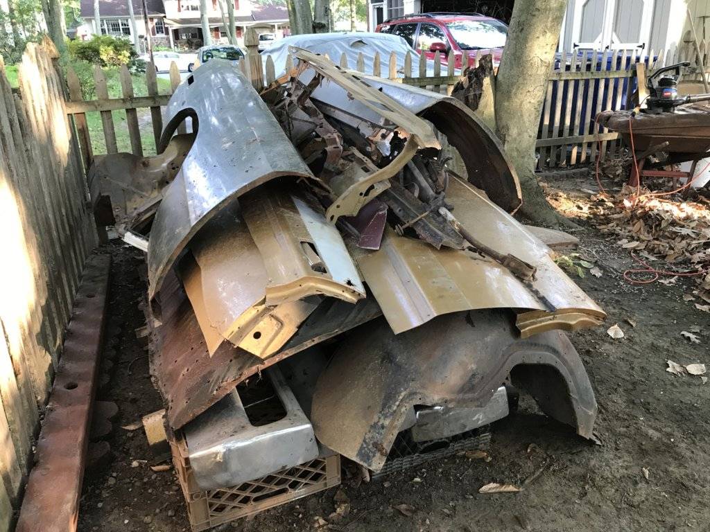

Off to the metal pile!
This piece from the ‘73 will fix both the gusset and Dutchman’s panel on the ‘vert and the rear window channel on the parts car!

I had thought about sourcing plastic sheeting or heavy, non-foam core cardboard, and then flattening out the original, doing the bends, etc., but for $39 bucks from Van's seemed to be a no-brainier. The trunk dress-up like the Imperials would be a fun "after it's done" project, so I'll keep hunting for appropriate materials and patterns.

The dash looks great. It sure is convenient having the metal pile to, huh.
Thanks! I was very happy with the SEM system. I plan on using it for the interior panels as well. Yes, my mini junk yard has come in handy. It's amazing how much sheet metal one parts car can produce, but I plan on using every bit of it when I dive into the black car.
