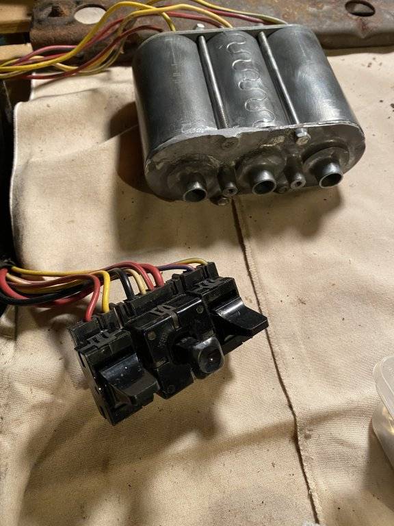

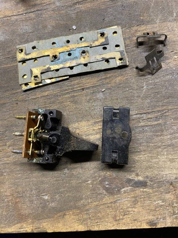

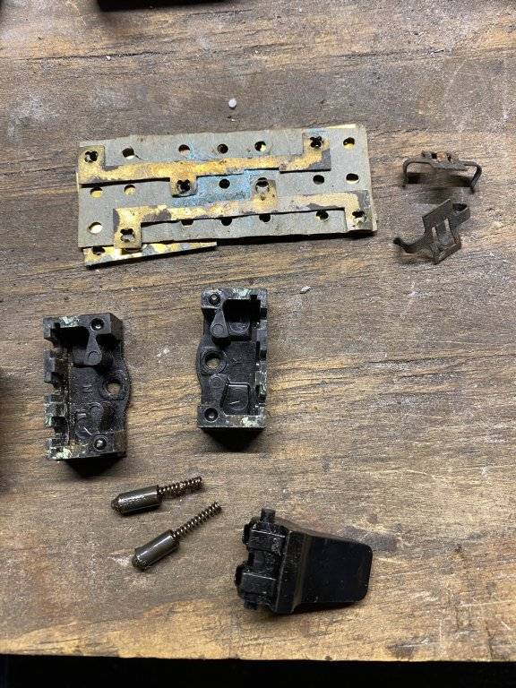

Thanks! I always try cleaning and fixing first. So far I’ve only destroyed the power antenna, but was lucky enough to find another working unit.that repair work on the electrical components is awesome to see. people are so quick to dispose of things that look bad but in reality have simple problems and can be repaired with a little effort.

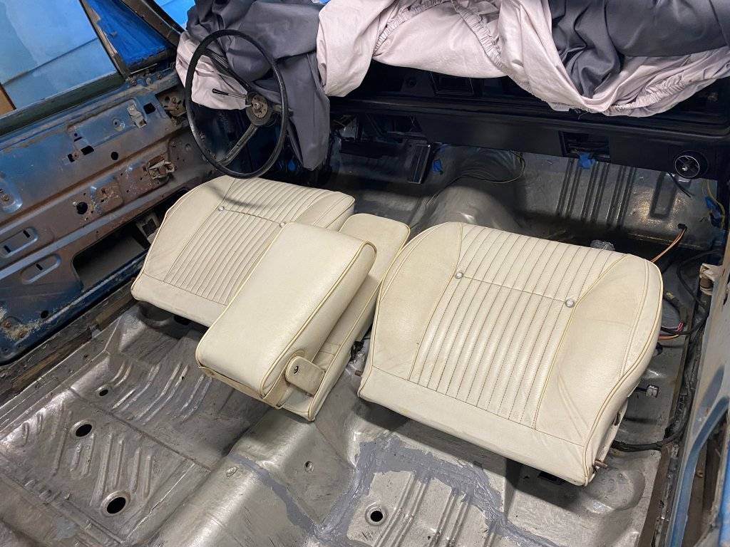

Cool!For seat covers, check Dante's Mopar Parts.
They usually sell the Legendary covers for a lot less than getting them direct from Legendary.

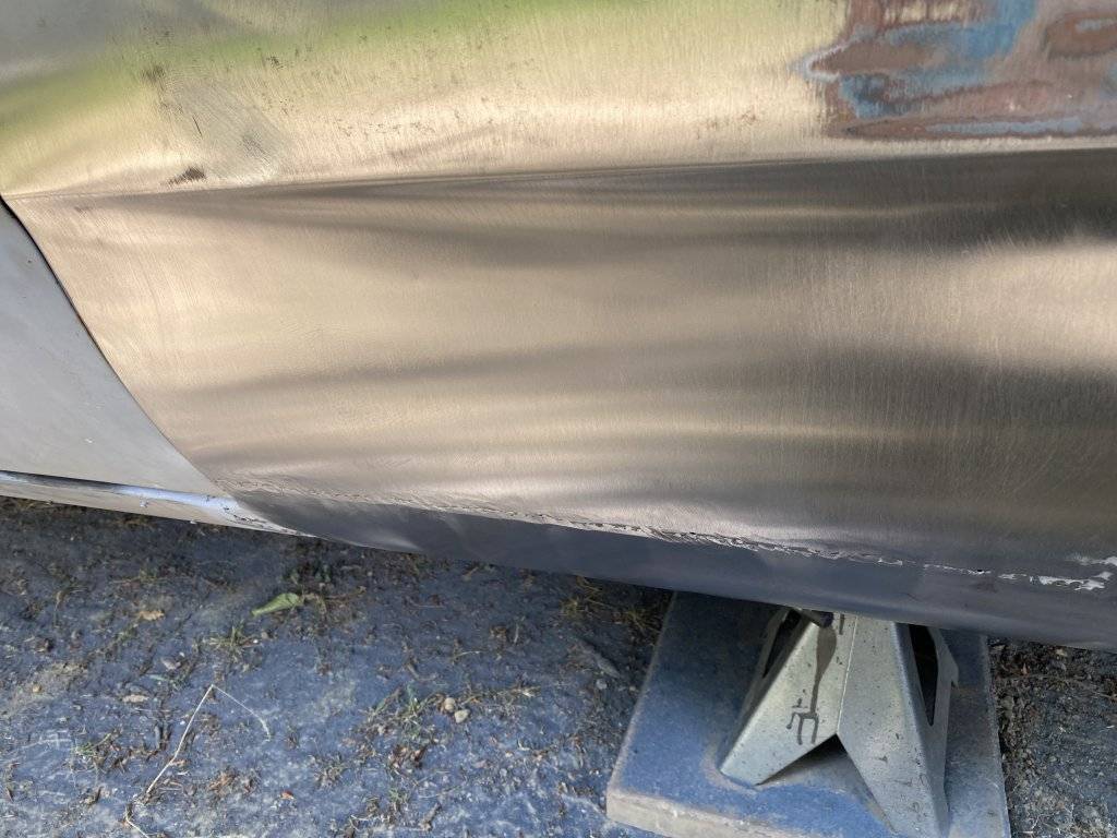

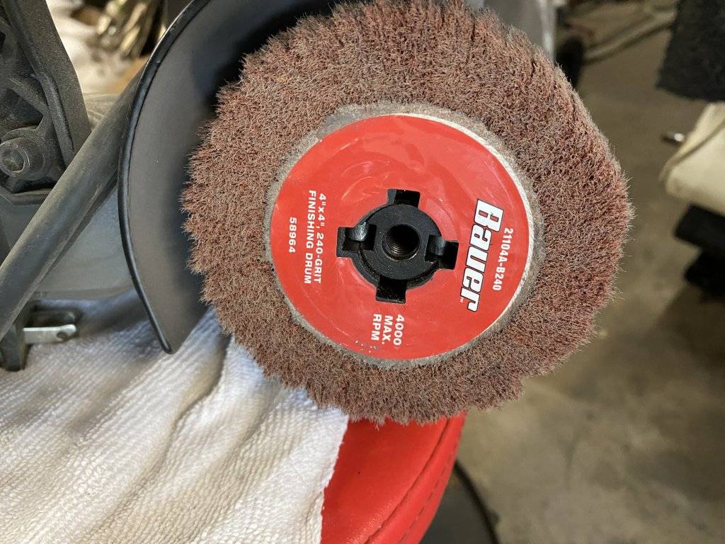

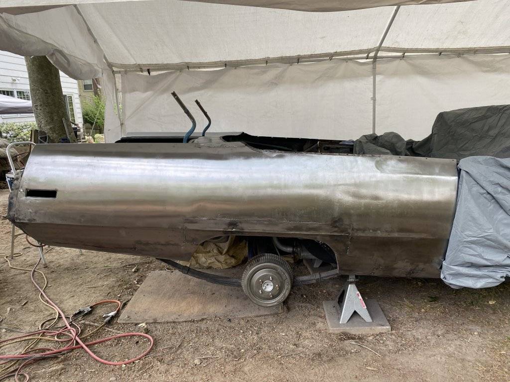

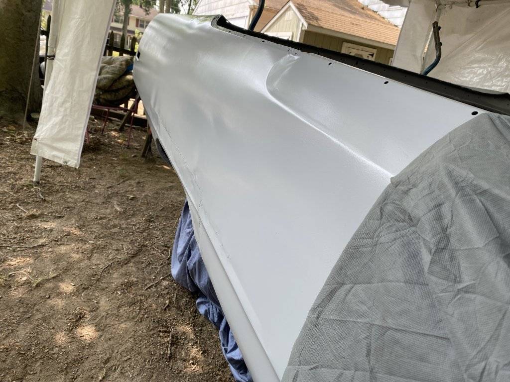

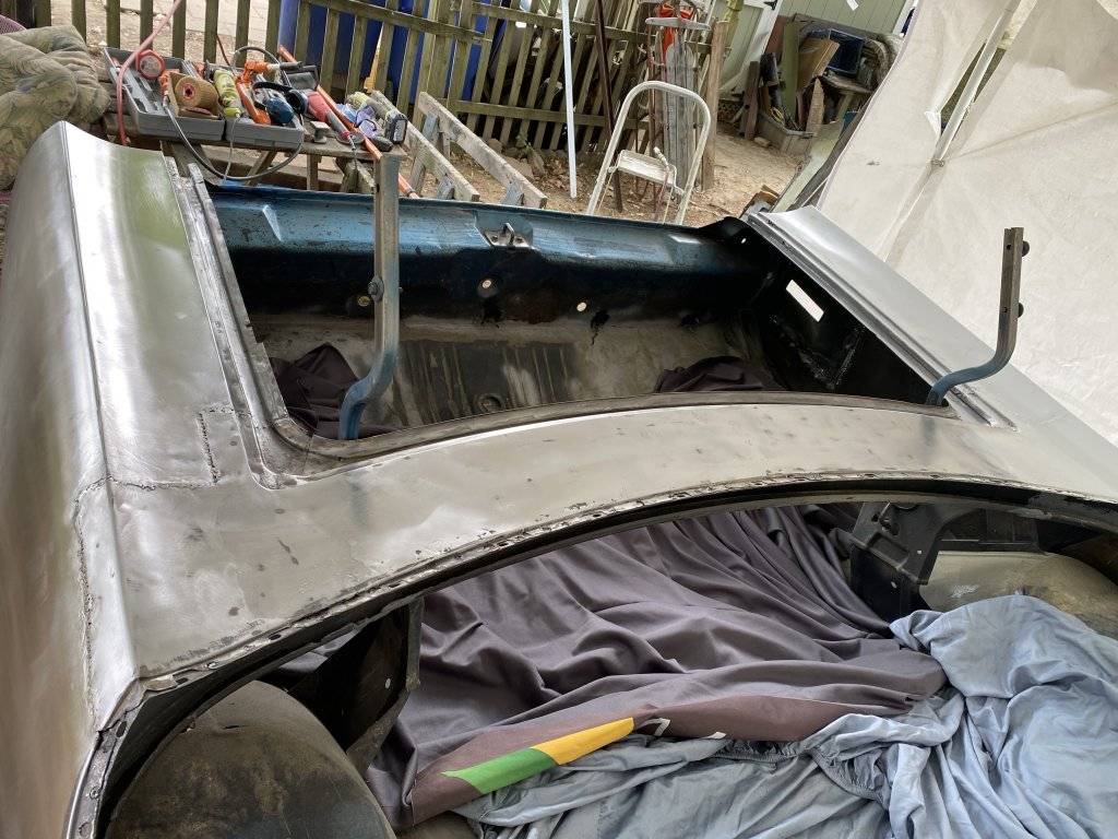

Everything I've seen says the Harbor Freight version is just as good at a lower price.Then I discovered the SCT (surface conditioning tool) from Eastwood. Harbor Freight had it for half the price and it did a spectacular job.
I used the 40 grit stripping drum to get paint, primer and old bondo off, then the 240 grit polishing drum. There is a 120That debrider tool sure leaves a nice finish. What type of abrasive is it .... or sandpaper grit equivalent?
Looks like a scotchbrite type of medium......I used the 40 grit stripping drum to get paint, primer and old bondo off, then the 240 grit polishing drum. There is a 120
Intermediate drum with these goofy metallic “leaves” which didn’t seem to do much, so I went from the 40 to the 240 with good results.
View attachment 601309View attachment 601310
Do those last a while?I used the 40 grit stripping drum to get paint, primer and old bondo off, then the 240 grit polishing drum. There is a 120
