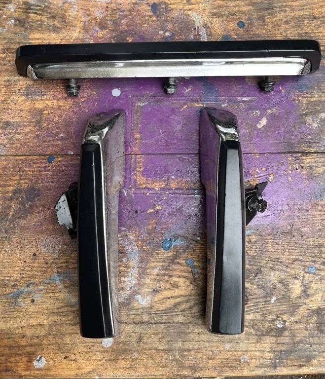

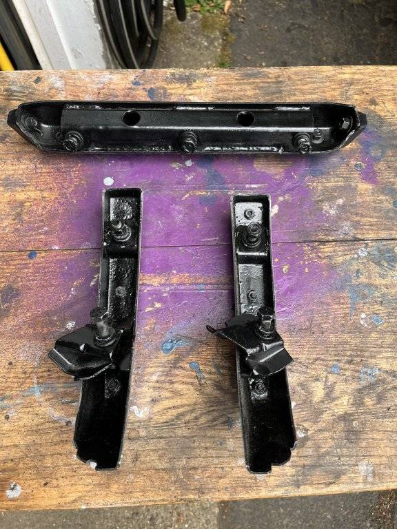

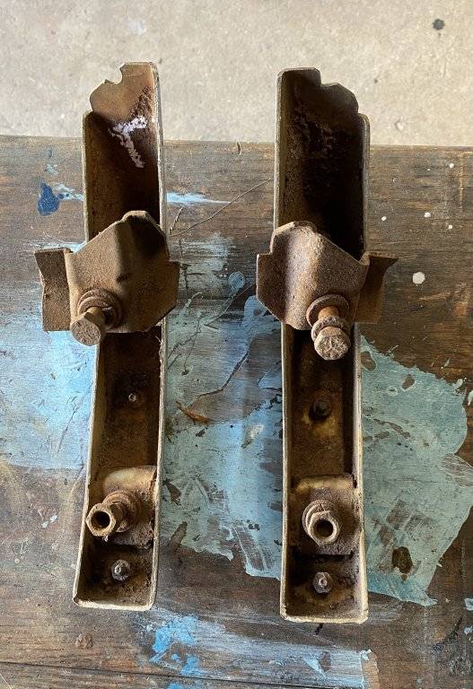

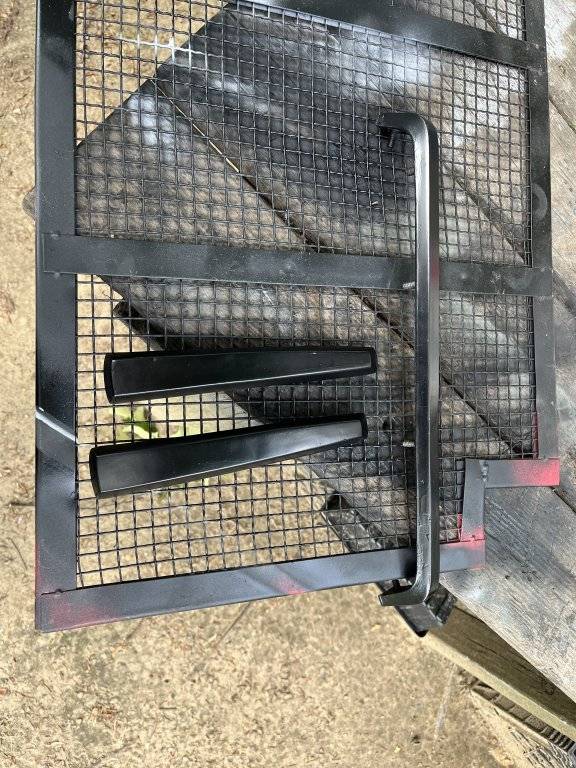

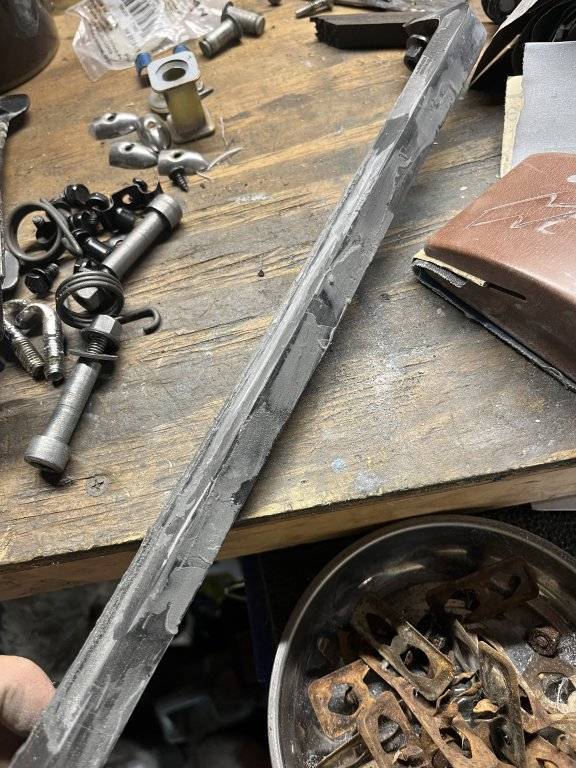

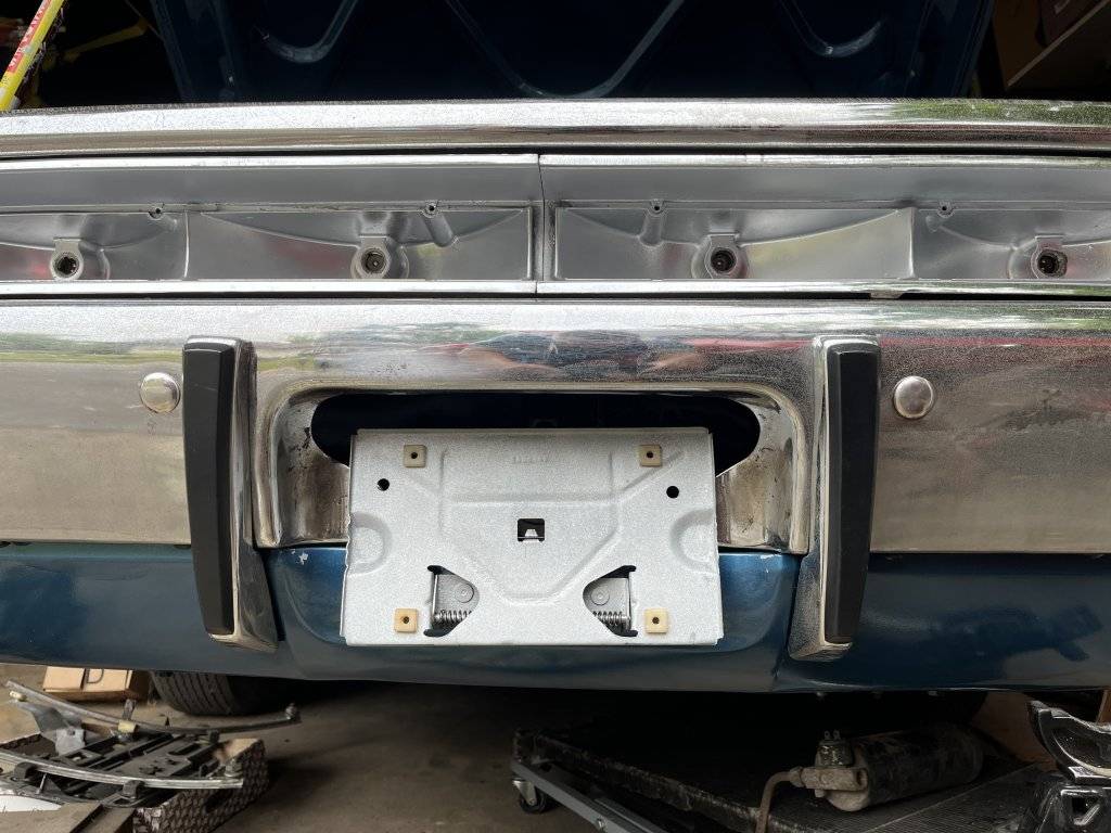

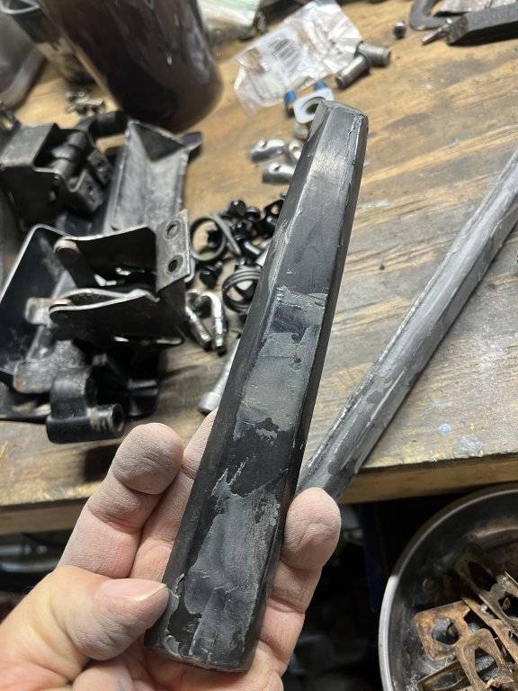

I always liked the small bumperetts and the bumpers had the holes so I’m putting them back on. Not willing to pay hundreds for NOS pieces, I decided to patch up the rubber and repaint with some satin black. I don’t remember how these came off, but getting them back on has been a challenge. Top bolts, no problem, but there is no second hole for the bottom and I can’t figure out how to position the strange looking brackets.
JB Weld Epoxy:

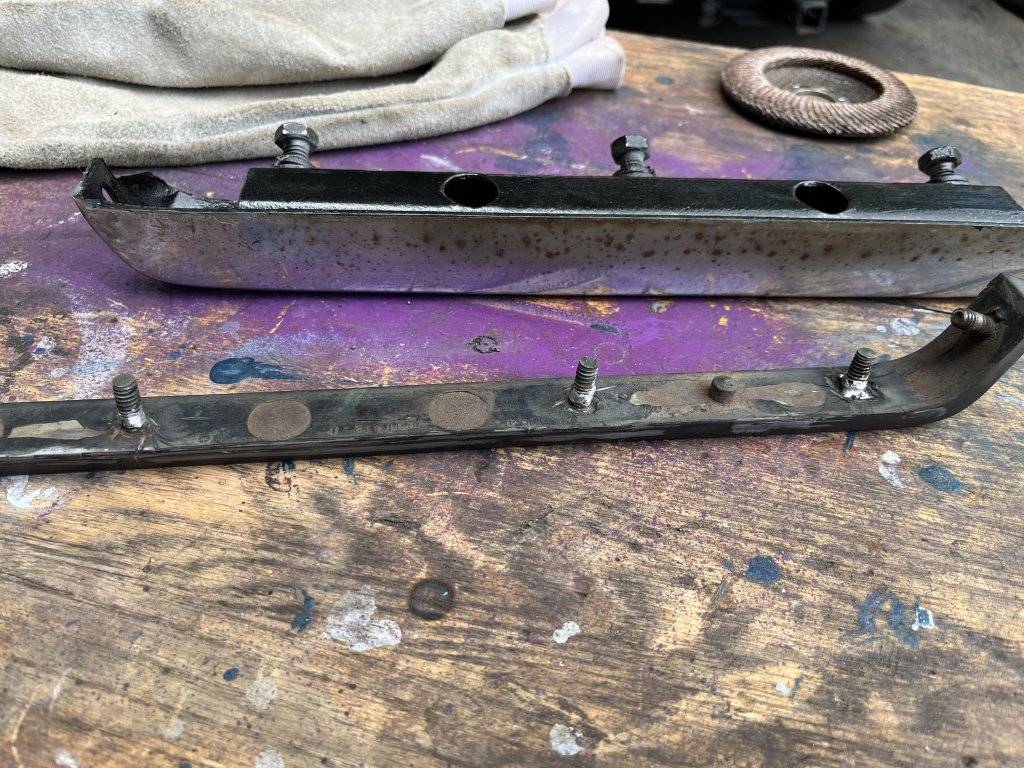

Of course the studs broke off. Time to break out the welder.

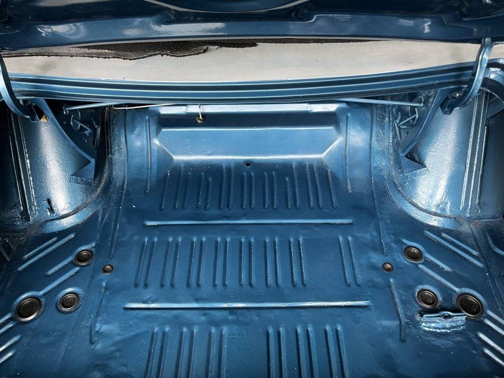

Also did some more detailing in the trunk with the new body plugs. I’m on the fence with the splatter paint, but I do have a new rubber mat from REM.
JB Weld Epoxy:
View attachment 667922View attachment 667923

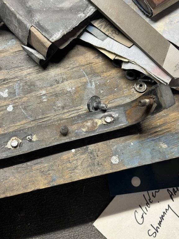

View attachment 667924View attachment 667925View attachment 667926View attachment 667927View attachment 667928View attachment 667929
I painted my trunk body color except the quarter panels already had good spackle paint

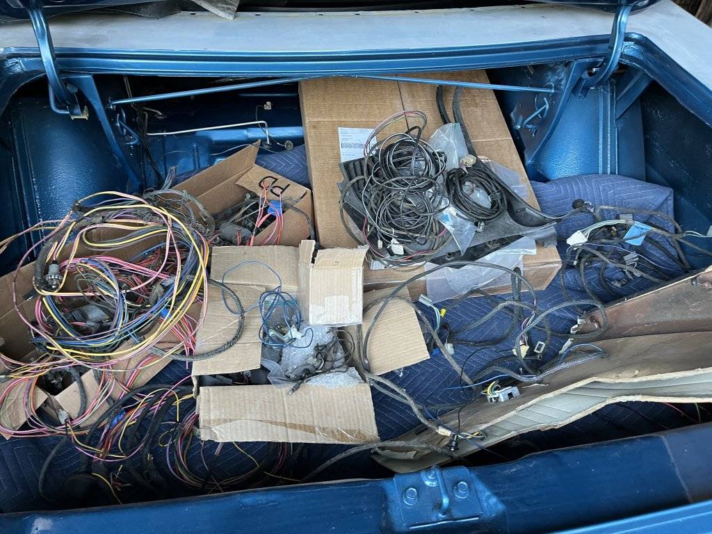

James, when I did my Superlite install the service manual was invaluable. I couldn't have done the wiring without it. I presume you have one.
Seeing the rest of the car I'm certain you'll be fine.
My advice is to make photo copies of the FSM wiring diagrams, that way you can mark wires etc while you work.
At least that's how I do harnesses following the KISS method..
You're really making me want to work on my Ragtop, I've had it 12 years in August.
Print big copies of the electrical diagrams. They show the shape of the connectors, color of wires, size of wire, how many wires.
I do the same, except I just print out from the downloaded FSM on MyMopar. Just highlight the wire runs and it gets a lot simpler. The '70 FSM has some decent harness locations shown in the electrical section too.
