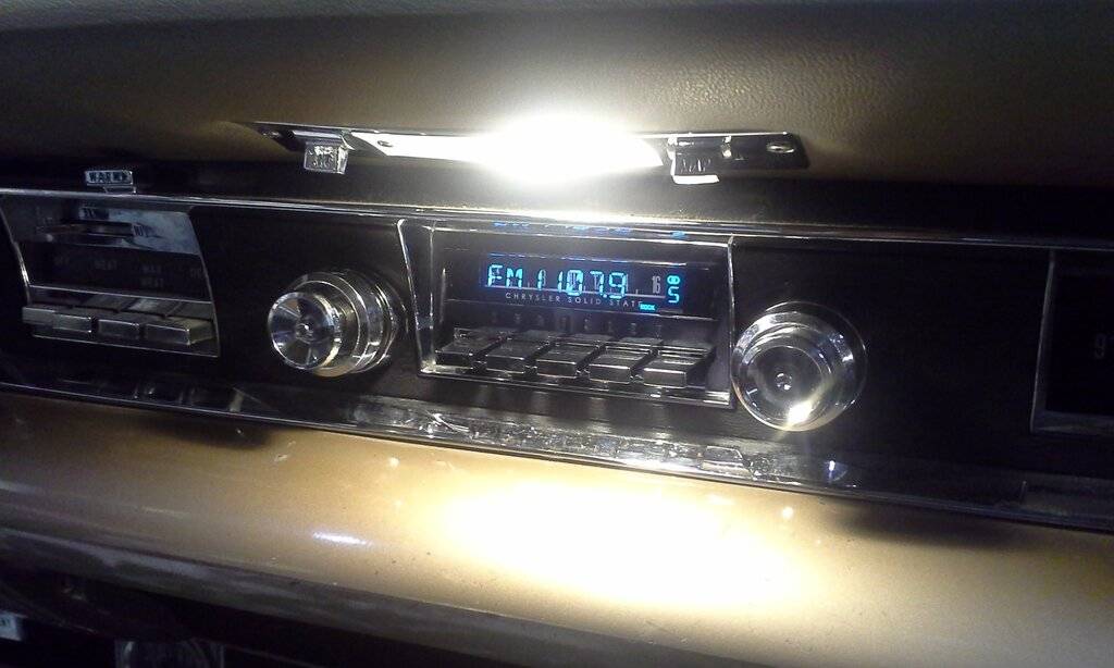

I put a Retrosound Redondo in one of my '66 Chryslers. I was able to use the factory radio knobs and it looks completely stock when it's turned off. I also bought a USB and AUX extender from Amazon and routed the wires into my center console so they are hidden. I'm very pleased with it.
I bought mine from Amazon, which was a lot cheaper than ordering from Retrosound's website. According to the bill, the model number of mine was "RED-S-282-12-82". RED stands for Redondo model. I think the "S" means shafts, as opposed to the thumbwheel controls which are also available. The 282 I believe is the model with chrome buttons. The buttons may be chrome or black. For an original look I wanted the chrome ones. The last two numbers indicate the knobs that it comes with, which you don't care about if you reuse your original knobs.
I found some pictures of my installation. Retrosound sells some screen protectors with a fake analog dial printed on them to make the radio look even more convincingly original.

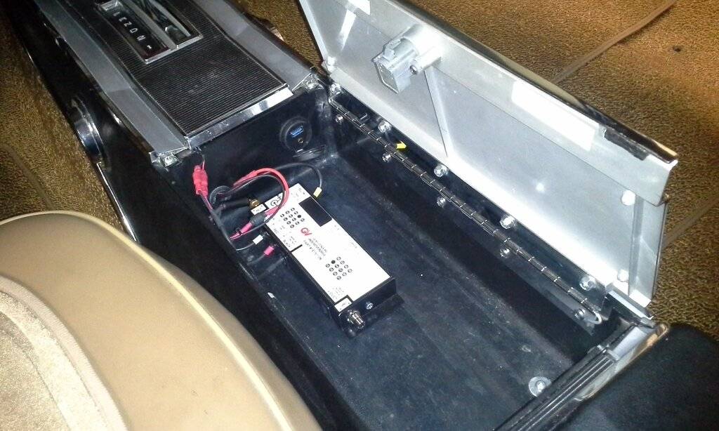

Here you can see the AUX and USB hidden inside my console.

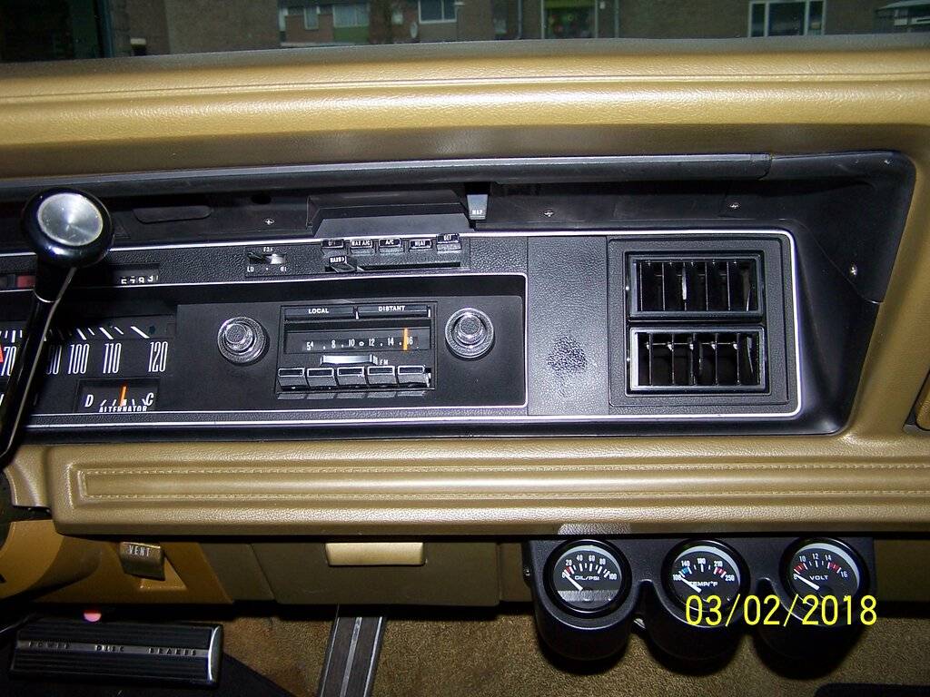

i went to garytayman.com, sent him the original radio and he digitalized it. works great, has am-fm Blue tooth etc. it's the right way to go if you dont have a flat dash.View attachment 500013
Someone else I was talking to on a C-body FB group said that they got a Redondo to fit in their 67 or 68 Chrysler. They didn't provide any details, but you'd need to use the chrome bezel from the tuner face of your original radio.
dont know what to say. i installed the retro like they said and face and tuning wheels were back behind my original facia plate. the original after Taymon converted it worked like a charm. the picture is exactly what i have.

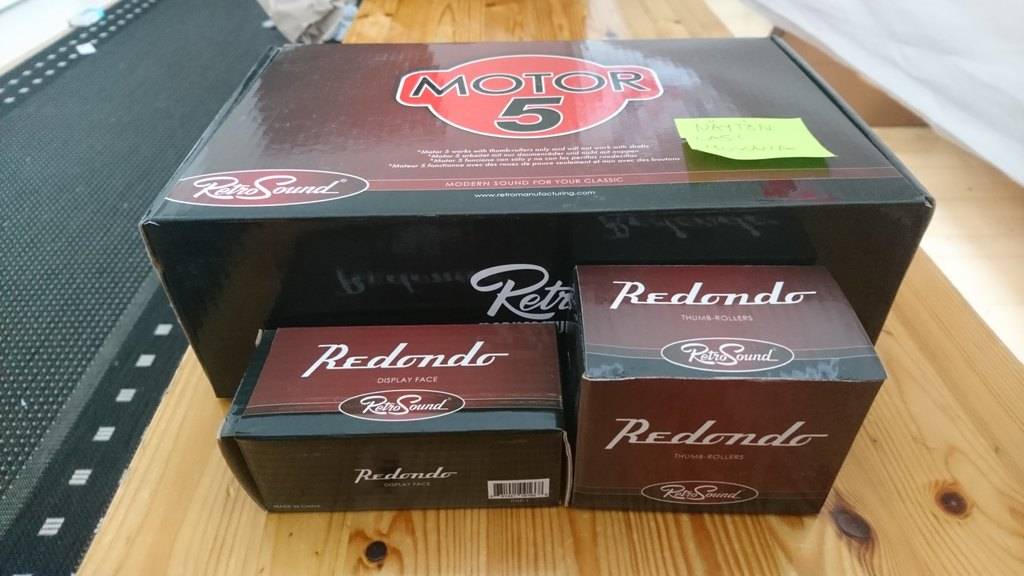

We have a distributor of RetroSound here in the Netherlands so that's no problem.

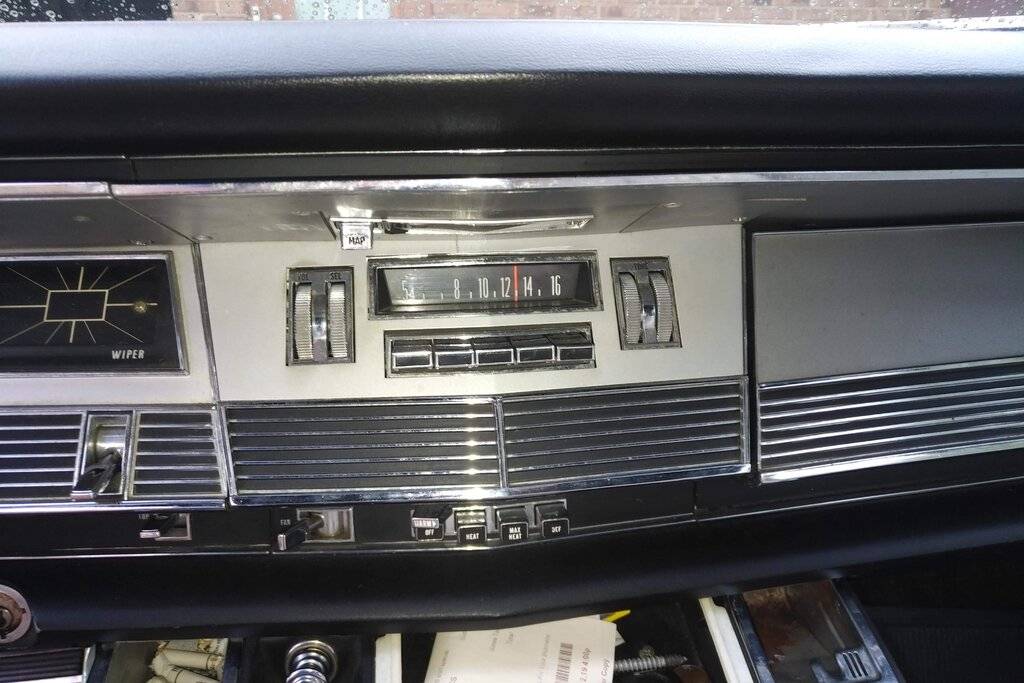

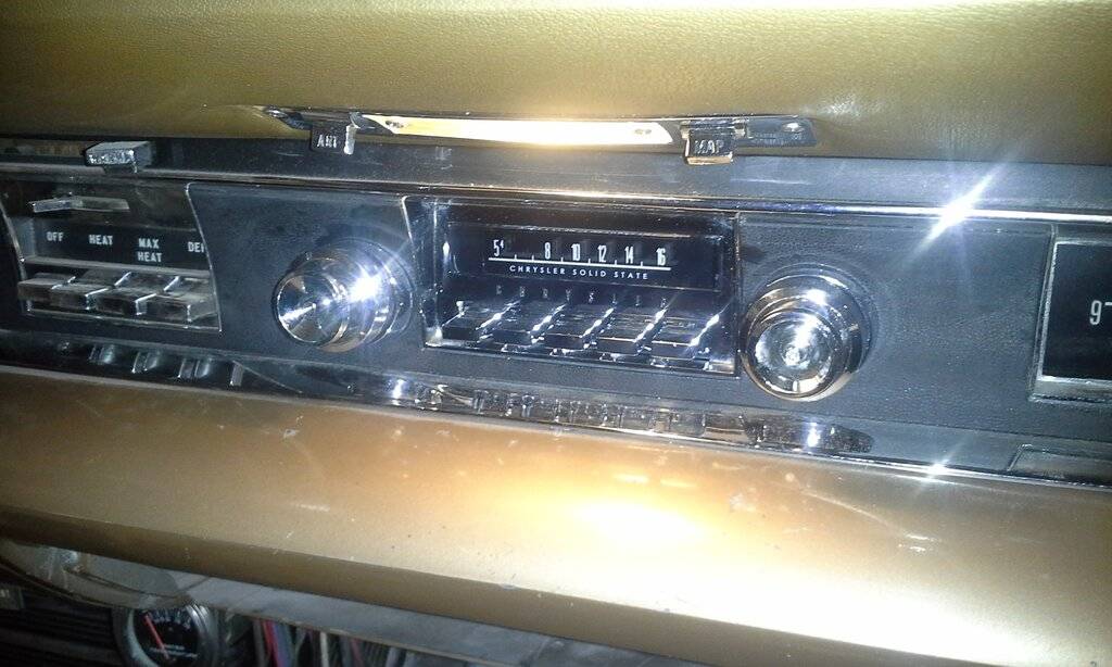

This is the, not working, stock radio:

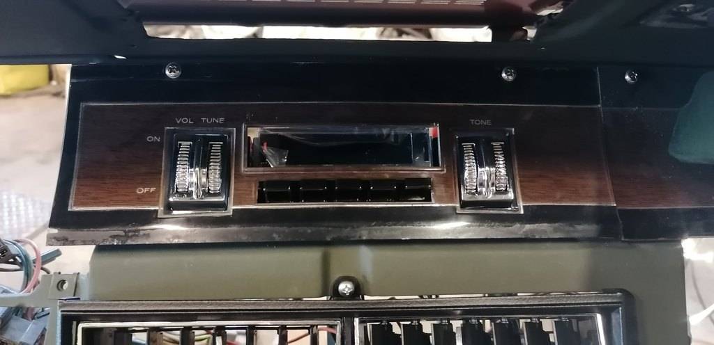

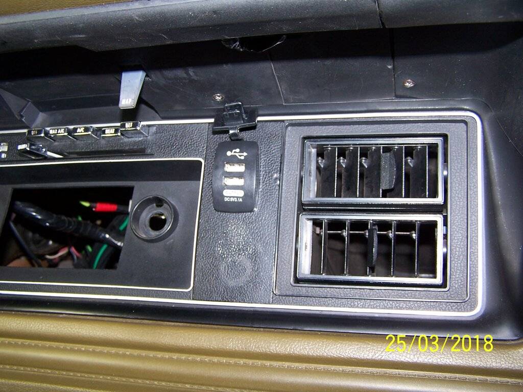

And this is the hole to fit the new radio:
It will be a puzzle to find the right bezel for it. I want to use the knobs of the old radio.
