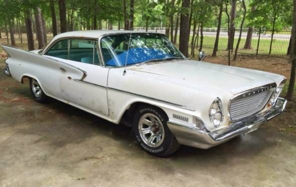

Well the weather has finally given me a break, so finally getting started on my '61 Chrysler Newport 2 Door Hardtop!!!!!
My family owned a '61 4 door with 361 and 3 speed manual tranny. It was delete of all options, radio and carpet (ie: rubber floor marts) included.
It would fly though. My dad took it in for a tune up, one time, and when the mechanic brought it back from the test drive, he told my dad "Brother Carrico, that Chrysler will roll!!"
It's the car I learned to drive in.
I tried, in vain, to get my old car back a few years ago. The trail went cold in Richmond Virginia. I was told that the owner there, had parked it in an abandoned lot and died afterward. The car sat there a long time until the city came and hauled it off to the scrap yard. Broke my heart to hear this.
Fast forward a few years.
I went on a quest for a replacement and found this car outside if Houston Texas. Ot had been in a garage for almost 30 years. I bought the car and went after it.
My son and I pulled out of our driveway, in WV, at 2:30 PM on a Friday. We were at the pick up point at 8:30 AM on Saturday morning. Arrived back in WV at 6:30 AM Sunday morning.
Was going to swap the tranny to a three speed manual, but due to the '62 manual I had and trying to put it into a '61, it has become to big of a headache to do at this time as I want to drive the car this summer. I do have a low mileage 413 out of a '59 Imperial that is going in. The 361 runs just fine though.
Did I mention that this Newport is an air car!!! Can you say bonus !!!!!

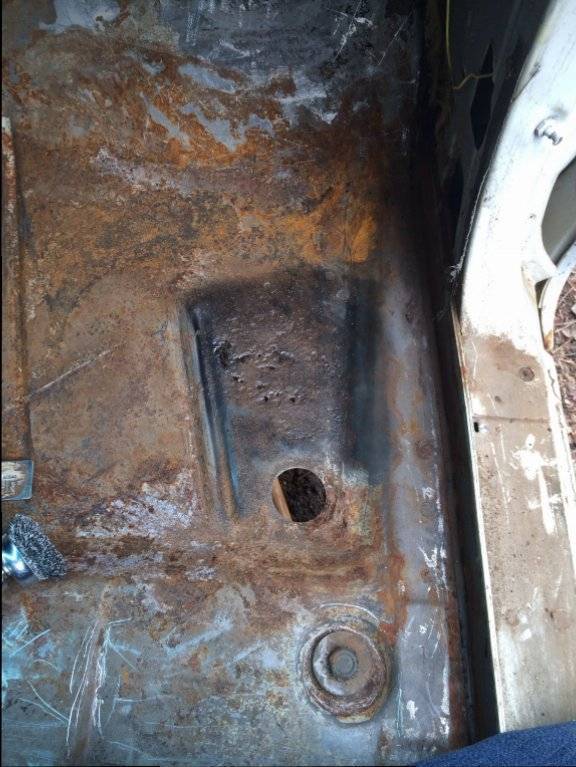

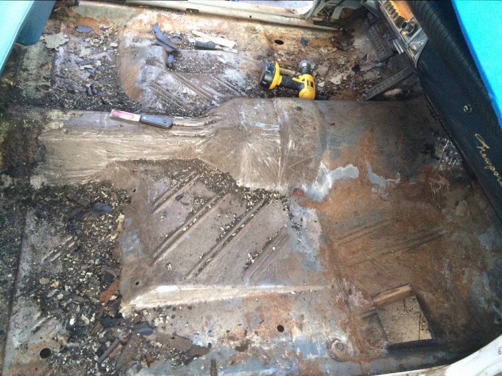

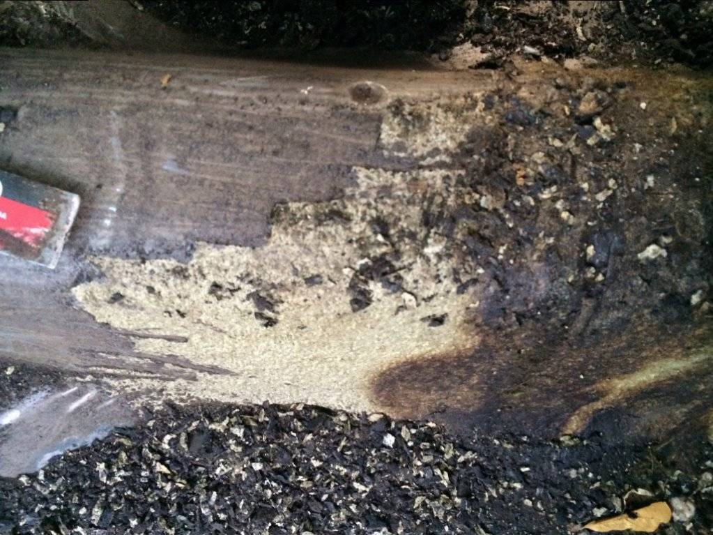

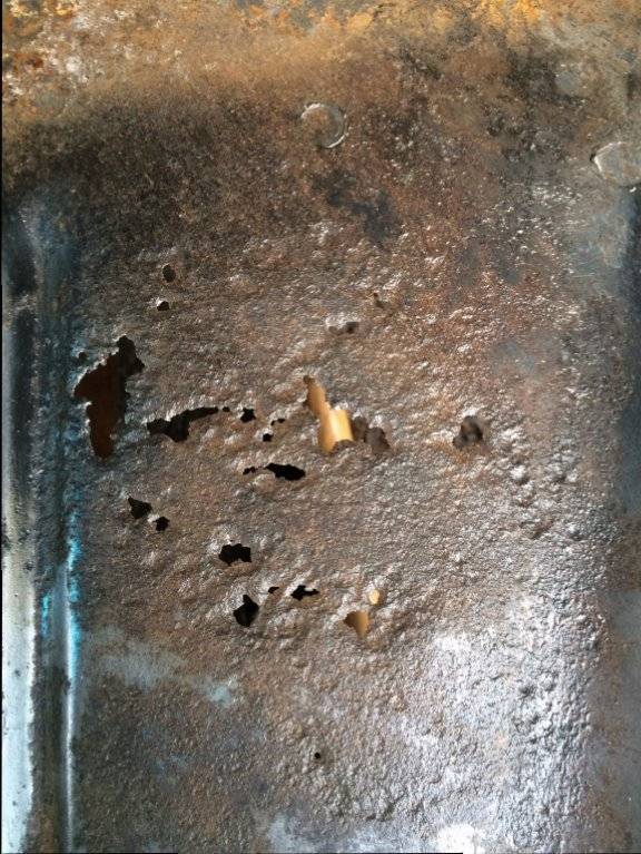

Today I pulled the seats out and all the carpet. Scraped all the sound deadner out. What a chore. Found one minor rust area about the size of a dollar bill where the passengers right foot would set. Cut it out and formed a replacement panel to yet be welded back in. The rest if the foot is as good as the day it was built. Still can't figure how that one spot rotted out. Oh well could have been worse. Tomorrow I'm going to redo all the seam seal. After that cures I'm going to paint the entire floorboard with two coats of pour 15. Plan to do the entire bottom if the car with it too.

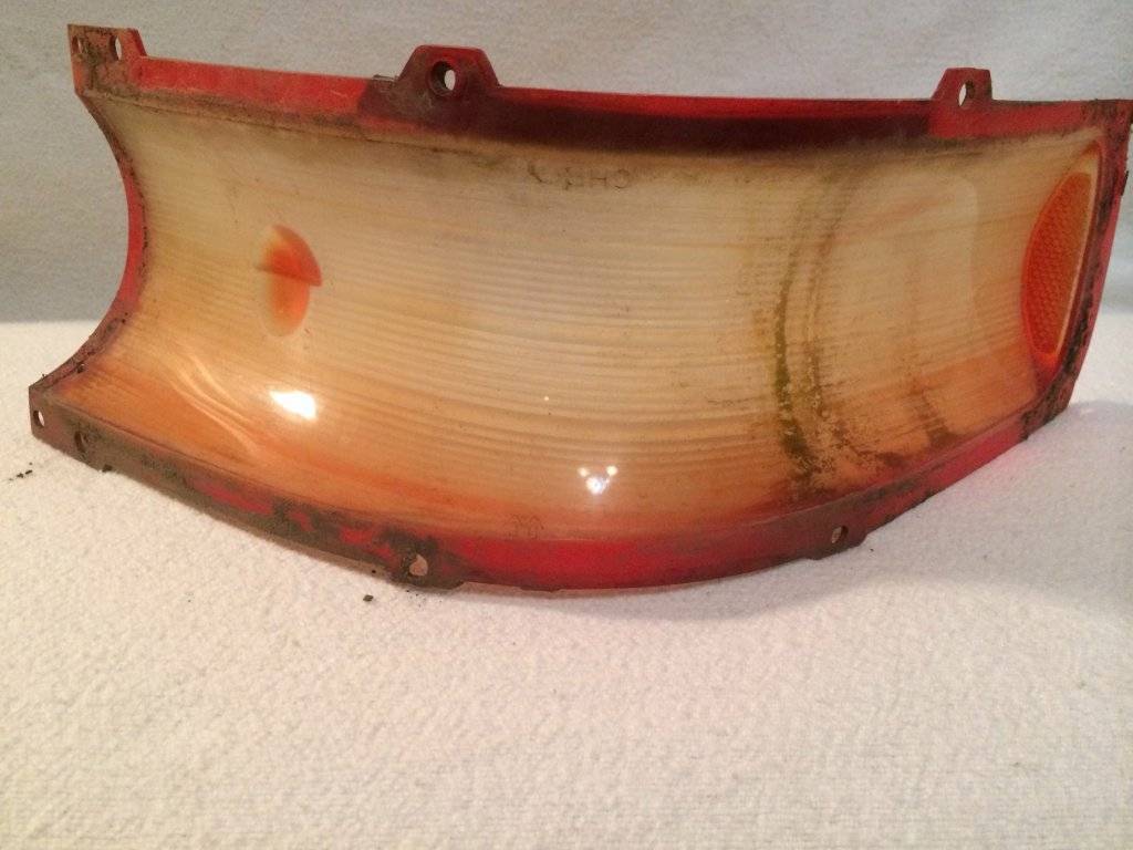

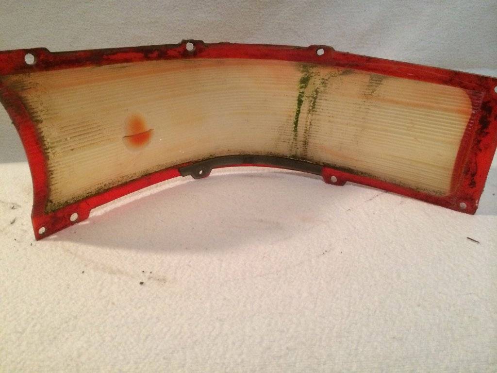

Was going to convert to '60 tail lights as I love those big boomerangs. Wish Chrysler had left that alone for ' 61. Oh well, too far out of the budget for that now. So, now my left '61 tail light has really faded out. On a quest for a replacement left tail light lense. Right side is perfect.
Rust out in that seat frame pocket on passenger side most likely caused by leaky-malfunctioning heat control switch up high behind the glove box where it comez thru' the firewall. Jeff Carter Restorations up near Seattle will fix you rite up on an exchange basis+$ of course. BTW, He'z your man for dash gauges and the power pack for the electrictroluminessent litez in your dash too
Well, that makes sense. The floor pans are awesome all over except that one little spot.
Thanks for pointing me to Jeff. My dash lights up and then dims out to black. My reading points to a bad power pack.
If you have a lot of "good" paint on the floor, POR15 may be a bad choice since POR15 bonds to the rust, not paint. I sand blasted my floor paint off, then wet it down to flash rust the surface before I brushed on a coat of POR15. Lot of work, in hind sight, maybe POR15 the rusty bits and epoxy prime and paint the whole thing body color. That's a sweet looking car!
Nice car, good luck, I put my rambling 2 cents on brakes on your other thread.
I agree with Fury440 POR15 does not hold to bare metal very good, bonds to rusty metal best.
Thanks for the por15 info. There was no paint, to speak of, under the sound deadner the factory had sprayed in. Some of the spray on stuff came right up, very easily, some was tighter than a gnats butt stretched over a rain barrel. I'm going to let it flash rust and then por15 over it. I really like that stuff and have used it a lot.

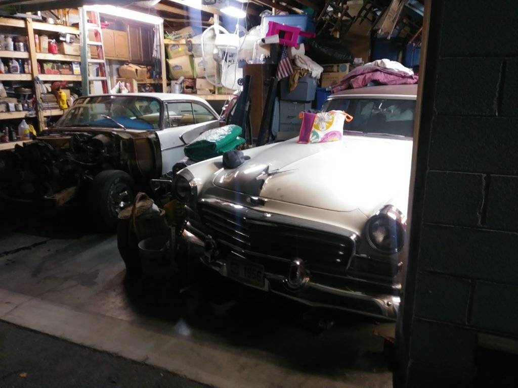

OUR FAMILIES OTHER CHRYSLER RIDES !!!!!!!
The '26 Dodge business sedan has been in the family since 1974. It's our first restoration attempt. Dad built the wood frame for a new top. We put wire, padding and then the new top material on it. Our mom sewed up and helped install the mohair interior. We took the body off and use a frame paint similar, to today's por15, on it. We did all the body work and paint ourselves. That was about 30 years ago. Motor and tranny have never been apart in 90 years, to the best of our knowledge. It can set for months, in the trailer, and start right up. Our 95 year old WWII Vet dad, drove it in the Veterans Day parade last year!!!!!
The '56 Windsor is a special edition 250 V model. It has cloth and vinyl interior and a four barrel 331 polyhead motor from the factory. It is an all original 64,000 mile survivor. I bought it for my dad for Christmas 10 years ago. His first Chrysler was a '56 and he always missed that car. It was a very special Christmas morning at our house that day. The car was nice enough, in as found condition, to win best antique at last summer's AACA regional event!!!!!
Before and after pictures of my faded left side tail light lens!!!
Nite Shades red tail light paint. Worked great!!!

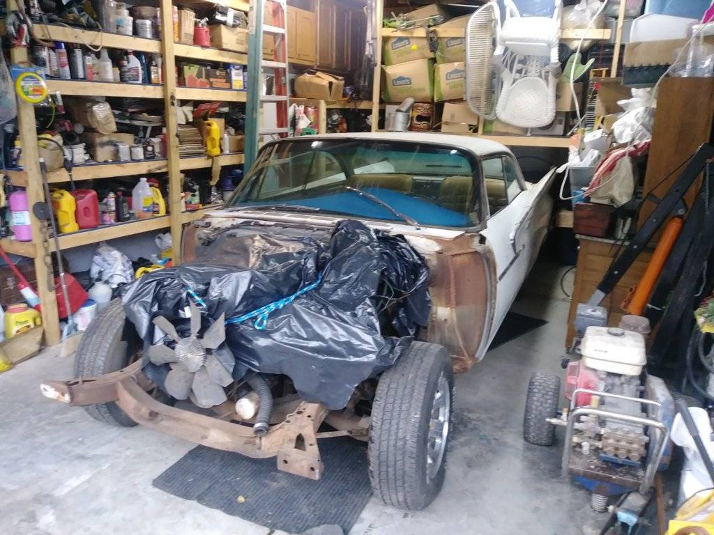

Well, after a long hiatus, I'm finally trying to get back on my '61 Chrysler. I have spent a lot of time in Florida working. I've got the engine and Tranny ready to come out. Two or three more bolts out of the motor mounts, and they'll be swinging in the air.
