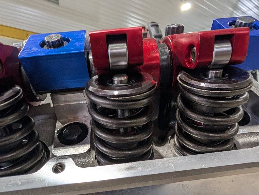

I purchased Speedmaster aluminum heads 3 years ago and the rocker arms recommended for them. I will list the part numbers Heads: PCE281.2140 rocker arms PCE261.1186. The issue is the rocker arms do not fit. The outside diameter of the springs are 1.55 inches. Here is the picture of the problem: The one on the left does not fit. If you look at the bottom side of the rocker arms, the cut out for the spring is different from the one on the left compared to the one on the right. I am looking for a solution to this problem. Thanks ahead of time.

- Certainly looks like a rocker issue. Is this a fairly mild build? If so, can you mill relief pockets in the rockers?
- Is valve height correct?
- Are all 8 of the incorrect ones the same?
- How much is it missing by?
I think milling a relief is going to be your solution. Make sure if you do a generous radiused end mill is used to do the relief - you don't want to add stress risers.
And can you post pics of the reliefs on the one that clears and the one that does not?
Thanks for replying, I can't post pictures of the relief because I am 100 miles from the engine right know. All 8 of the incorrect ones are the same. Speedmaster said this is the recommended rocker arms, but suggested milling the ones that don't fit right. It is a fairly mild build, I am pretty sure the valve height is correct, not 100% but very sure.
there's a good chance they were packaged wrong. Do you have any way of getting pictures of the "correct" arms and comparing?
Yes I do, I showed Speedmaster the pictures and they said that is a problem they are trying to correct, but they still are recommending rocker arms that don't fit the heads on their and Jegs website

On a new product? Send them back and have Speedmaster mill them.
I concur with the "return" part, but is Speedmaster a producer or seller of the arms? If they are a producer, they can send them back to the shop and get them fixed. If they are just a seller, all they could probably do is issue credit for the return.

I bought these 3 years ago, I've already inquired about returning and they won't take them back since it has been 3 years, I have someone that can mill them for me, that is the solution I am following, this is what Speedmaster said I should do. 3 years later Jegs still recommends these rocker arms for these heads

Honestly, I have looked at their Rocker Arms before and I have read lots of reports about the spring/retainer clearance issue. The general consensus is that they are good and cheap but need modification depending on how bad it is, otherwise use shims.. I believe its stuff made overseas so... you get what you pay for but if you clearance them right there should be no problem. I didnt buy them because I don't have a mill.
Edit: something like this could also take care of the clearance issue. You gotta shim anyway for correct geometry
