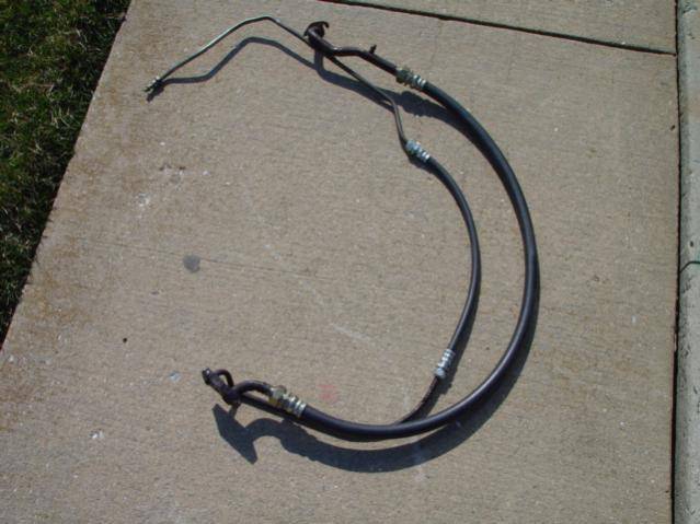

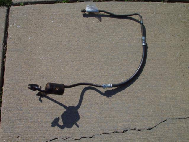

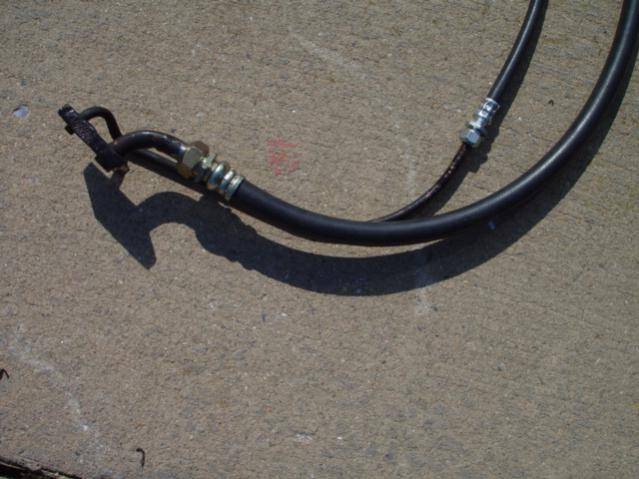

I had my hoses rebuilt and I'm replacing the receiver/dryer, H-Block, and all the seals and gaskets and charging with R134A. I still have some problems with the heater A/C stuff under the dash but hopefully with have it sorted out next month.
Where did you get your hoses rebuilt? I went back to napa and they ended up not being able to do them.... Trying someone else now... I guess clamping onto the existing steel line is a PITA.... Guy doing it is looking for a new block that attaches to the expansion valve.... I bought a $55 kit off ebay and am just going to reseal my RV2.... Holler if you have any problems, I have a diagnostic book when it comes to auto temp systems...
Benz Hydraulics in New Castle, Delaware. They had them done in less than 9 hours. $220.83 total to do both hoses.
