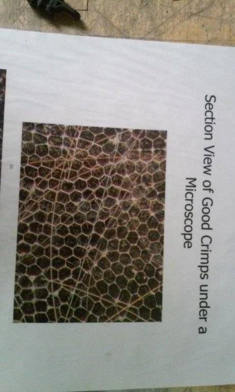

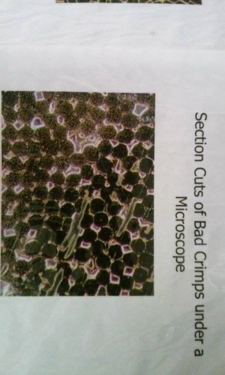

if you have the right crimp thats all you need solding and crimping together will not make a better crimp . please let me explain when you have a copper lug and a good and clean copper wire and when you crimp them together they become one . if you solder and then crimp and the lug heats and cools down the solder could separate the crimp because cools quicker then copper .and if it over heats the solder will run out of the connection and cause a short . i will send a picture of a good and a bad crimp
here you go
Yes, a bad crimp won't have as much cross-sectional contact between strands, resulting in lower surface area in conductive contact. Tinning before crimping helps bind the strands in place, assuring conductive contact between strands and, the inner surface of the lug-sleeve. IFF a joint superheats so badly as to cause loss of solder, you likely should have the circuit broken by overcurrent protection first, eh?
