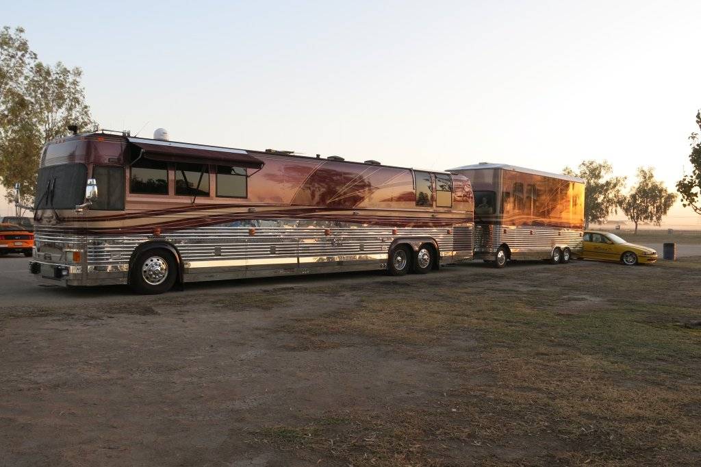

You could build a custom trailer similar to this but with the profile of the scenicruiser to match the bus...

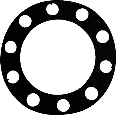

This is what you are looking for.
10 hole plastic spacer, about 1/16" thick.
Any good commercial tire shop will stock them for hub pilot wheels but may have to order them for stud pilot. Amazon might be a source also for easy button shopping.

Accuride PN 5901 for stud piloted wheel plastic spacer. We are a stocking dealer for Alcoa and Accuride. I have never had any luck finding Stud piloted Aluminum "still in production" wheels. To be fair, Alcoa's site is absolutely awful. But, hey if you can find them. Great!
