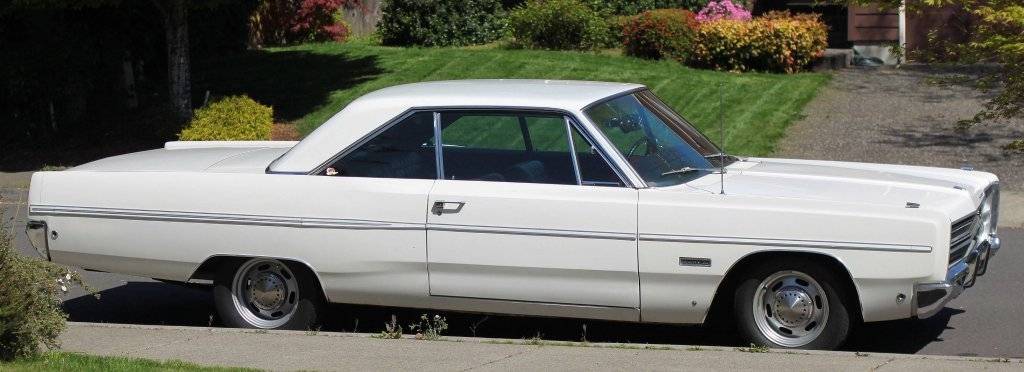

I think the car in the first pic looks pretty good and as said already it's bolt on / off. I doubt a spare hood would cost a fortune.

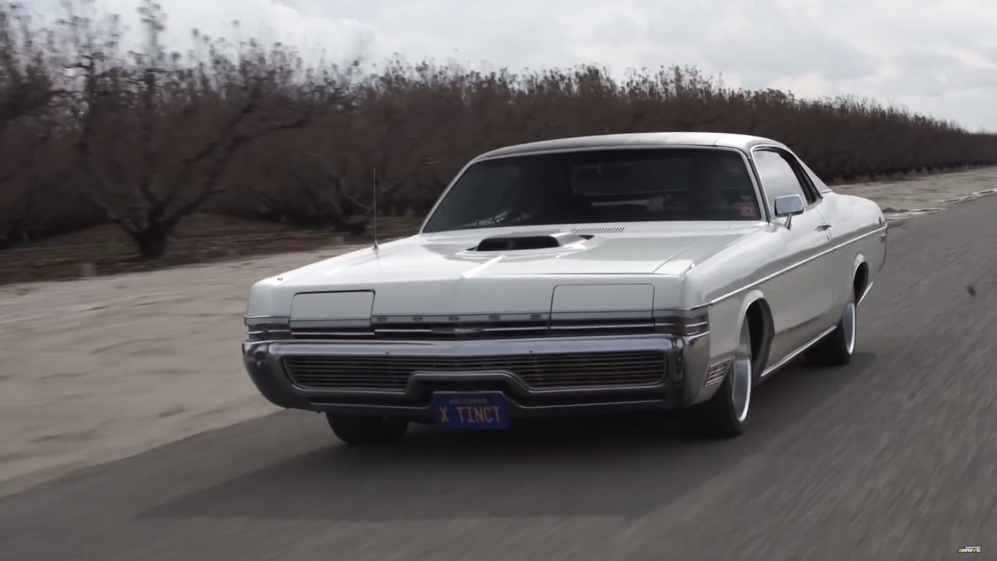

I also recall 72 Monaco that had a shaker grafted in and it's really cool and well done. A 70 or 71 B body air grabber wold also be cool if you can get it to work with the natural lines on the fury hood.

I'll agree to disagree Will :) I can see easily see your point on the 69 6 Pack hood as that's a preference thing but that Monaco shaker looks great ... although a shaker would be a pain in the *** for working on the car.
