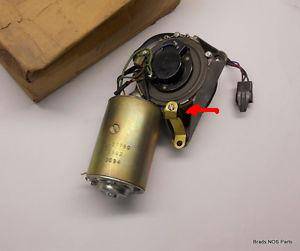

There is also transmission differences depending on if they hide away under the hood or just park at the base of the windshield.Everyone here with wiper problems NEEDS to remember that Chrysler has two distinct wiper motors, the 2 speed, and the 3 speed. the diagnosis for each is the same, but total operation is different

first check the ground strap on the motor. these have a habit of getting corroded, or breaking under the grommet where it bolts to the body.
