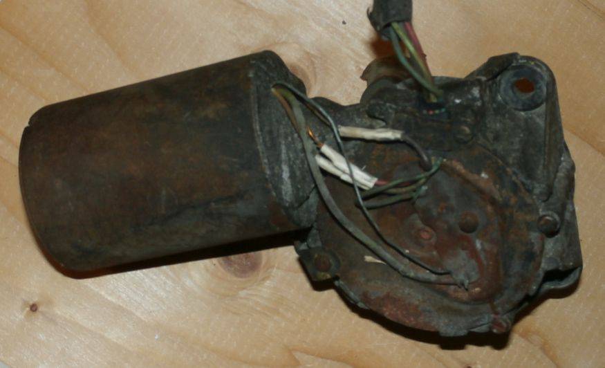

Does anyone have breakdown pics of a 69 3 speed wiper motor.
Mine runs one speed only no matter where switch is. I went into it and taped up all the wires because old insulation was rotted off. I have no park also. The only pics I've found looks like a spring is missing. The arm inside just swings back and forth wherever it wants.

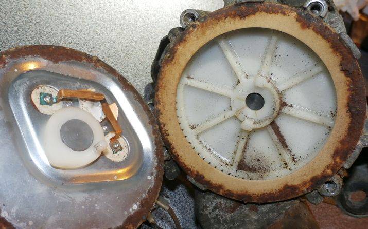

I found one pic online that looks like it has a spring on the gears. The extra parts on the gears just flop around and don't do anything but looks like it should hook to something. I'll keep searching because I know a lot of the 60s wipers looked the same.

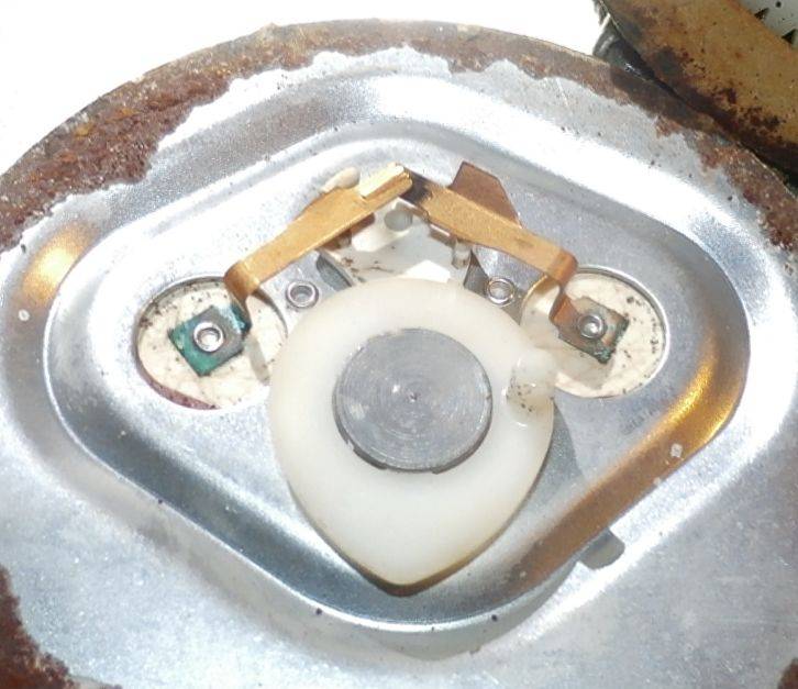

Does yours look like this?
If it does, I can take the cover off and snap some photos. Let me know.
