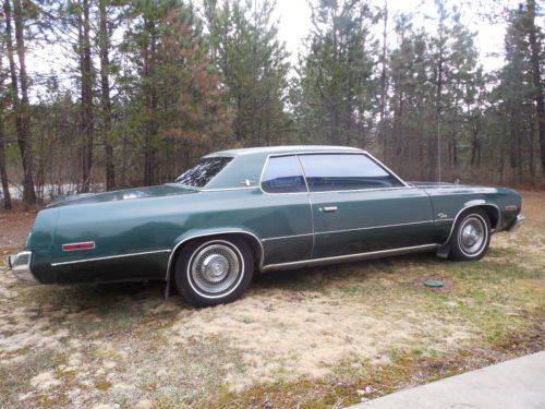

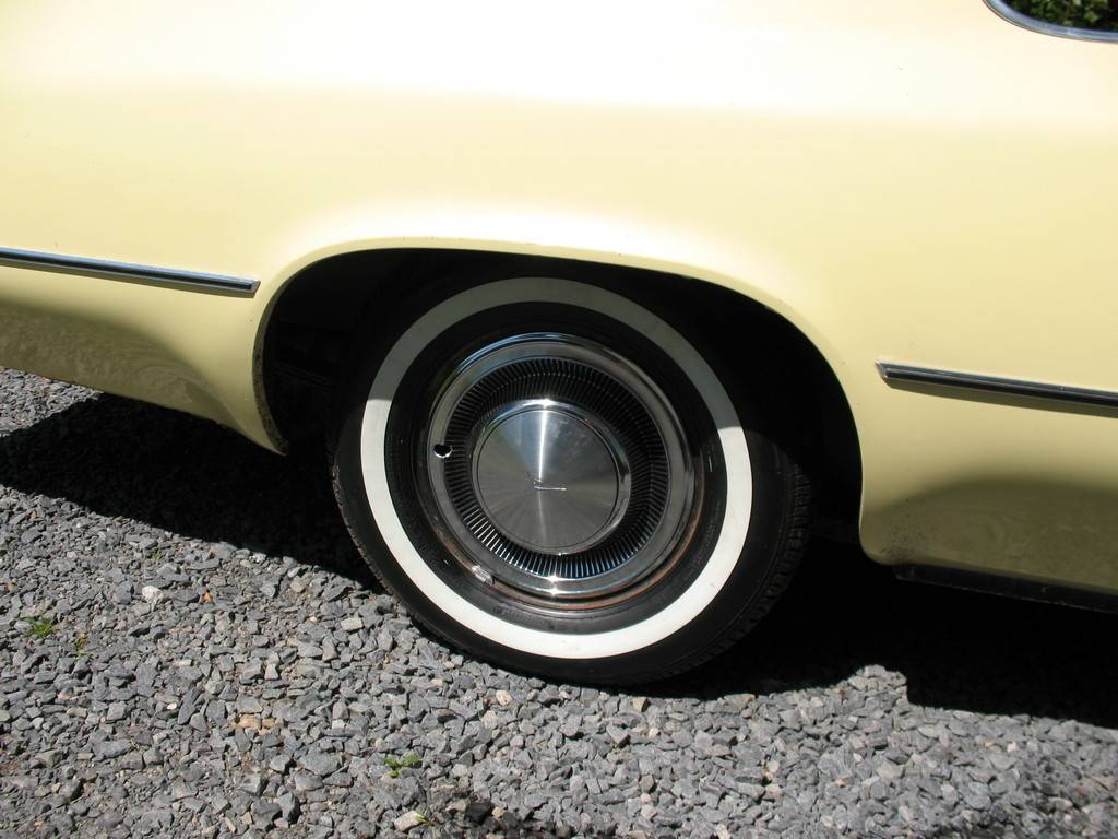

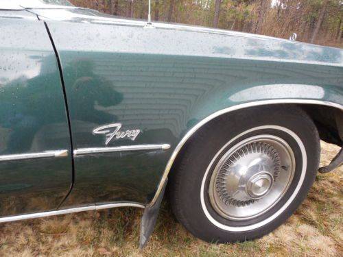

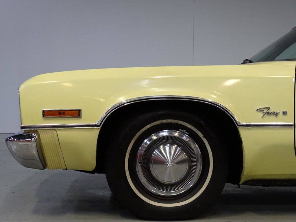

On pics of real-world 1974 Furys you can actually find Gran Coupe/Sedans with an optional 3/4-length side molding:
Problem #1: Seems bright to me, code ???.
Fury III have their full-length standard bright+black side molding, so I don't see how the optional 3/4-length molding could be applied without loosing the Fury-III appearance:
Problem #2: On Fury III fender tags this standard full-length molding is coded V5X, just like the optional 3/4-length molding in the books. They make a difference in the number and position of brackets to be applied to the body, though.
On Fury II there would no conflict, as it already comes standard with a 3/4-length side molding. Only the Fury Differences page lists this standard side molding as "bright".
Judging by the books Fury II could come with either a bright standard 3/4-length side molding or an optional 3/4-length black side molding, code V5X. This is my only example:

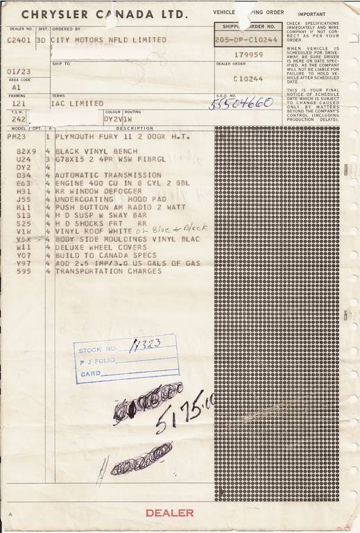

Seems bright+black to me, listed in the shipping order as V5X:
Problem #3: If V5X is the code for the optional molding, what would be the one for the standard Fury II molding?
Theoretically Fury I would pose no problem, but who has ever seen a picture of a Fury I with optional side molding?
To sum it up:
- is it correct that the optional side molding on Gran Coupe/Sedans is only bright? Judging by the example pic it is also somewhat thinner than the bright+black side molding seen on Fury II and III. If it is not a stick-on molding, what would be the code on the fender tag?
- does the Fury II really have two distinct side molding possibilities?
- how come V5X can stand for both full-length and 3/4-length, an essential difference for the building process?
  • STOP right there! That moulding on the green car above is the common add on done by detail and stripe guys from early 70’s to mid 80’s. It is a rivet on track with different inserted end pieces to suit the condition, you can see 3 end types right there. Then a colored vinyl insert is snapped in.
Not factory at all. Anybody over 50 years old that was paying attention saw that side moulding all over.
Plenty of cars were passed over for having that trim down the sides. Plenty of holes to fill when repainting.

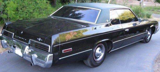

I only have one more pic for 1974 Gran Coupe/Sedan side moldings. This one seems less reliable to me, as the car shows appearance modifications:
Picture of the green car above from a similar angle:
So we don't have any example of the factory optional 3/4-length molding on 1974 Gran Coupe/Sedans?

That Vehicle Shipping Order is from my hometown's Chrysler dealer! City Motors in Corner Brook Newfoundland!
