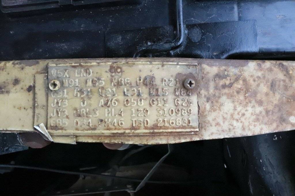

L25 Trunk Light on Furys remains a funny thing: It was a standard feature on PP and PH from 1969 on and all other trim levels with A01 Light Package have it as well.
On fender tags it appears only from 1971 on, however. The earliest tag with L25 I know is from Belvidere: PP23U1D173853, SPD B28. Still without L25 you have PH29G1D133509, SPD A01, for example.
L25 remains a fixture on Belvidere tags until 1975: PP43M5D217433, SPD 425 does not list it anymore. Before that you can find, still with L25, PP29N5D170000, SPD 109. As a feature it is there on the Fury right up until the end in 1977.
This whole obsession with L25 left Newark tags untouched: I didn't see a single Newark fender tag that mentions it.

Frequently occurring codes on 1974 Fury and Monaco fender tags are:
L25 Trunk Compartment Light
L31 Fender-Mounted Turn-Signal Indicators
L81 "Door-Ajar" Indicator
Less frequently you also get:
N88 Automatic Speed Control
For L31 you need holes in the front fenders, L25 may need a bracket. But what about L81 and N88?
L25 only occurs on Belvidere tags. Newark tags do not mention it.

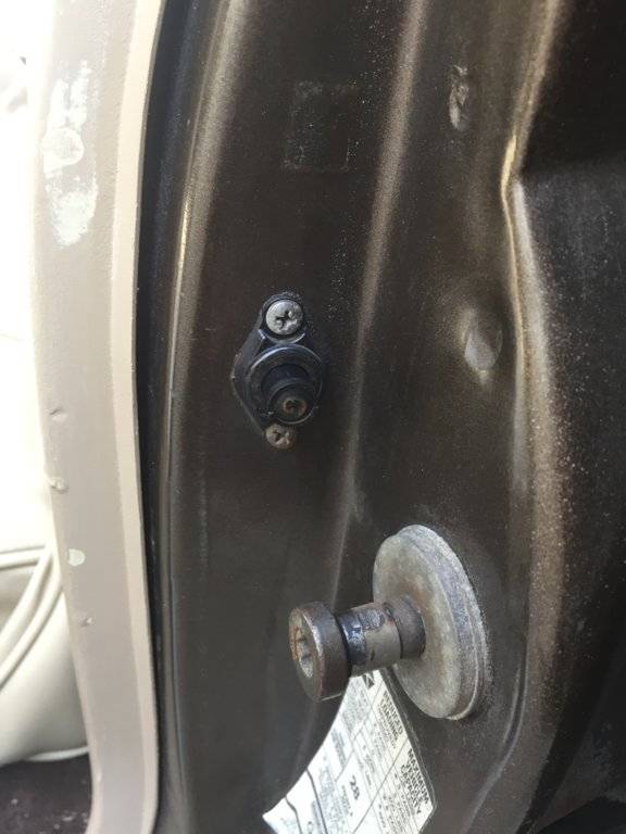

I think the L81 "Door-Ajar" Indicator used a second switch in the door jam (to the rear not the front)

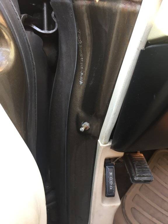

So this black plastic push-button is the sole reason to include L81 on the fender tag?
At the front you have a metal push-button:
Was this metal button already present on pre-1974 models?
Thinking about it, that metal push-button could well be the switch for the courtesy lights. Stupid me!
PS. Just checked that on the car: it's the courtesy light switch.

It uses the same door jamb switches as possible interior courtesy lights as well as those on the door panels, if the car is equipped with them to warn other road users about an open door.

Have you observed the front edge of each door opening?
