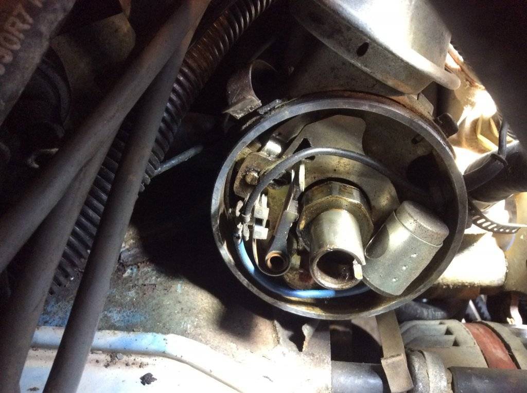

Pics- looks pretty grimey. Probably should have replaced already. I just didn't know wether to go with original or Petronix

Sounds like you have a lot of this already covered and that's good.
Points are probably one of the most high maintenance items on any car from the era. When we had the chance to switch to the electronic ignition, most all of us embraced the new technology.

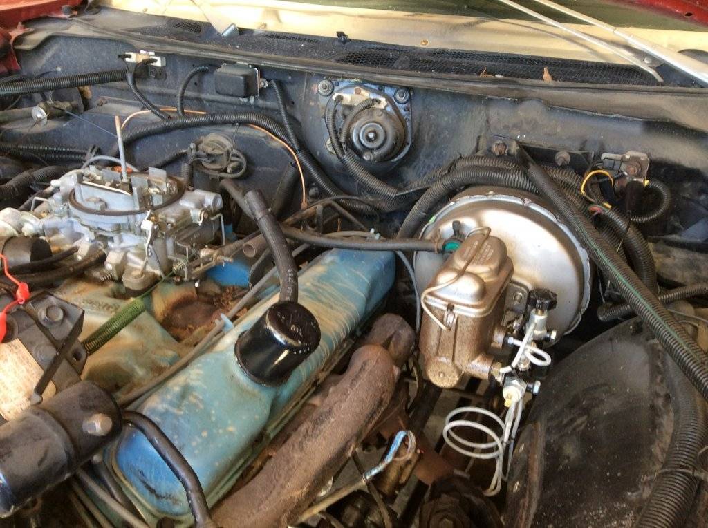

View attachment 94925 Ok so to recap.
The car starts great when cold. Starter will crank and even when I disconnect coil to check starter cables the starter never seemed to slow down or get tired.
When the car is up to temp and I shut it off if I come back to start it it will struggle. The starter will turn at what appears the correct rpm for 1-2 second but then will slow down and become sluggish. There is never any clicking.
Tests that have been run:
Battery - would not hold charge and was < 10v when cranking. It was replaced with a new battery but the problem persisted.
Cables to starter- I did a voltage drop to starter and it was less than .5V. On positive and negative So therefore eliminated bad connection and or cables.
Coil- cranking v to coil ( when car is cool) is around 4V and 9V when car is running. I just pulled off the brown wire on starter switch and turned key to on position ( did not crank)and had 11.3V at coil.Placed brown wire back on starter switch and turned key to on and still had 11.3V at coil when not cranking.
So where do I go from here fellas. I feel like Sherlock Holmes. I attached a pic of the engine bay as I am unsure of single or dual ballast resistor.
If there is any voltage drop greater than .2V, on most electronic circuits that are being tested it usually indicates a defective cable or connection.
