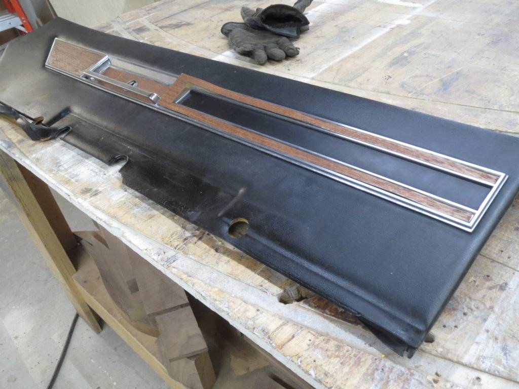

Excuse me if you already mentioned it but did you just do a clean up or actually replace the wood grain? In any case it looks great.After 2 coats of clear, new switches in and all cleaned up. Just one more coat before it goes back in.

I strip and refinish the original.Excuse me if you already mentioned it but did you just do a clean up or actually replace the wood grain? In any case it looks great.

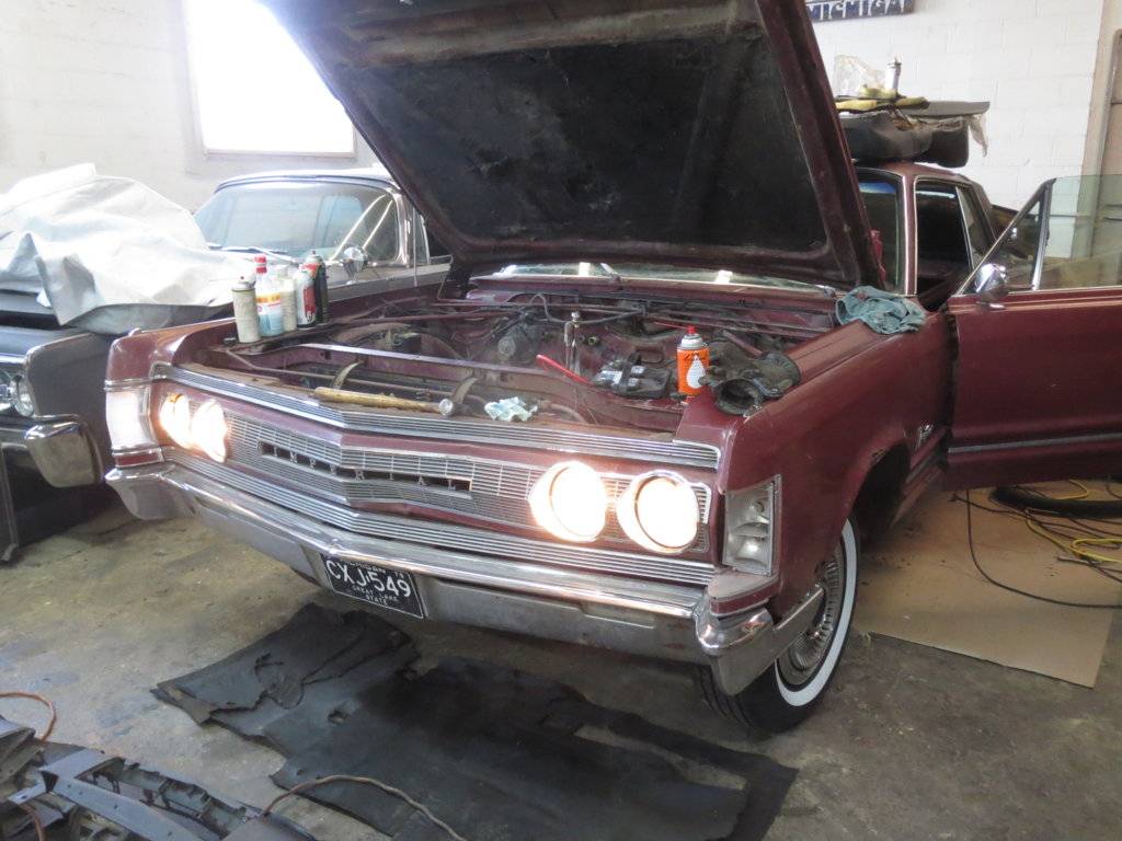

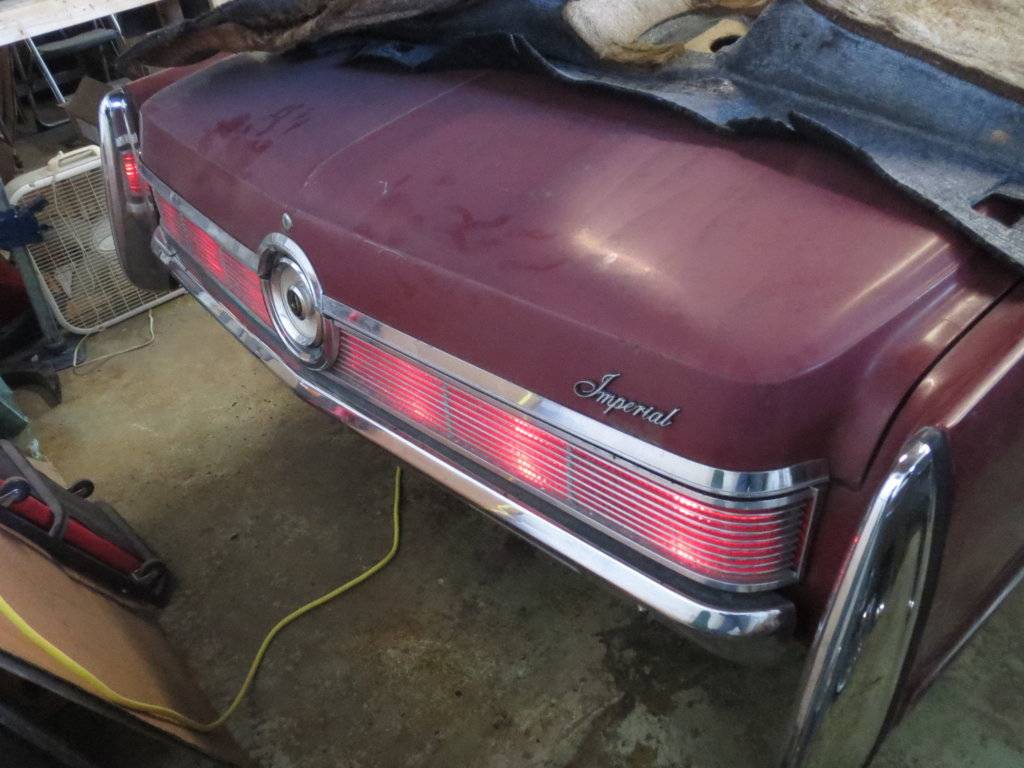

My 68 is without lights...totally dead. Could you PM me and walk me through what you did? I don't want to hijack your thread.Wanted to verify that there wasn’t another reason that I had no headlights or taillights so I plugged in the rebuilt switches and viola!
View attachment 367236 View attachment 367237
This won’t take long or derail the thread Matt. All you need to do is send your headlight and panel dimmer switch to be rebuilt, they’re both shot. That’s why you’ve got nothing. I can just guess that these cars have been sitting with intermittent use at best for so long that the switches get ambient moisture in them causing corrosion to build up and without use to shake that corrosion off and keep clean and functioning. Or the other extreme, like my silver car, they just got plum warn out from 50 years of consistent use.My 68 is without lights...totally dead. Could you PM me and walk me through what you did? I don't want to hijack your thread.

This won’t take long or derail the thread Matt. All you need to do is send your headlight and panel dimmer switch to be rebuilt, there both shot. That’s why you’ve got nothing. I can just guess that these cars have been sitting with intermittent use at best for so long that the switches get ambient moisture in them causing corrosion to build up and without use to shake that corrosion off and keep clean and functioning. Or the other extreme, like my silver car, they just got plum warn out from 50 years of consistent use.
