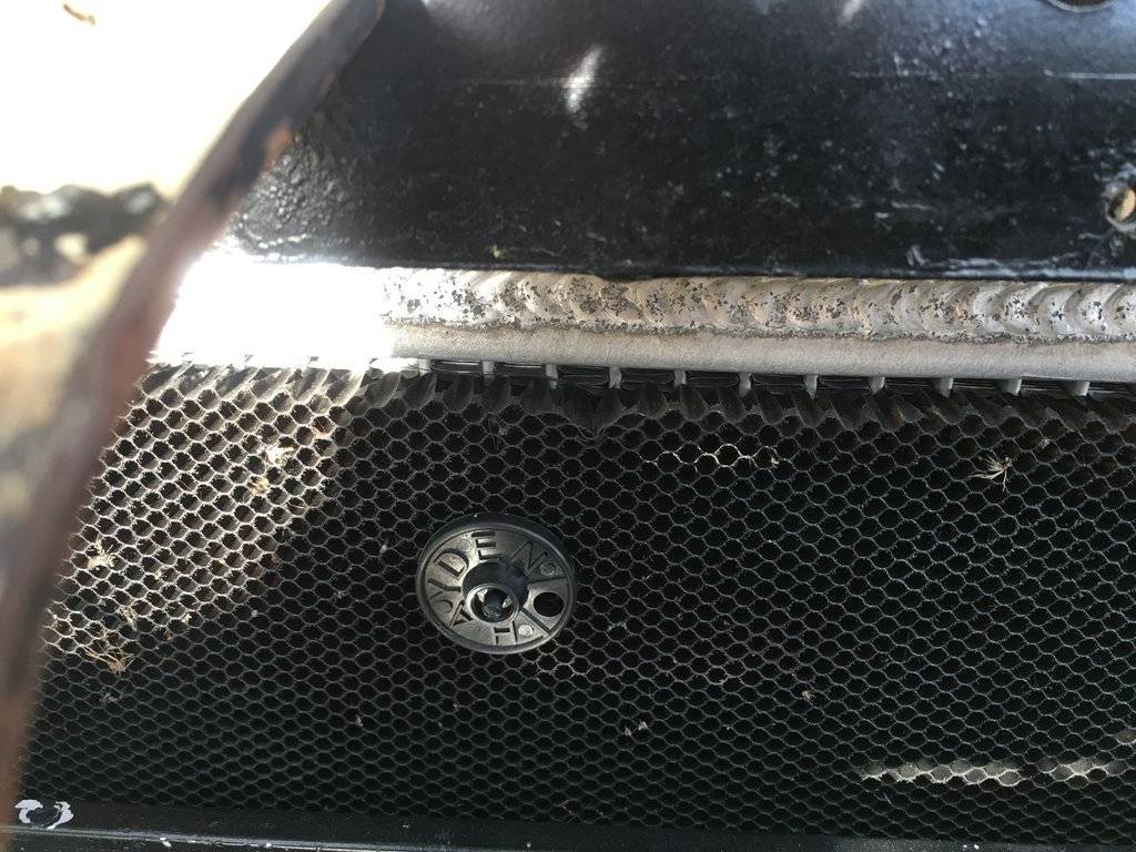

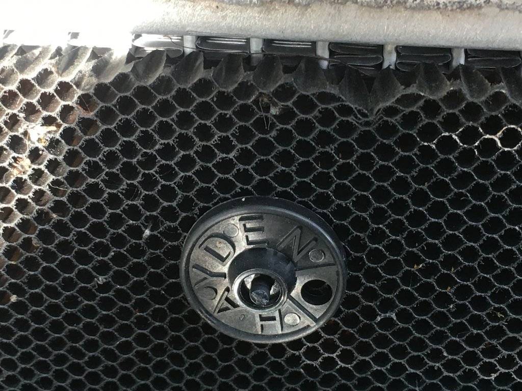

I'll get a pic. Temp gun shows 20 degree drop top to
Bottom. Shroud in excellent shape.
You do not have enough temp ∆. Radiator is either clogged or not enough fins per inch or not enough airflow, or water is moving too fast through radiator.
I'll see what I get today now I've taken that mud guard off. If that doesn't do it then I guess it's time to have a new radiator made.
That has to be a major part of your over heating problem. I have always heard a regular mesh screen on a window in your home restricts 50% of the air flow. That is more obtrusive than that.
Dave has a great tip of a 40 degree drop in the radiator, that is great information in determining if your radiator is cooling properly.
So put something else in front of it to catch them???:realcrazy:
The radiator in my Challenger has mid 50° drop on a 90+ degree day, and I do not think it has a high enough fin count. It is not one of the cheap cores that you can see through, but I think it could be higher.
Well today saw the weather in the low 70's. I never saw engine temp go much over 180 at all today, will know more as the week progresses as it's supposed to get hotter everyday this week.
Obviously that honeycomb thing doesn't dissipate heat very well in addition to blocking flow.
