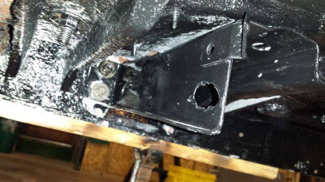

I'm not sure what your plan was or the condition of your rockers but I would take the time to cut away the rockers on these and install them like the factory.
I'd just take a 1/2" drill and drill right through the spot welds on the replacement parts, this will give you a nice place to plug weld when you put them back on.
Removing the old ones is a little more tricky, I'd just cut as much away as I could and grind down the spot welds, you are not trying to save anything here.

The rockers are in real good condition consider ing the connectors were not.
I had cut the old ones away and prepped the rockers ahead of time.
I will do just as you suggest about removing the extra metal ftom the one's you sent me.
Now I can work on getting the stub frame back into the car.
Thanks again!
Tom
Here is a couple of pics with the connectors installed waiting for the stub frame to be installed.
I haven't spot welded them just yet expecting to tweak the position a bit.
